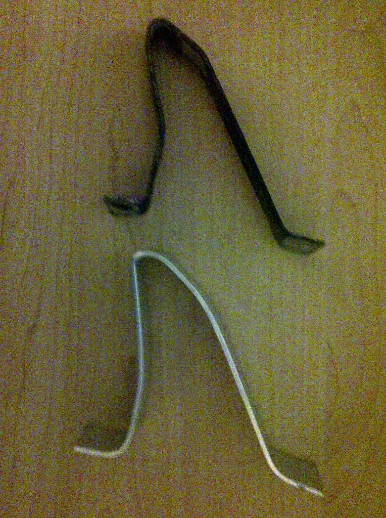

Right, so I bought some 2,5mm aluminium flatbar.
Found out it's too damn tough to bend if you don't have a vice or other appropriate tools.
Tried a thinner and wider 1.5mm flatbar, and that was ok to bend with some pliers.
Had to bend the "feet" the other way, so the bracket can fit on the right.
Managed to make this:
