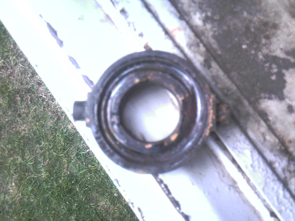

I'm glad to report that we took the engine out,found that the fork wasn't the culprit but the thrust bearing that collapsed.
We got another one but the one problem we had was that the holes for the clips that hold the t/bearing to the fork were too shallow and it had to be drilled deeper.

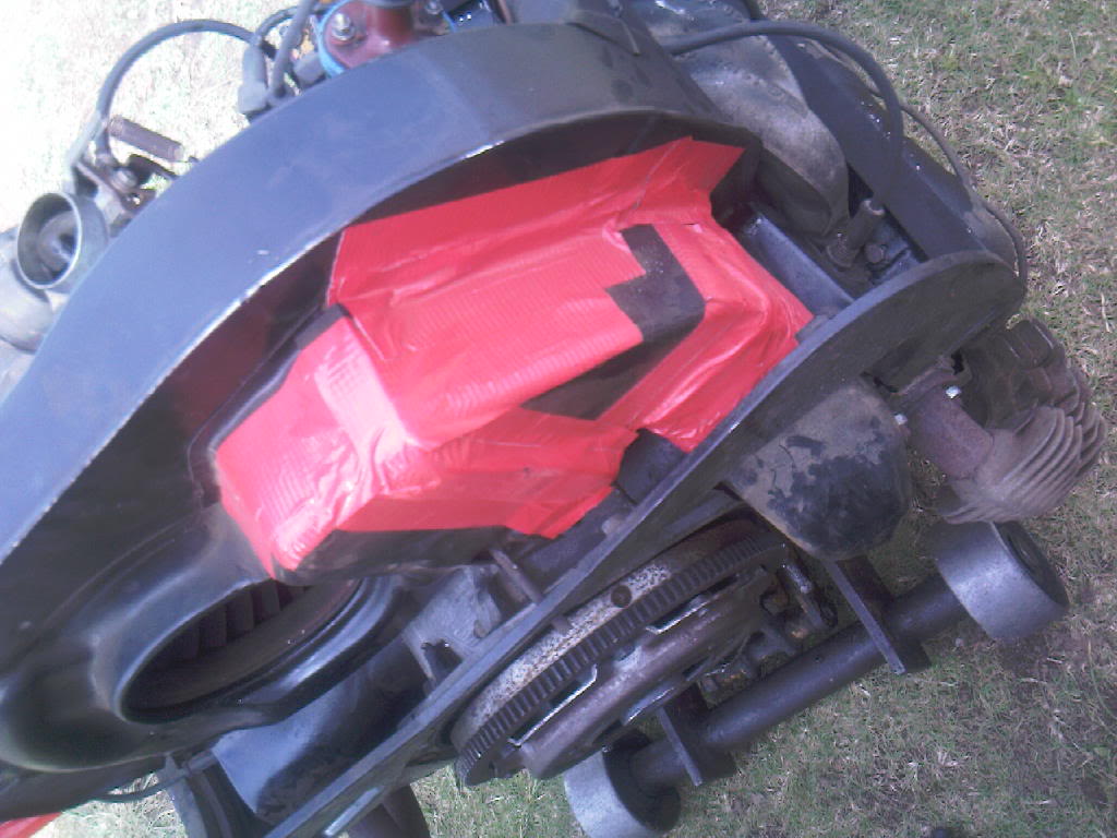

Also found the oil leak and changed the pushrod guide tubes.Everything is back together and running again! :hangloose:
While the engine was out,I took a pic of the oil cooling tin that I sealed with duct tape.I works realy well.
Re: My Lowlight SC
The collapsed thrust bearing
