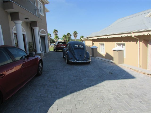

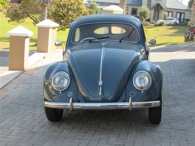

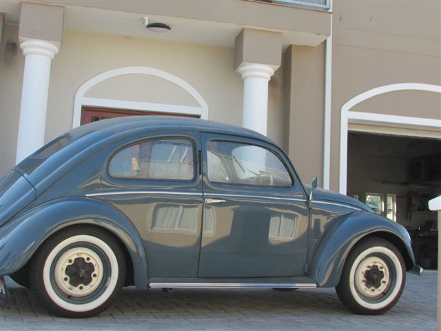

Ok.... so I buckled under the pressure.....
The Beetle has gone on her 1st test run, Not clean, not completed as yet, still have to do a few things to make it ready for her 1st Photo shoot......
But here goes..
Before
After
