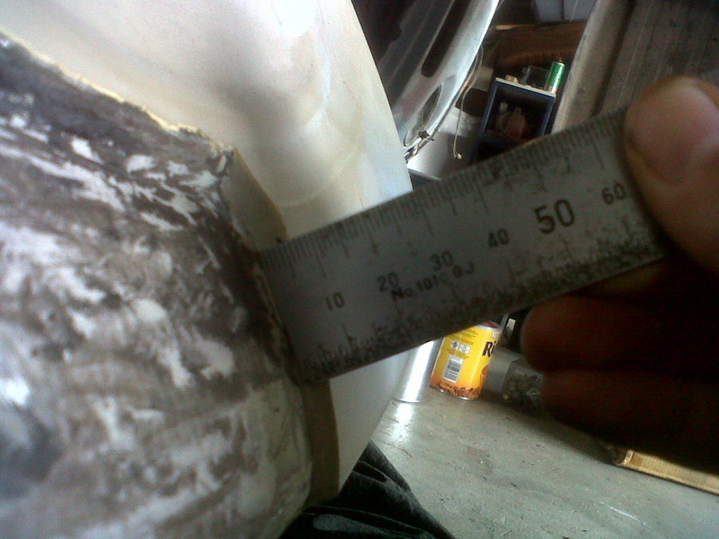

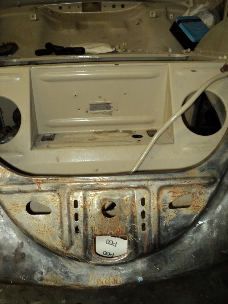

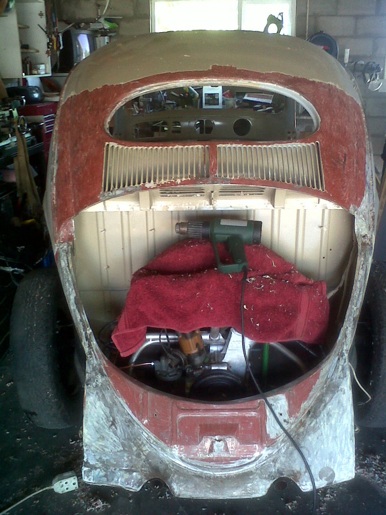

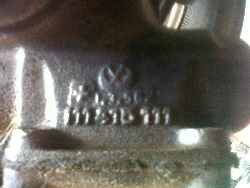

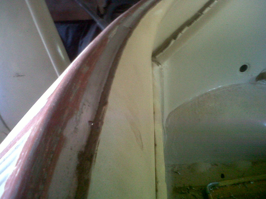

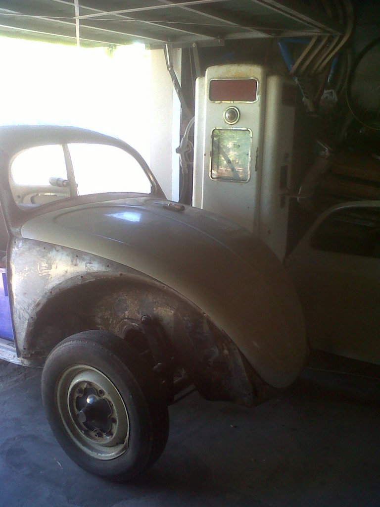

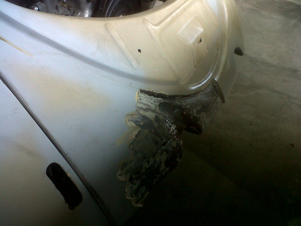

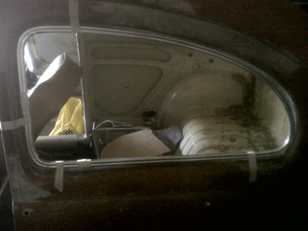

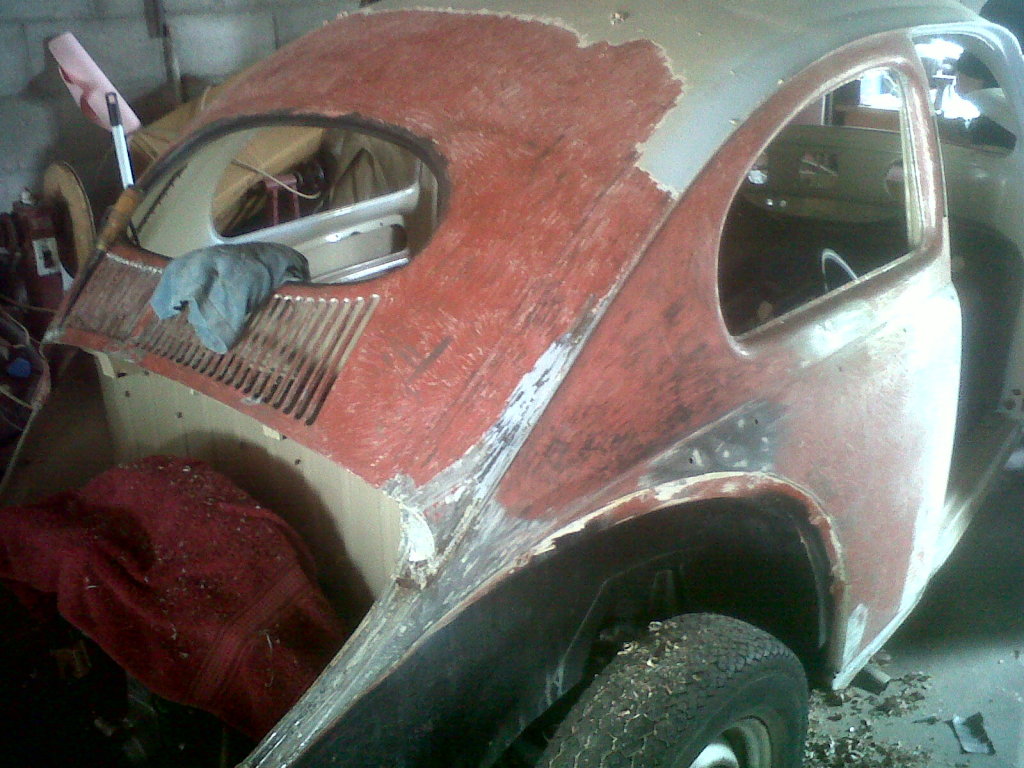

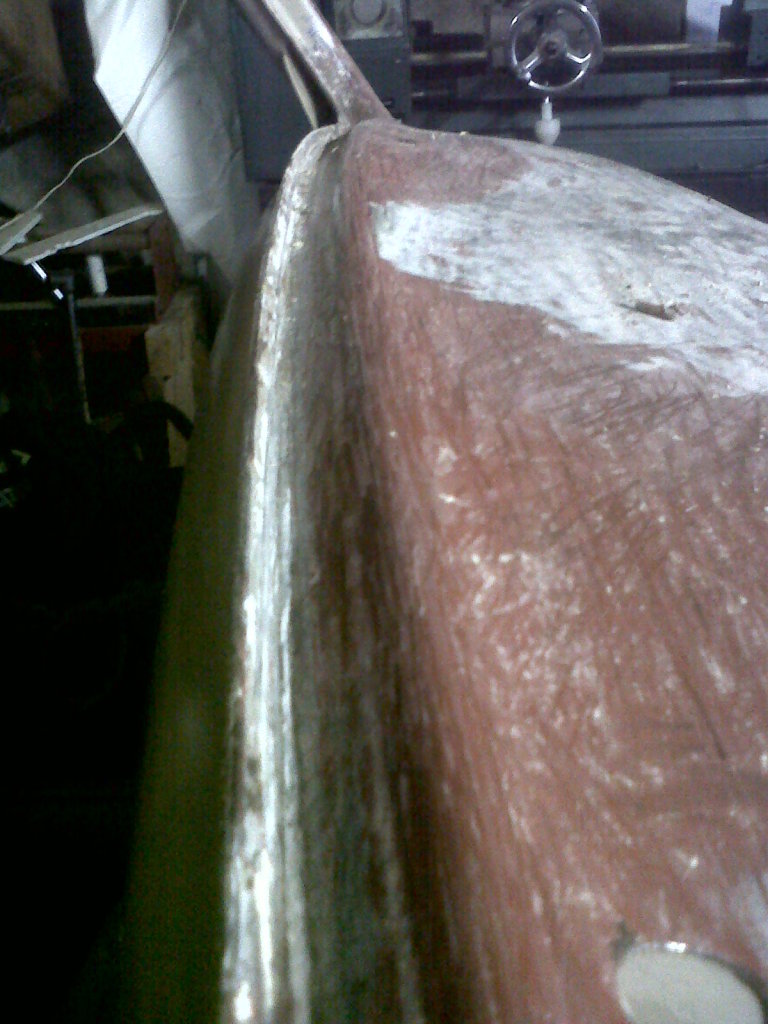

Just for anyone interested in whats happened with Betty.
I started poking around the body and the filler was worrying me. Underneath the putty there are a few spots which is really rotten.
After seeing this I decided to take it all off. I dont want any surprises a year later after it was sprayed.
Had a lekker chat with Bruce the other day at the Oval-Office. Thanks for all the info and showing me all the cool bits and differences.

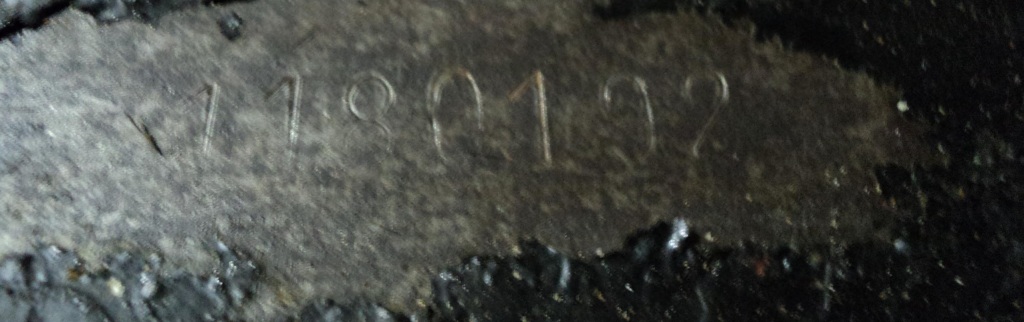

Still trying to establish the year, so far it seems like a 56.
Chassis number is 1180192 - According to theSamba its a May 1956
Date on the steering box is 1.3.56
Unfortunately the date on the back of the speedometer is 59, so no help there.
Bruce also mentioned a number on the beam under the bumpstops, still have to see if anything there. Not sure if its a correct beam.
Already got a few bits from the UK and waiting for the next CPT toybox so Henry can send my Wolfsburg goodies.
Other than that I have just been getting rid of all the filler.
Some pics.
(Mince, if you read this, this is not an instagram photo)
Chassis number
Steering box
Nice clean channels
Reason for taking it all off
Wrong front end, need a four finger one
Stripping
Underside is pretty solid, but the heater channels are long gone.
Stripping

you got losts of work there Splitz.
I think you need to get a large Mollasses tank.

Can't believe all that filler, but at least afterwards you will see what you got.
There is a lot of work ahead. Give it hell.

Checked the numbers and I make it early May 56 since the last number for end April is 1173573.
Engine number should be less than 1443582.
hope this helps.
hope this helps.

I stripped my 58 Ghia myself and decided to save all the putty removed so I could weigh it afterwards.
It weighed 15kg, now its much faster.

I'm doing the same thing, have a bag full already.John Alves wrote:I stripped my 58 Ghia myself and decided to save all the putty removed so I could weigh it afterwards.
But not much left on body

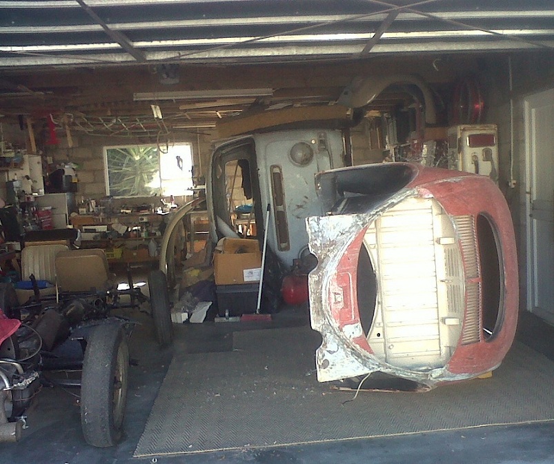

Good going there Donovan, I hardly recognize that garage of yours, serious business going on in there - awesome petrol pump by the way !!!

@HR - Molasses tank to be confirmed
@Jolas - that garage is way messy and due a proper clean up and toss out.
Trying to get rid of all the unused parts to fund the oval.
@Bushpig - engine number is 3273967. Seems like a 59 engine
