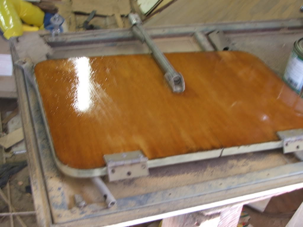

Little table fit in door for stove. Put some varnish on it.

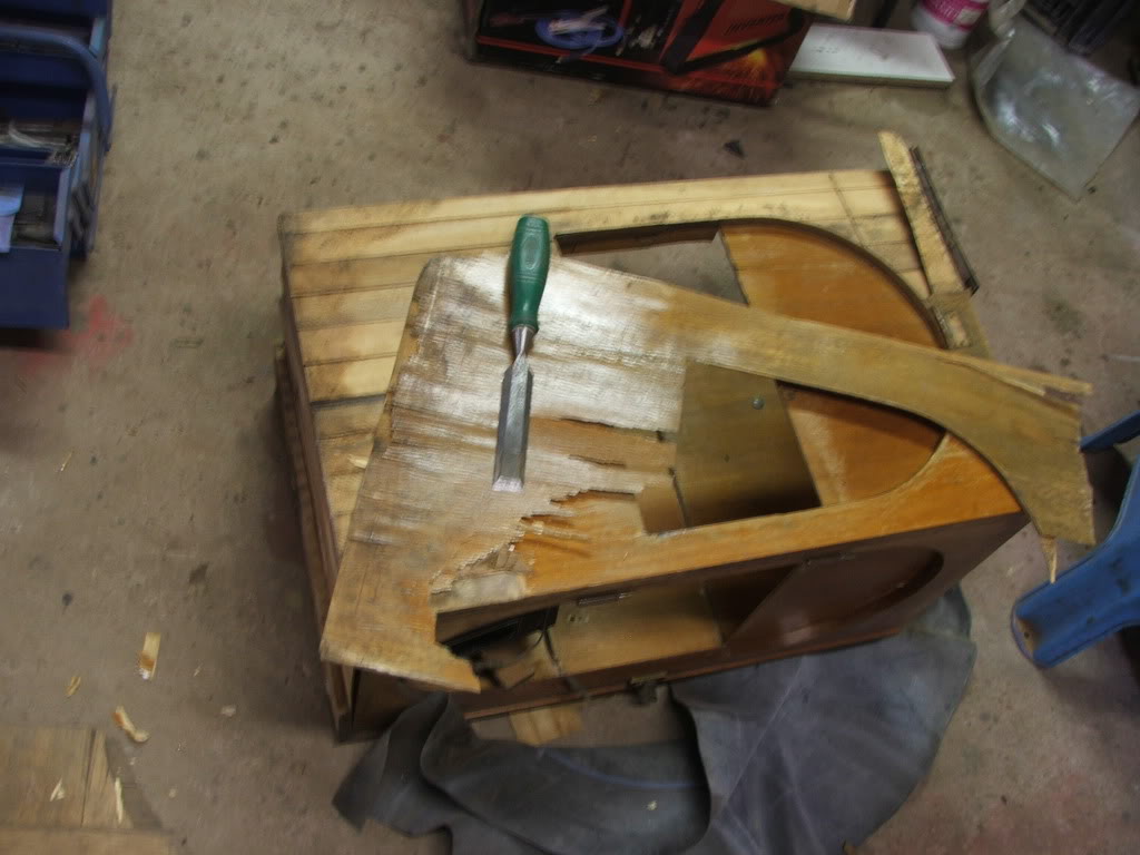

Start on the last cuboard, this one is the worst of the lot
Took off all the plywood and glue the pieces of wood together, and wait. :(
