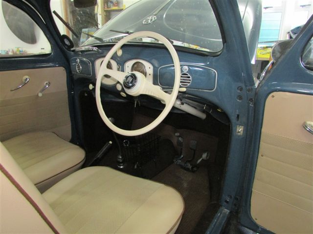

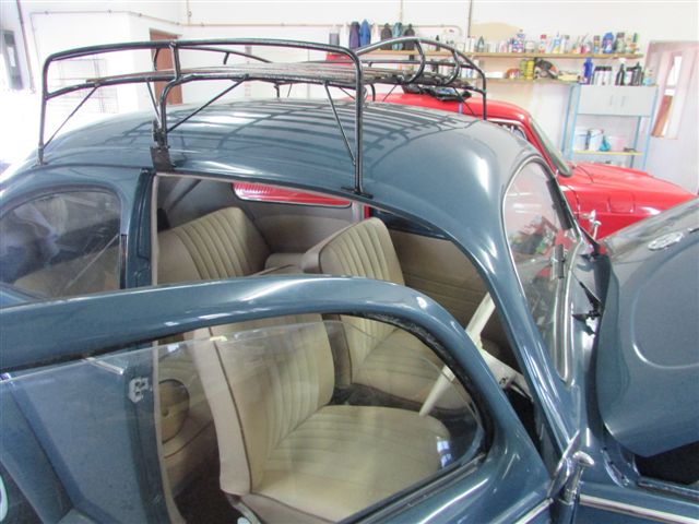

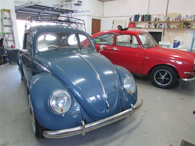

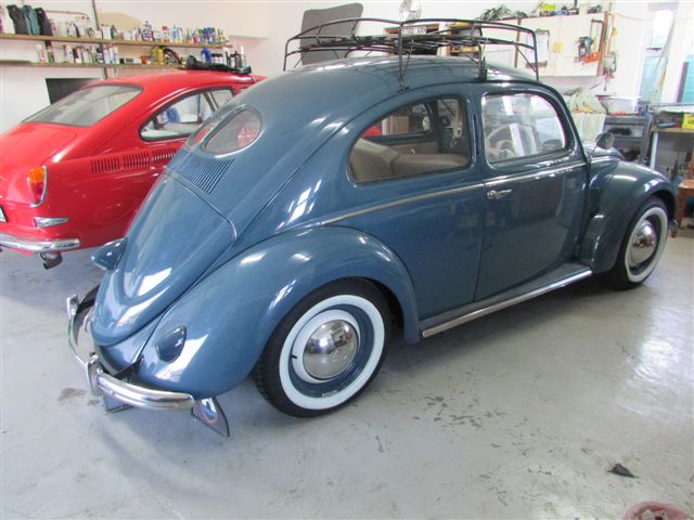

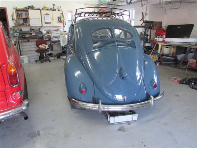

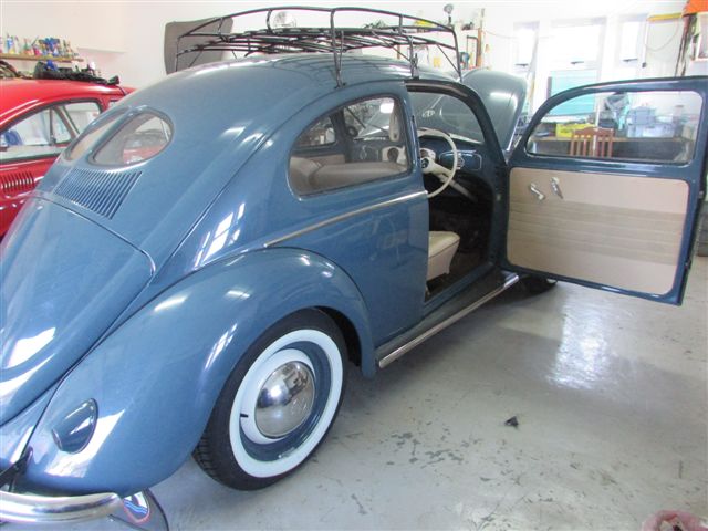

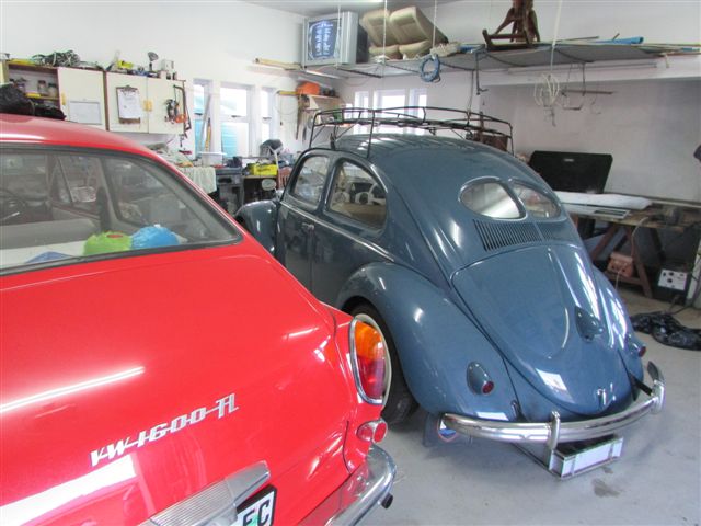

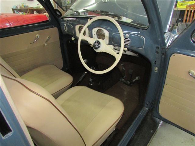

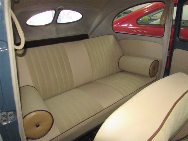

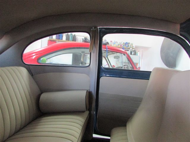

Still not sure about her name.....

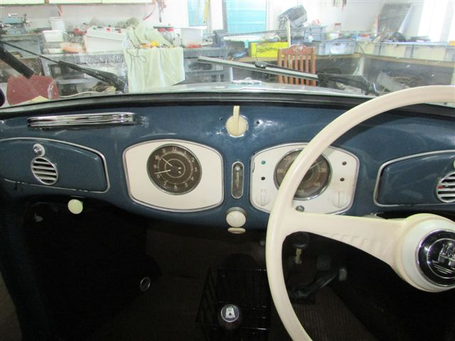

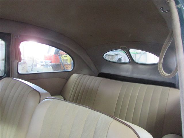

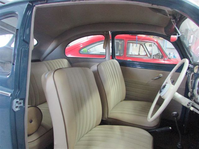

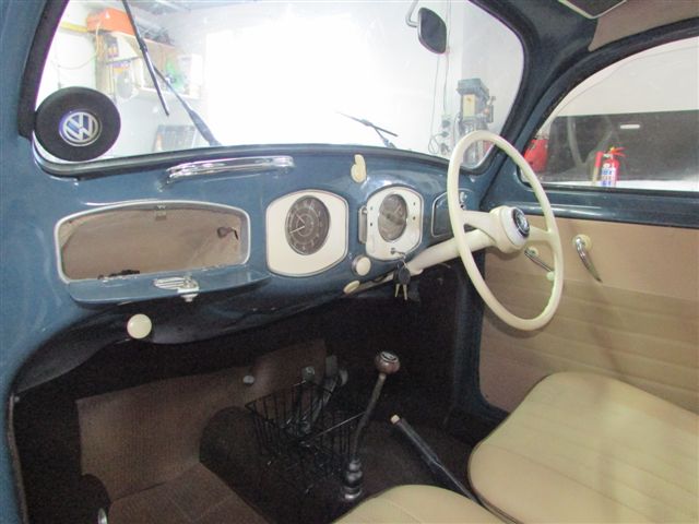

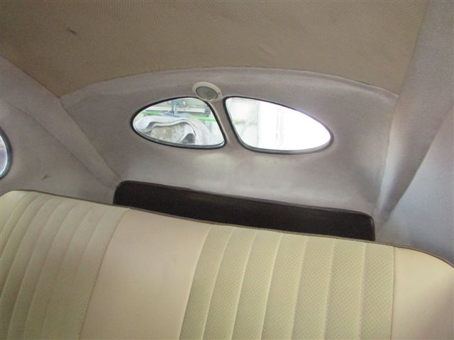

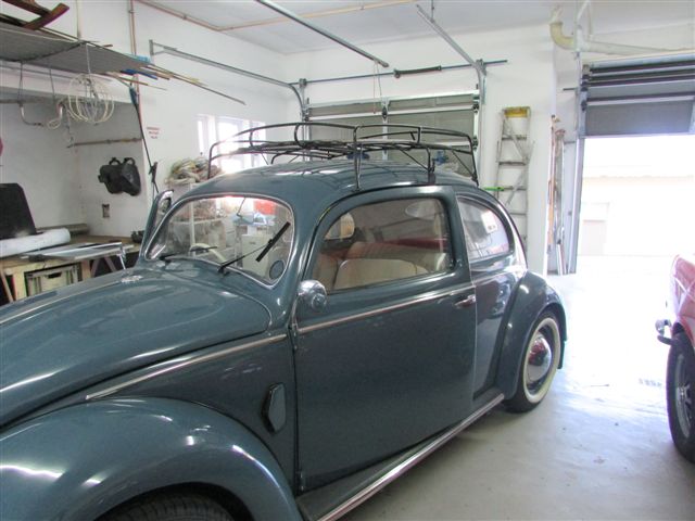

But here are the photo's I promised.
So now we will do the paper works, and get her registered, that may be fun.
Thanks for looking and if you have been following this thread, I hope it has inspired you to take on a difficult Project and to stick with it till the end, as the fun in the work and the final reward is describable,
Please let us share in YOUR project here on the forum.
Till Later.
Till Later.
