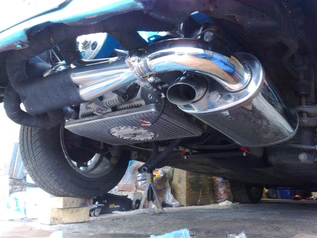

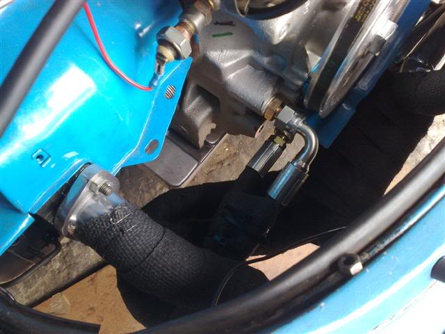

a couple of pics of the oil lines and the eye candy exhaust
Check the finish of the silencer
Audi A8 filter, with oil temp and oil pressure senders installed.
Oil lines leaving and entering the case. Straight shot out at the bottom is the oil leaving the pump on the way to the filter. 90deg bend is the filtered oil going back into the case.

Tony that exhaust looks super cool!
Good luck with finishing this project in the near future. I think it's going to go like hell!

It was great to see the motor in person to..that exhaust looks great!

Awsome Tony,looks great!

also couldnt believe the hardware the silencer was supplied with.... grade 12.9 bolts. I have never seen hardware of that grade before and now it gets supplied with an exhaust....
Yes it is pricey, but I have been putting parts together for this engine since 2001 when I bought the pistons and carbs
