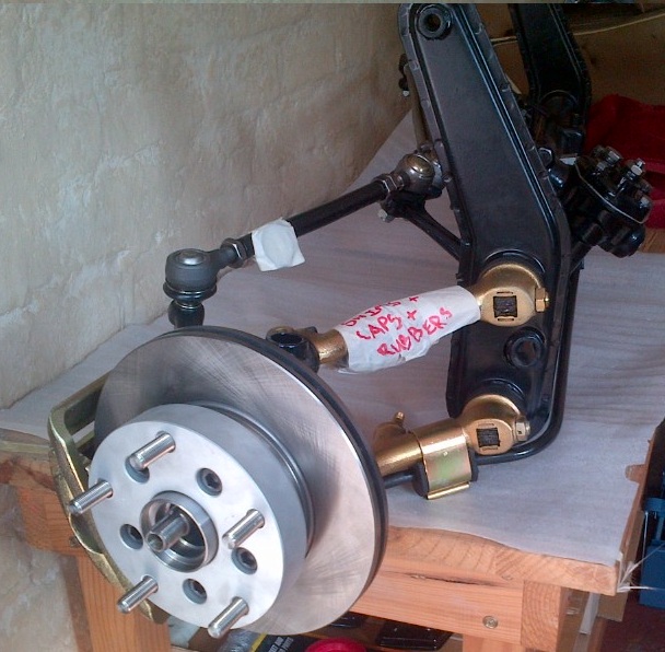

Got a complete brake kit from FFR, front discs and rear drums with 5x130pcd as well as an adjustable beam.

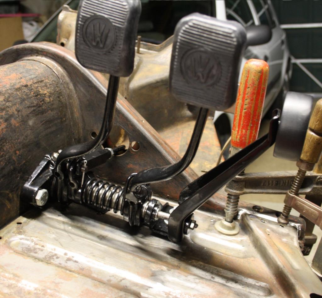

Also cleaned up the pedal assembly. Still need to spot weld the '59 donor pans to the main chassis section. Made sure that the pan, pedals and the pedal bracket underneath the pan lines up.

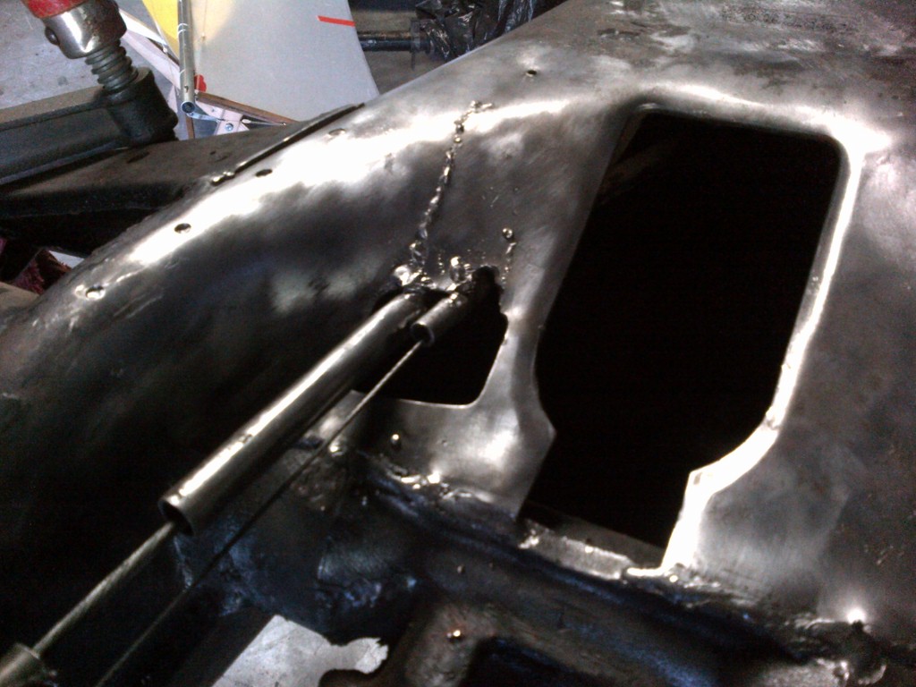

Does anyone have a picture of what the area where the two pipes come out of the tunnel should look like ?
