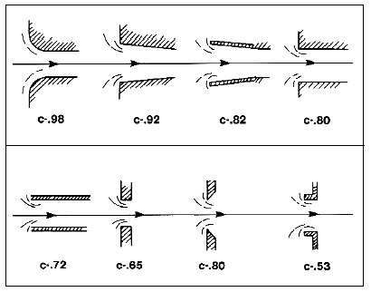

the problem is that your 180 jet wont flow anywhere near a calibrated 180 jet. Jets usually have entry and exit shapes to improve their efficiency.
Look into orifice shapes and efficiencies.
If every jet you intend to use is made the same then it should be OK, but the minute you want to reference to someone else's jetting or buy jets, then you wont be able to go by the ones you made.

Not googling that at workTony Z wrote: Look into orifice shapes and efficiencies.
Ok so if I were to make 4 of these and use them that would be OK but they won't be as efficient as real 180's, or I'd probably need to make them another size to equal out the differences between them and the real 180's.
So how does resizing/drilling jets work ? Does that not interfere with the entry and exit points of the jet or would you not drill that big to interfere with it?
- Posts: 15010
As long as you keep yours the same then they will work together.Donovan D wrote:
resizing jets does work because the shape of the entry/exit is a fair bit larger than the jet. But still, a new or original size is better than a reamed jet. Once again, use 4 resized/reamed jets as a set instead of 2 originals and 2 reamed.

Totally agree with Tony.
To help you get closer to std jets, have a look at the original ones in your carb.
you will notice a chamfer on the entry and normally a tapper to the back (outlet side)
If you copy this profile you will have a better performing jet and the atomisation will be more to the carb spec.
If you make all your jets in the same way, there ratios will be as per original, even if the volume is not.
So that means your mixture will be correct.

Lastly I see that a lot of people do say that the numbers on the jet are not actual drill size in mm but stamped according to flow rate. I don't have the gauges to check this, would this be true on all carb makes ?
- Posts: 15010
I stand under correction here, but I think the jet size, 180 for example is based upon a "perfect" orifice with a nominal size of 180. That is a 1.8mm hole with no losses at entry, exit or in the tube itself.
You use the jet gauge to figure out what size it is - 1.8mm is 1.8mm
When drilling a jet you get small losses - so for example, drilling a 170 to a 180 you will end up with a 180 hole but it might flow closer to a 178. So in this case its a 180 jet when you measure it but it flows as if it were a 178. Thus stamping it 180 wont be accurate because it measure 180 but it doesnt flow 180 - if you get my meaning.
Your 180's will probably flow somewhere between a 140 and a 160 at a guess.
And one more thing... drills very seldomly run properly true. Thats why you need to ream your jets. But who has money for 30 different reamers? If I broke one of my jet drills, I wouldnt even consider sharpening it and reusing it as a jet drill, it would go straight into my general drill sets and I'd buy a replacement to keep it as close as I can to accurate.
