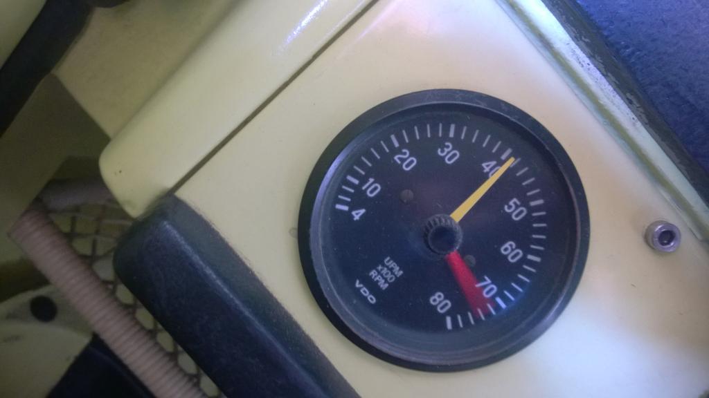

Look what the Thing's rev counter can now do. The needle goes to 8k no problem.
This is an stock 1.6 motor with only fuel injection and Spitronic management system fitted.
Of course this was before I configured the managements rev output to be 4 cylinders.

That's a cool trick. Do you need ear protection when the revs are that high?
- Posts: 15010
Re: My 181 - Kubel - Trekker - Thing
Running wasted spark Tom??? It would have been quicker to flip the switch on your rev counter to 8cyl... Might have worked.

@Tony. You simply set the rev pulse output, through a drop menu, to what ever you like. Everything in this setup is soft and you set it up how you want it to behave. To dismantle the dash would have been a shlep. You cant access the back of the gauges through the bonnet. The dash flips forward and closing it again is the problem. Lots of wires ( as the fuse box sits on the same panel) a hazard switch , a lights switch, and a rev counter needs to fit in a very small place.

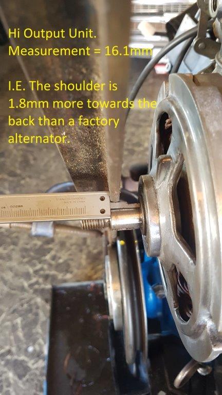

Need a some Advice:
I'm trying to fit my Hi Output Alternator again.
The last time I had it running the shoulder on the shaft chewed a recess into the aftermarket chrome pulley and it ended with the pulley severing the arms that support the alternator bearing.

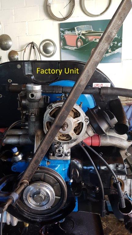

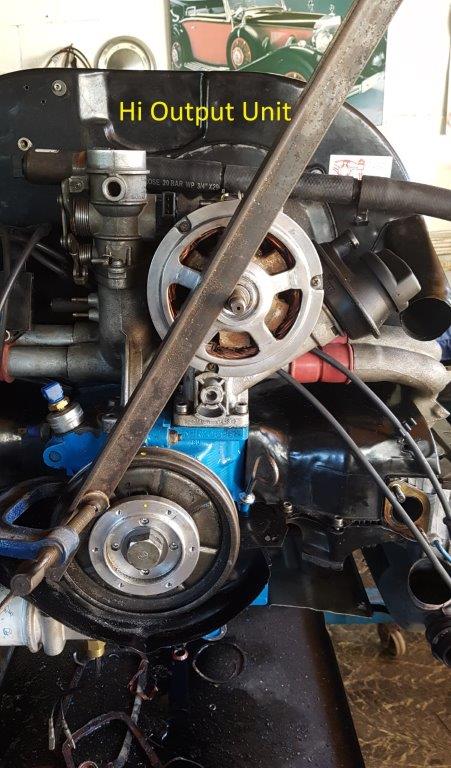

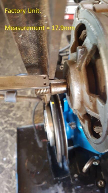

The arms were fixed and this time I’m taking measurements. From the attached pics you can see there is nearly a difference of 2mm between the two shafts.
Could this be the reason that the shaft ate into the pulley or was the aftermarket pulley inferior and the 2mm is ok? I will be running the factory alternator pulley this time.

after market pulley are junk
Better try to find a OE pulleys from someone here on the forum

Many, many moons ago i bought an aftermarket type 1 alt pulley, (it looked nice). Soon realised that it was a misfit... too much clearance/slightly loose on the shaft, wrong dimensions, etc. So i bought a used one instead, and chucked away the unusable aftermarket one.

There is one aftermarket pulley which I use which IMO is the best pulley that can be bought for the std V-belt style. But thats another topic.
Tom, I think you need crank gear spacers, they are around 2mm thick and slip onto the crank before you put on the pulley. This will move the crank pulley back 2mm and give you back your 18mm gap that you have on the std alternator.

That pulley is 95% of the problem. Throw it away. I have had the exact same experiences as yours here and it was all because of new pulleys. Find an original one and your problem will be solved.
@ Tony, where do you get this quality item you speak of? I need some.
Here are some pics of original ones. Take note of the centre base.
Here are some Chinese numbers, all different but have had exactly the same problem (at the same time destroying an alternator bearing carrier.)
Look at their center base. They seem to have this slight recess but this allows the pulley to now sit closer to the housing. Within a period of days, the alternator shafts actually manages to compress that pulley and it moves in damaging the housing. Take a special look at the chrome one below. That lasted 2 months. It first started grinding into the alternator housing after 1 month, so I added a collar/spacer behind the pulley to space it further away, 1 month later and that collar just pushed in another few mm causing the same problem again, almost as if the pulley is made from a very soft material....
