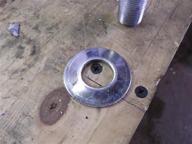

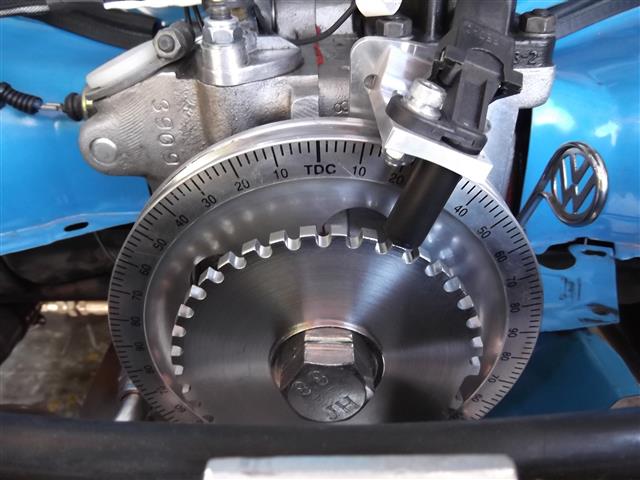

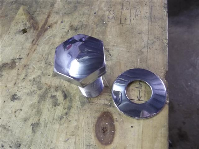

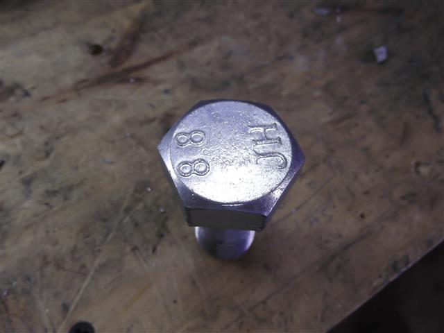

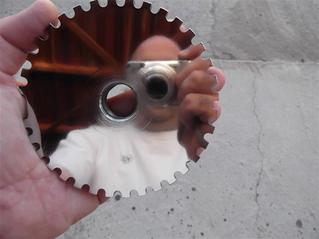

Have not had much time lately to work on the bug. Small building project at home is taking much longer than anticipated. Problem is that I dont want the builders looking into my garage in case they take a liking to my tools and parts.... so some days I only get in 5 minutes, other days I get an hour. But nothing of any major consequence.
I am thinking that I am understanding why this project seems to take so long. I'll do something and then not be entirely happy with it, so I'll spend time making it the way I'd like it.
My new timing gear is a prime example.
Here you can see it installed about a week ago
And here is the bolt and washer
So after installing this lot, I decided that it would be nicer if I polished them.... so I went about polishing them
Sometimes I made good progress, other times I didnt, yesterday for example, I got to work for 2min before I had to stop
So about a week later, this is the result
Once again, this is one of those things that really isnt necessary and no-one would think otherwise if it wasnt polished. But I did it for me as one of those touches that someone might see or might not. I see it and thats what counts....

Have you still got the Gotech ecu on the engine? If so they are full of shit with magnetic sensors... you might have to end off with a air gap of 0.3mm or less in order for the ecu to pick up. I am using the same trigger wheel from CB, but with a BMW hall effect sensor.
VW Beetle 1303 - 2165cc Turbo
VW Beetle 1971 2332cc
VW Beetle 1969 - 2666cc Turbo
VW Beetle 1974 - 1600
- Posts: 15008
I actually pulled out the Gotech for the CB crank trigger kit, its currently sitting in a box in my cupboard
I initially wanted to install the different wheel purely so that I can change pulleys - as you know, the other wheel was bolted to the pulley. Then i decided to add a vacuum signal to the system, so got the CB kit for that too as it was easiest.
Then I changed my mind and decided to do the whole CB system so I can tune from my laptop and not solely from a PC - 3 serial to USB cables later and I still cant connect an XP laptop to the Gotech ECU.
I'll give you feedback as it goes. I find the dashboard easier to use, but they dont have a fuel pump OFF function which doent override the ON function. I'll be fitting another relay to the oil pressure light for this...
