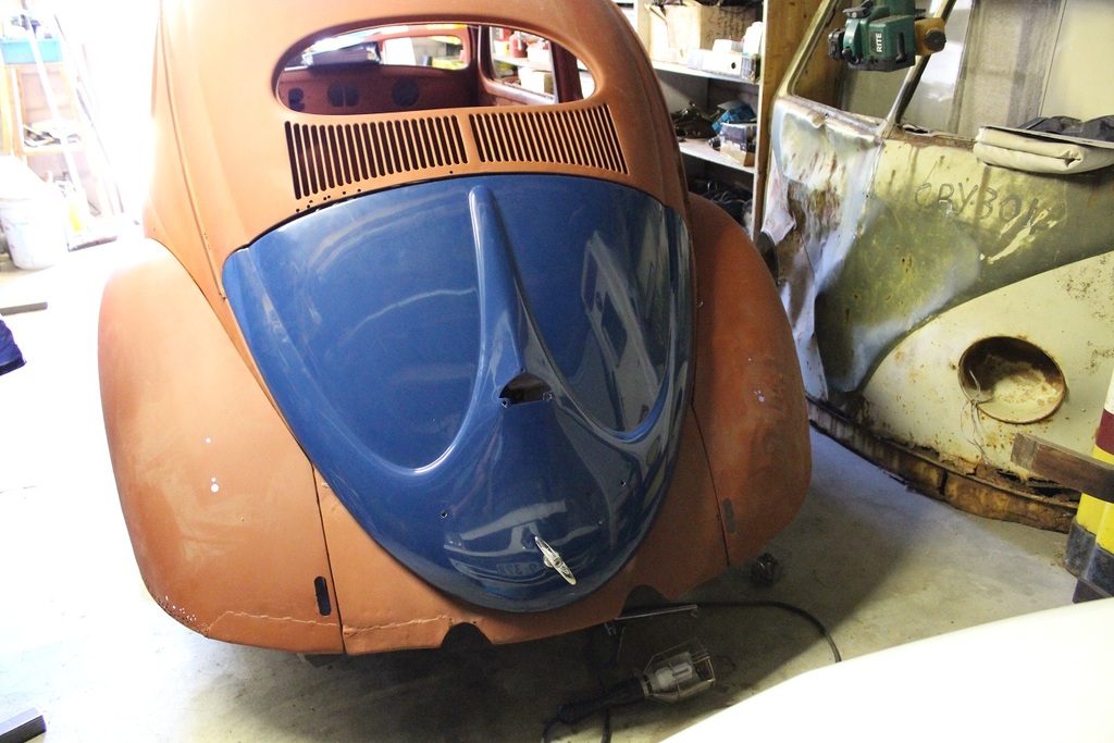

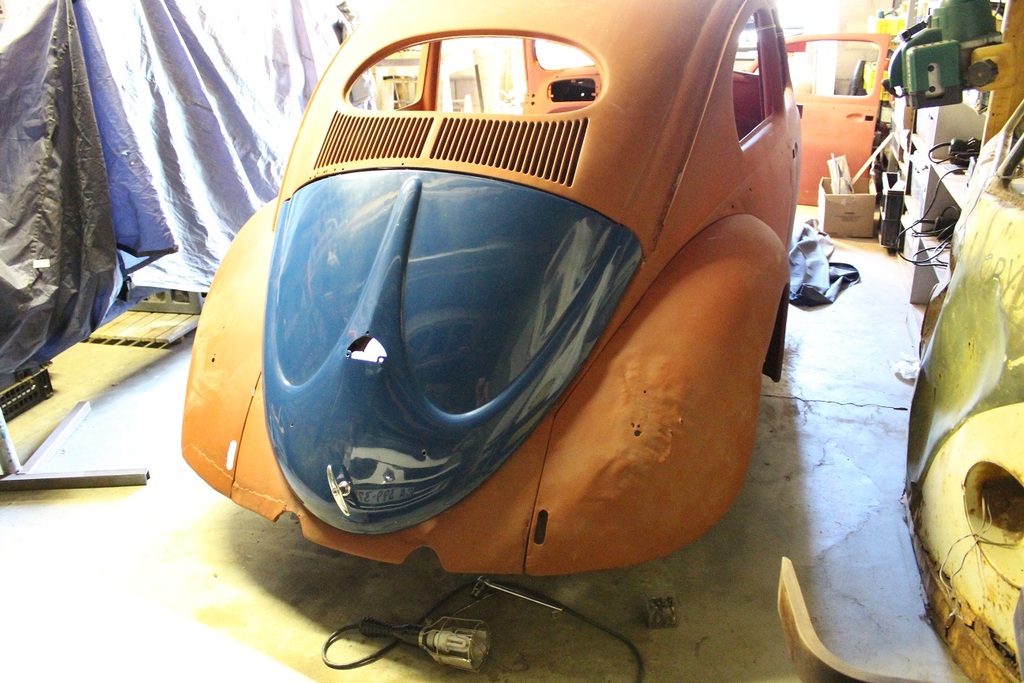

The rear of the oval needs a lot of work which I will hopefully be tackling within the next few days.
I bolted on the fenders and decklid just to see how everything lines up before removing the rear valance and fixing the surrounding areas. The way it is now was covered by putty so I still need to fix all of this. Seems that it had a rear smash sometime during its life.

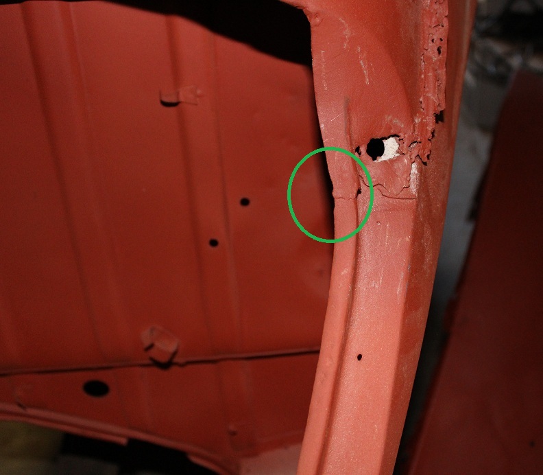

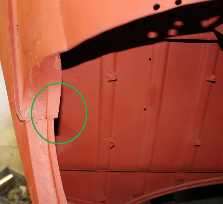

I also noticed that at the top area where the decklid sits is a lip on the one side but not the other side.
It does not seem that these areas had work done, should there be a lip or should it be flush ? Could be that the one without the lip might have been cut off. Still so much work ahead

"I also noticed that at the top area where the decklid sits is a lip on the one side but not the other side.
It does not seem that these areas had work done, should there be a lip or should it be flush?"
It should have a lip.
