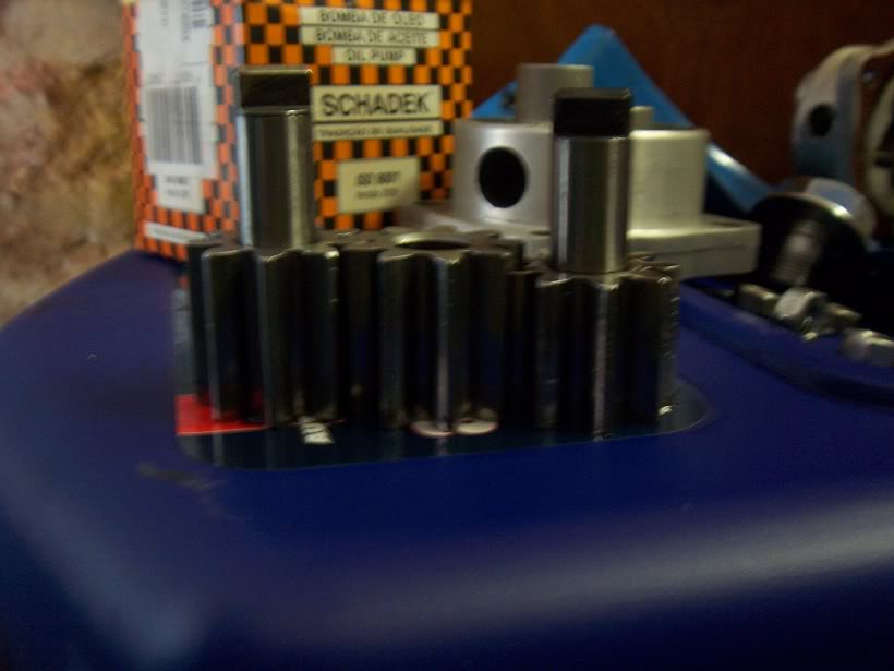

For those who are interested... this is how a oil pump differs in size.... the gears are longer.
On left the gears are 30mm, on right, they are 26mm

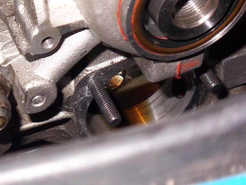

And if anyone ever wondered where the oil level sits in the sump and how long it takes for the oil pump to get suction.... here is your answer
