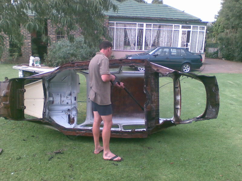

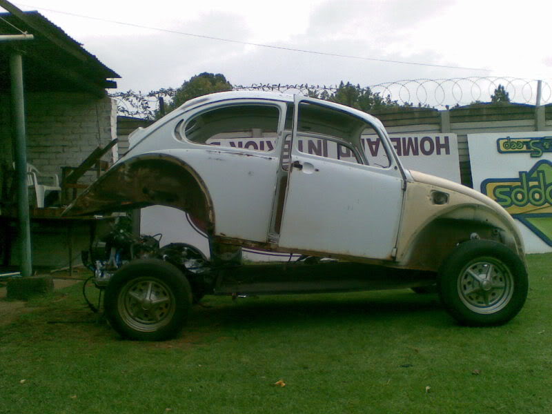

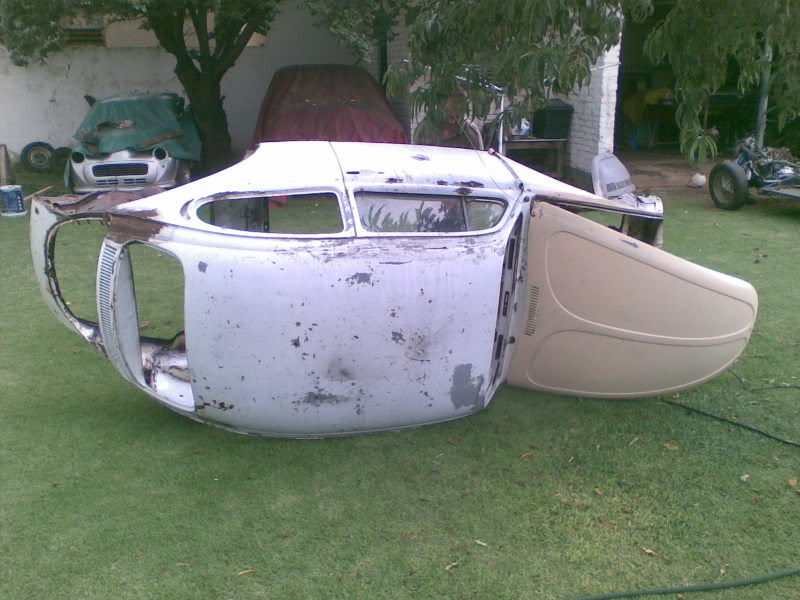

The body was put back on the chassis today so we could do all the cutting for the Rad and the fuel rails. Everything fits like a glove now. The one waterpipe will have to be modified, but thats about it. Here is some updated pics..One hell of a way to wash a beetle.. :mrgreen:

nice...looks like you got some work to do on that body?

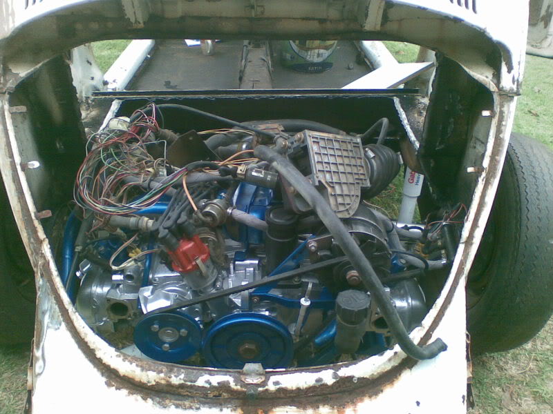

Here is some updated pics. We are trying to find the right way of putting the rad. The rad we are using is from a Jetta2 with 2 12" fans..
