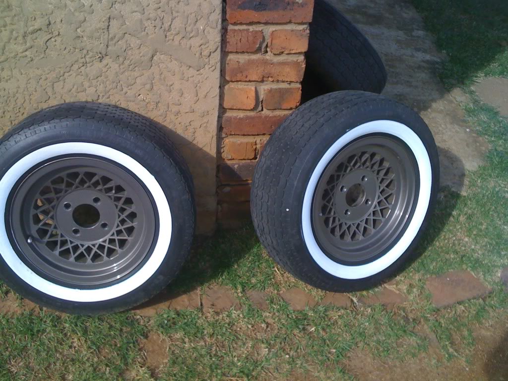

Hi, i`m just a new member, i been here few times reading about whitewalls, every one got a different opinion about how to get it right, i got them on my VW, they last and last, after long time, still snow white. my advise to any one that whant the real thing check this site.

Whitewall, do you have some pictures of whitewalls you have done? The pics on your website dont reflect your actual work or is that your 14inch VW wheel with white walls?whitewall wrote:Hi, i`m just a new member, i been here few times reading about whitewalls, every one got a different opinion about how to get it right, i got them on my VW, they last and last, after long time, still snow white. my advise to any one that whant the real thing check this site.

Hi, all was done by me, those that you asking, are from a client in JHB, as well the PASSAT ones. I will post a pic, when i learn too.

HI you can get white wall any size, longs your tires allow space to make the white walls, same tires have so much righting on them, that is no space, what i use do, just clean the area whereBlitzkrieg wrote:I've seen an insert with a thin red stripe. Anyone knows where I can get from?
the white wall to be painted. All members are welcome to pm.
live is shot enjoy the ride. http://i1022.photobucket.com/albums/af3 ... G_0394.jpg
http://i1022.photobucket.com/albums/af3 ... 009148.jpg
http://i1022.photobucket.com/albums/af3 ... 009135.jpg

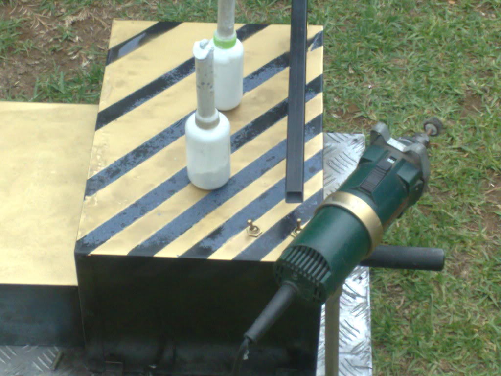

Hi, let me try to explain how it is done.farhaad.sonday wrote:must Ur tire have white lettering to be able to do the w/wall or
do u simply paint a white stripe on the tire or
do u cut a groove, smoothen then paint the white
interested to know
thanks
First i have to find space for the white wall, you know Te tires have a lot of righting, when the place has Benn chosen, the tire have to be clean, then, with a pencil grinder using a flapper wheel, (sand paper 80 grit ) just taking out all oils, wax, dirty, then the white wall is painted on the tire, the paint is imported from UK,i painted my first wheel in november last year, still going strong.
any more ??? please just pm

Looks very nice...whitewall wrote:HI you can get white wall any size, longs your tires allow space to make the white walls, same tires have so much righting on them, that is no space, what i use do, just clean the area whereBlitzkrieg wrote:I've seen an insert with a thin red stripe. Anyone knows where I can get from?

New up date.whitewall wrote:Hi, let me try to explain how it is done.farhaad.sonday wrote:must Ur tire have white lettering to be able to do the w/wall or
interested to know
thanks
First i have to find space for the white wall, you know Te tires have a lot of righting, when the place has Benn chosen, the tire have to be clean, then, with a pencil grinder using a flapper wheel, (sand paper 80 grit ) just taking out all oils, wax, dirty, then the white wall is painted on the tire, the paint is imported from UK,i painted my first wheel in November last year, still going strong.
Live is short enjoy the ride.
New white wall tech is under development, no more PAINT, a white silicone rubber is inserted in to the tyre, expands and contracts as per the tyre temperature, i expect that white wall last long as the tyre live, no problem to clean as is part of the tyre, i got two of this new walls on my car to run test on it, i will keep all inform of the results.
