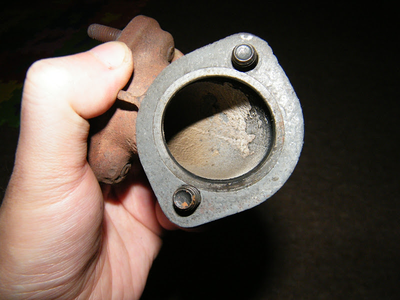

So the port matching has been done now.
Before:
After:
Before:
After:
Time to polish and put it back together. Valves have been lapped.
Before:
After:
Before:
After:
