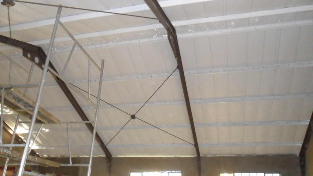

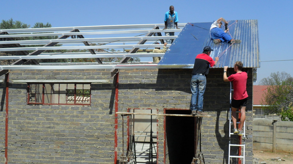

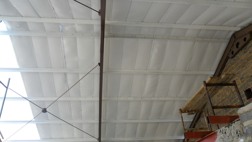

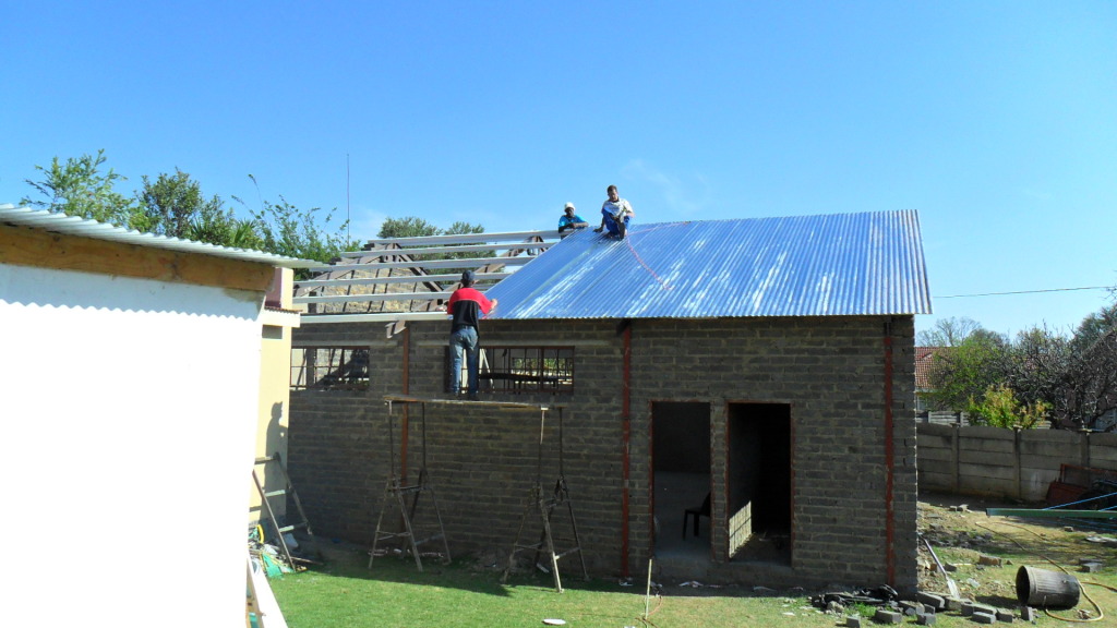

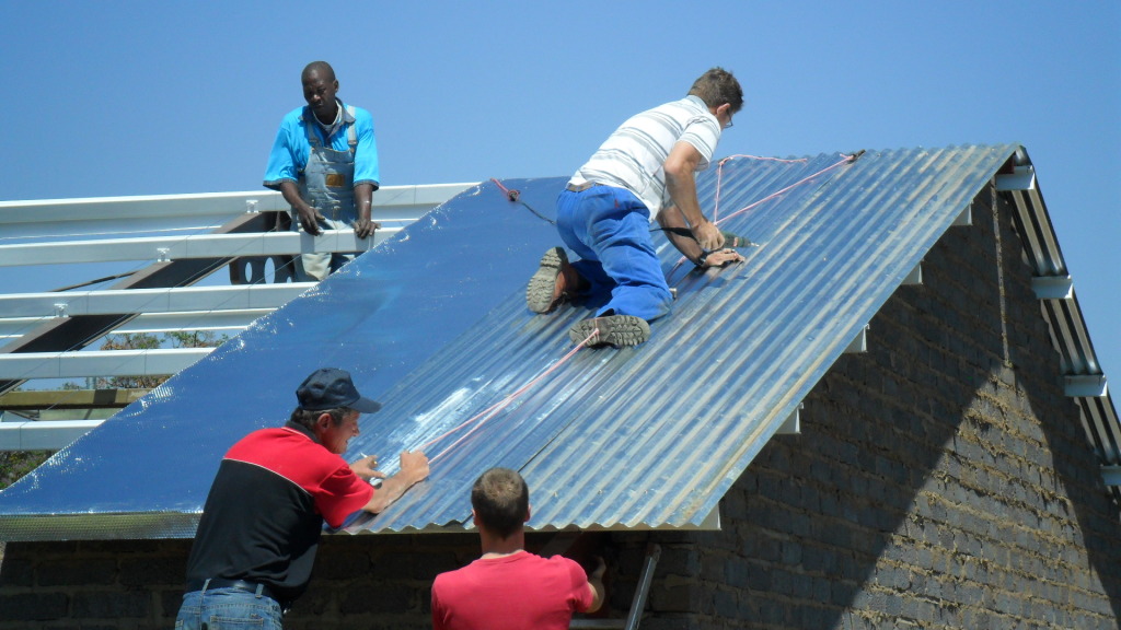

We started on the roof this weekend. quite scary so high of the ground.
I Installed Alucushion under the sheeting for insulation: must say this stuff is cool
Armand

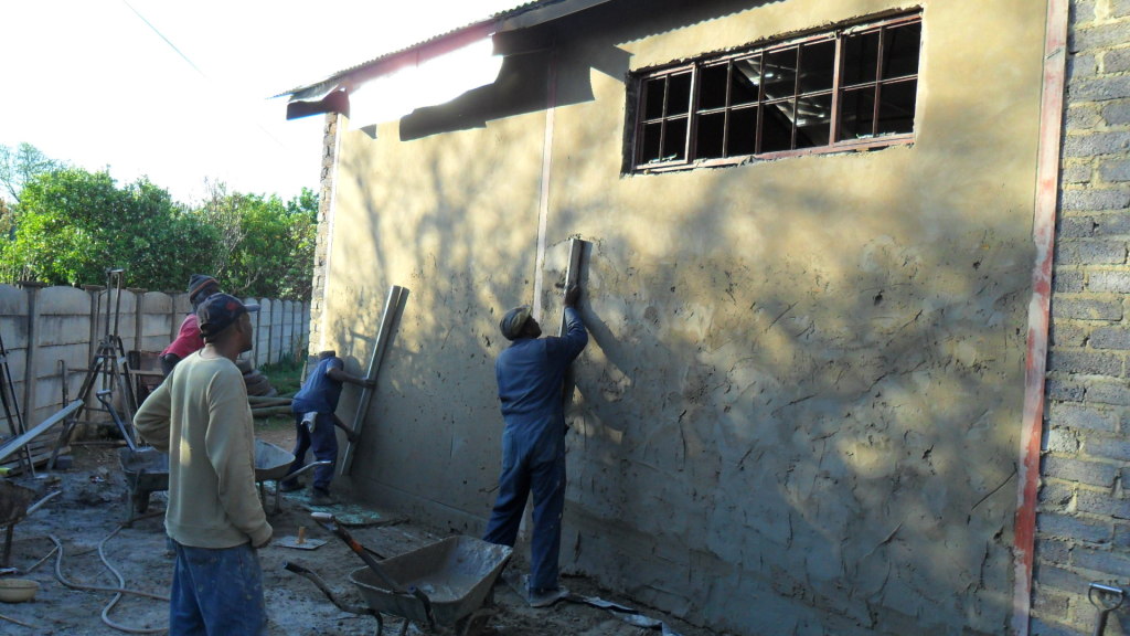

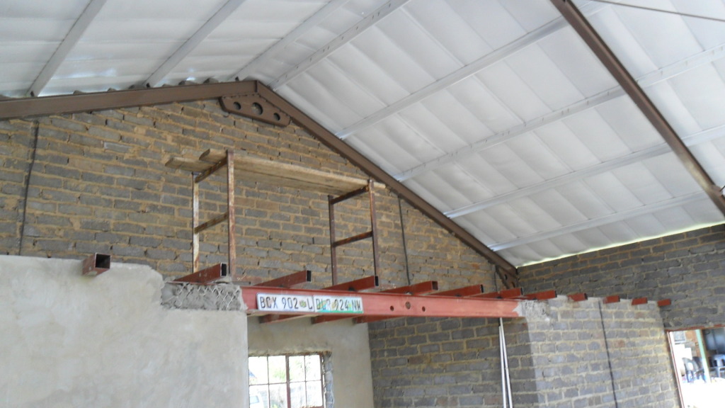

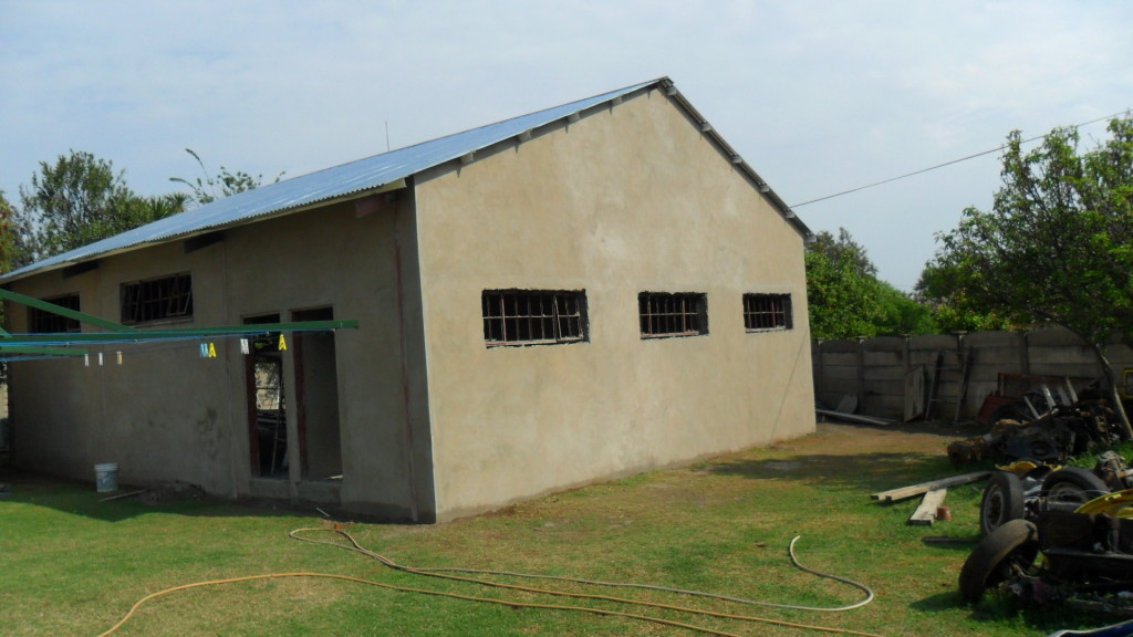

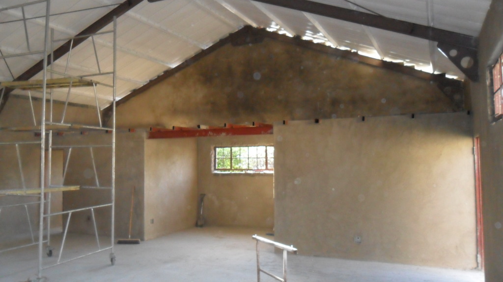

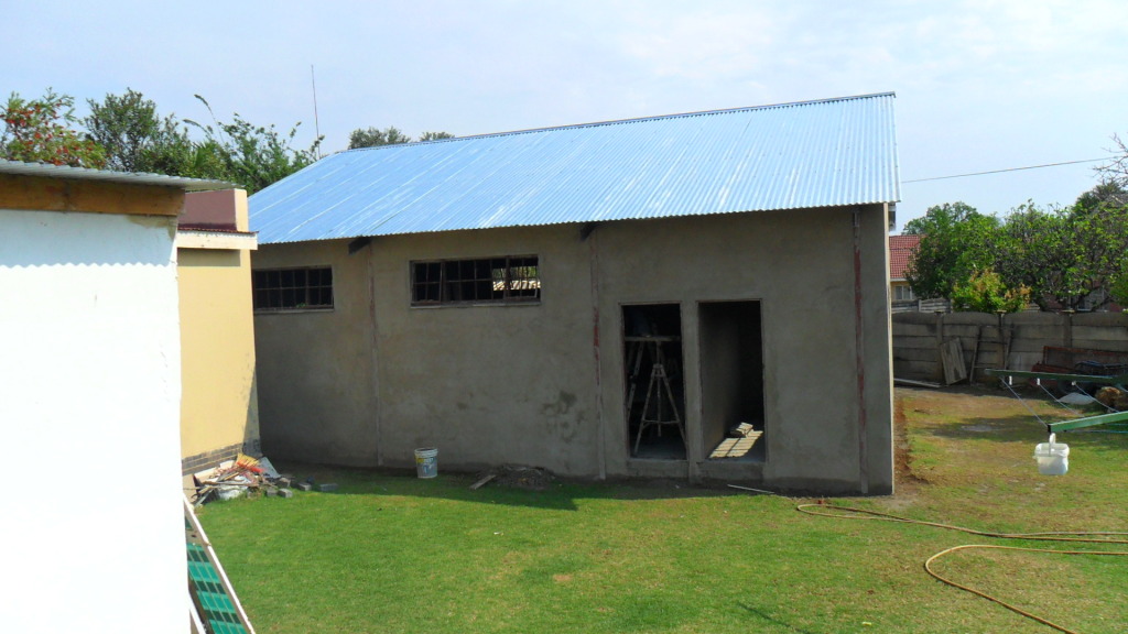

Hi all been busy so far this week
roof has been sheeted
plastering iside almost done
started plaster on outside
I am so proud of the inside no more condensation on my babies
Armand

Uhm...is that a safety rope you have around your foot?IMPI wrote:We started on the roof this weekend. quite scary so high of the ground.![]()

Hloni wrote:Uhm...is that a safety rope you have around your foot?
That is to prevent his foot from slipping

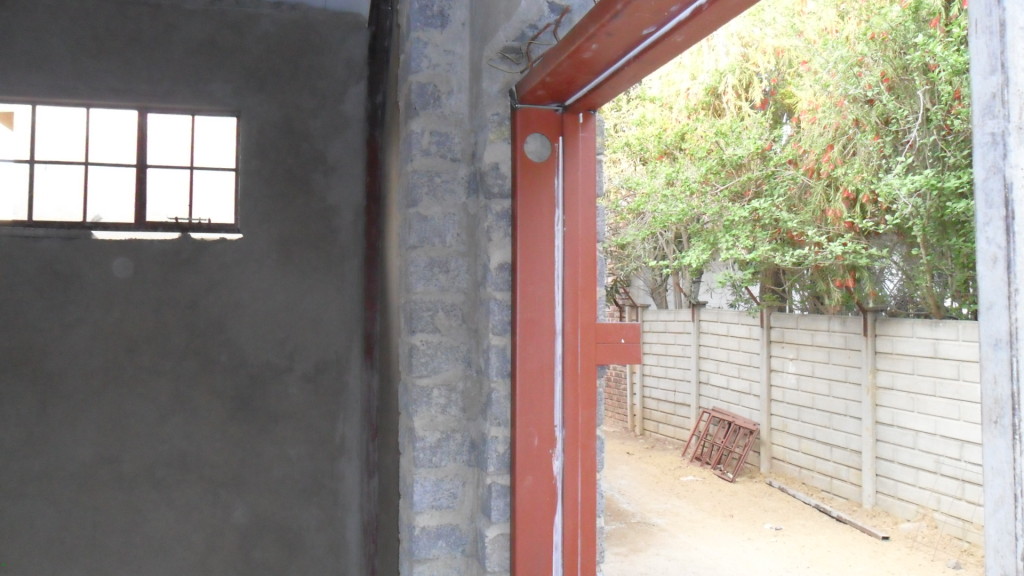

Re: The three hole garage
Hi

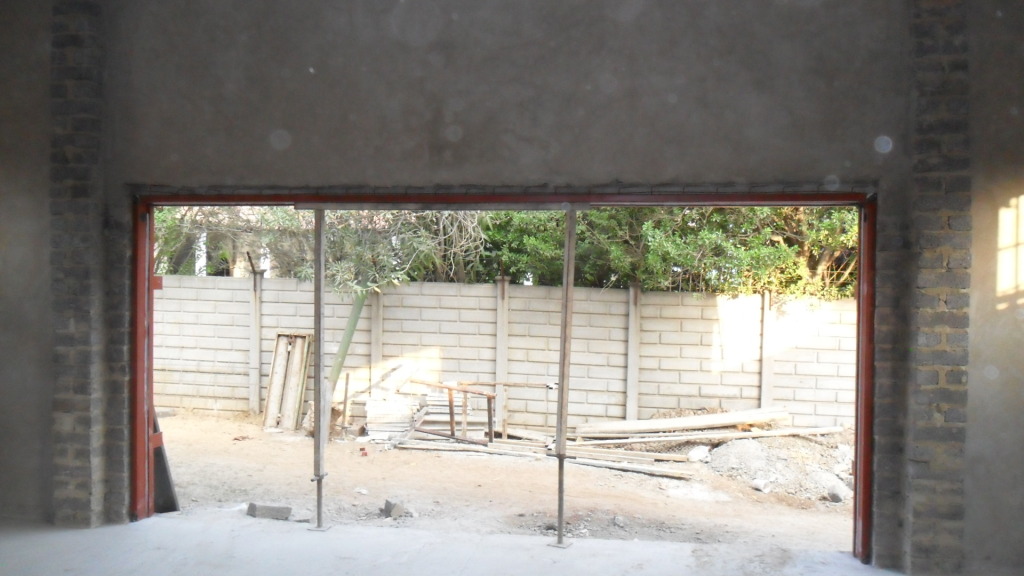

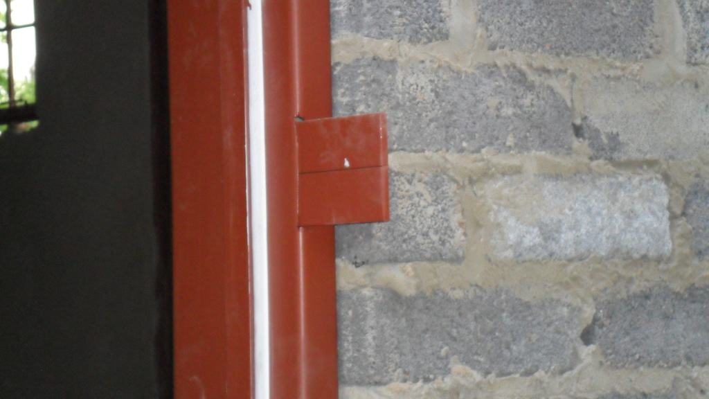

not a lot has happened so far but I can report that the roof is complete and the building is 99% plastered I also built a door frame for the entrance to my own design. I plan on installing two barn doors which would also look good from the inside (Most roll up doors look
from the inside where i\I will be spending most of my time
The door frame turned into quite a project by itself using 12m of 38x20 square tubing and 12m of 200x50 channel
the hinge mounting points were welded into the structure
Regards
Armand
