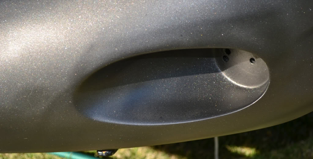

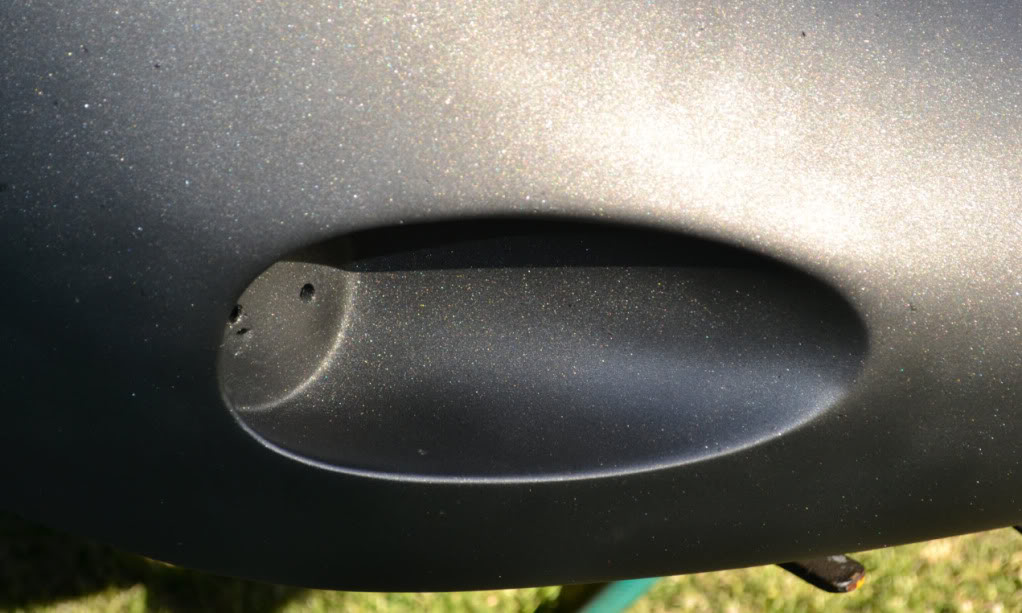

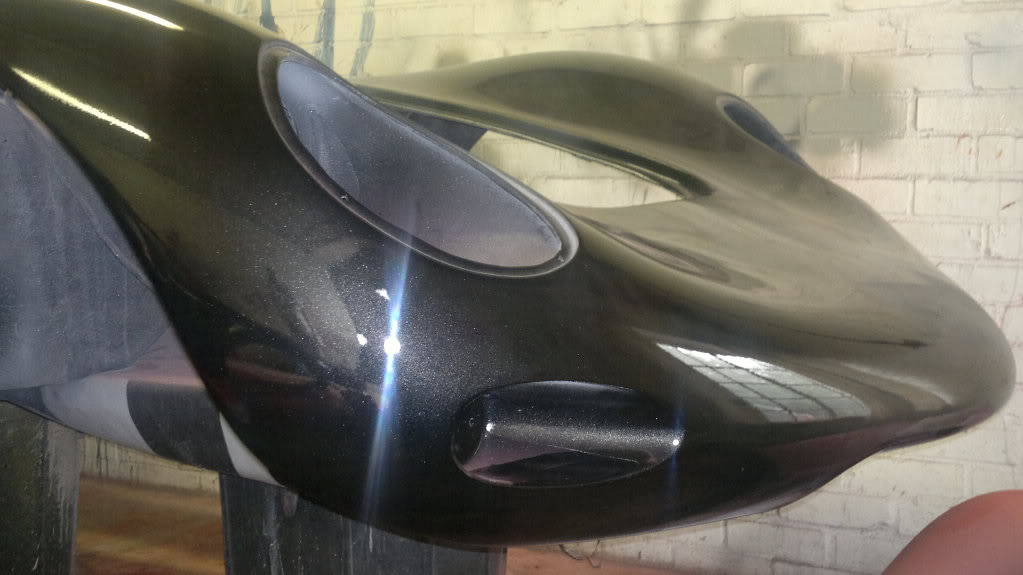

Okay, so most of the prepping is done so finally it's time for basecoat
Decided to rather save the clearcoat in case of any imperfections during basecoat.
Will rather watersand to an 1800grit before going with the clear.
She will be super-shiny once the clear is done --- no imperfections will be tolerated.
Will keep some more pics coming as and when the progress has been made.

Metallic basecoat can not be sanded in fact wiping it with a rag gives marks which will be seen once the clear is on

Re: The Yellow Thingy-me-bob: Spyder
Hi Armand
You got me seriously worried now!
Luckily I've only just applied the mist-coat to the side and the front.
Can I still apply more basecoat and then go in directly(after flash-off times) with the clear?

Hi Rouxlois. I just bumped into your thread now. I nearly had a heart attack when I saw you were planning on sanding a metallic base coat. This is just not done. To answer your question. If you have already sanded the base coat you can re-spray more base over the sanded coat but you must spray the whole panel or you will be able to see the transition. Don't do too many layers of base because the clear coat actually has to 'seep' down into the base and set off the whole thing and it wont go all the way through with 20 coats of clear.
(I am secretly hoping that you have finished the spraying already and that it looks awesome!)

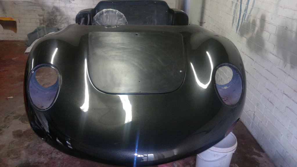

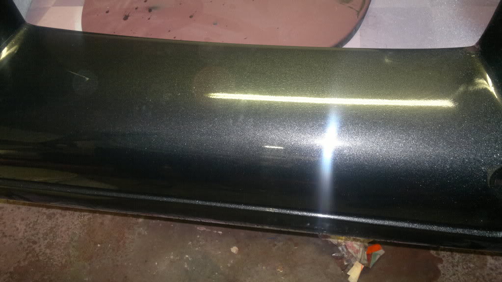

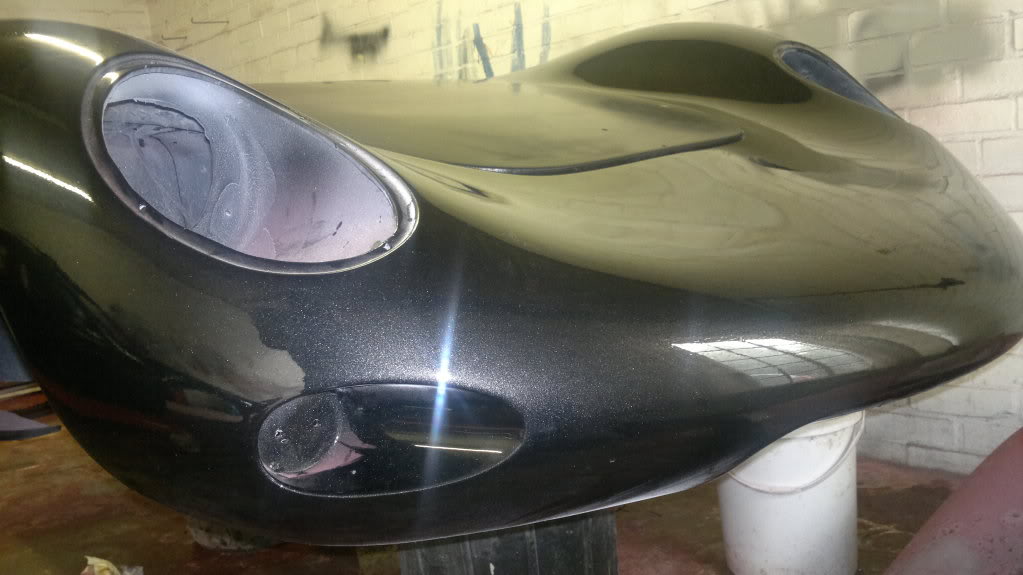

At last!!!!!!! Here comes the paint !!!!!!!!!!!
Not even buffed yet
It even looks as if she's smiling
Not even buffed yet
