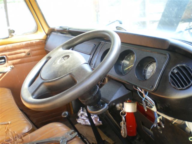

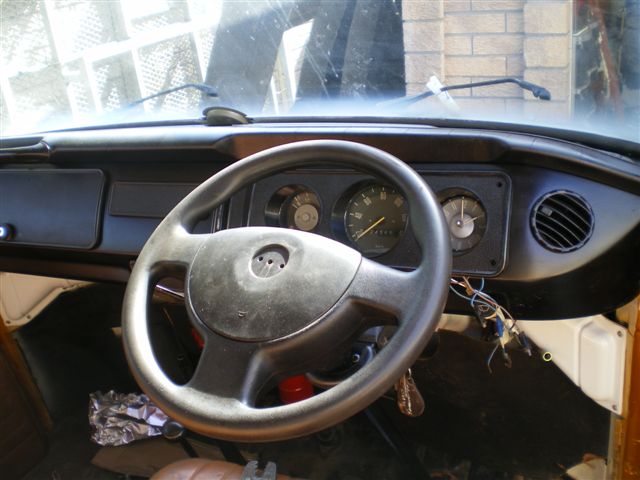

Spent the day doing the wiring, and getting the dash into the car.
More wires then I need...
Think the PO has added some more, just to confuse.
Have the lights, indicators, hooter, and some of the dash working, will have to spend more time with it.

Good point, there, but in my case, the PO had decided that it would be more fun for me if he removed the dash wires himself, and added some more loose ones just to make it more interesting.oldschoolgp wrote:Regarding the dash and cluster .....I also took the whole day to sort out all the wires the first time .....than I got slim for the next time .....I marked each wire as I took it out than puting it back was a breez
But I do not mind, as I then know the wires are correct, and will not super heat the cab, one day on a lonely road between Pit-sonder-water, and Gat-sonder-ent.
Also, I have found that all the spade lugs are super brittle, and have creaked off one side.
So this would have been a mayor problem in the future.
Have also added a clock to my Dash,
For those still wondering about my dash, well it has a 1970 Bay fuel gauge cluster, an 1976 Barzilia speedo, and a type 3 clock.
I just love it, just as mixed up as the bus......

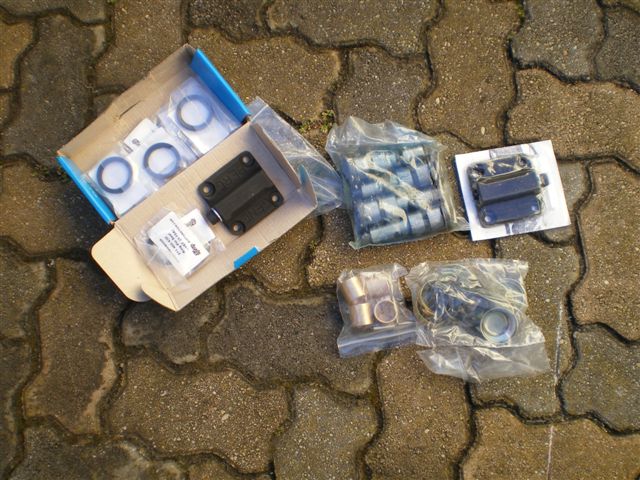

Toys arrived today.....
So now I have my Link Pins, as well as the King pin bushes, and all the seals.
So now we will complete the front axle with all its Mechanical goodies back to 100% as the day it come off the line in 1976 in Brazil.
The Pressure re leave oil pump cover for my new 30 mm oil pump, so all is ready for the type 4 engine.

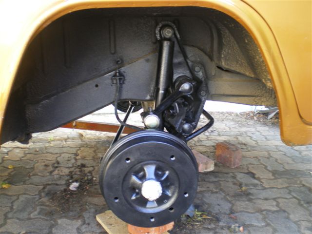

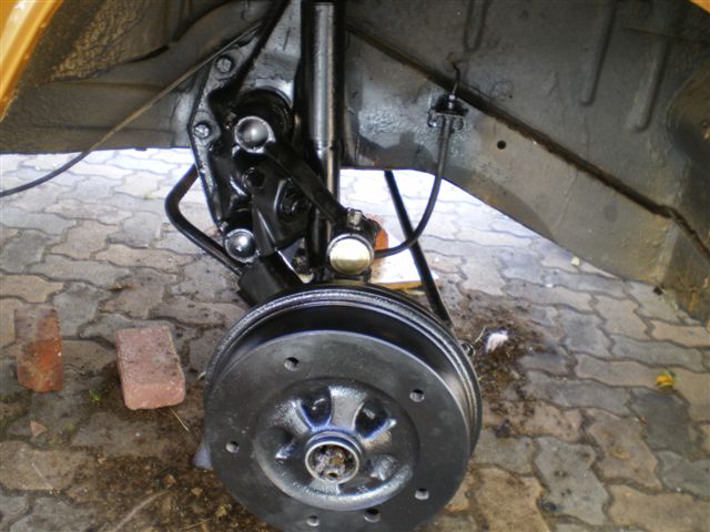

So the steering wheel is done, and looks good to me anyway.
Have completed the Link Pins and the king pins or king knuckles as they are called on the split.
Have done the parts today for the right side, but still needs assembly.
Will put a "How too" on this thread for the new guys should they want to read about it when I am done tomorrow evening.

Well managed to fit both sides, before the sun went down, and still got a good swim in.
Here are the proof of my labours......

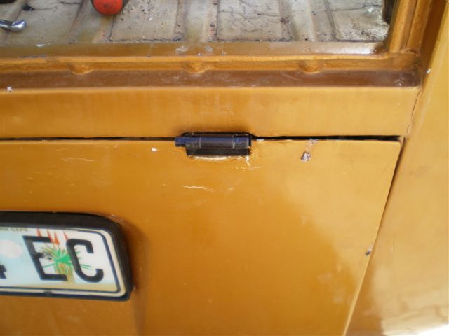

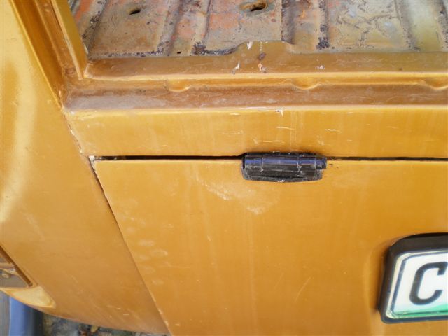

And the Engine lid hinges that where fully rusted and the pins broken in them have cleaned up nicely, and refitted with new pins....

Sorry to burst your bubble squire, but that is a standard dash you have there. It's the same as mine.
- Posts: 8716
- Has thanked: 423 times
- Been thanked: 542 times
Re: RetroVans's "Fugly Braziliamba" Project
You need glasses Sir,...hitlers revenge wrote:Sorry to burst your bubble squire, but that is a standard dash you have there. It's the same as mine.
This one has two indicator pilot lights, the original one I took out had one, and the tanks gauge is different......
And I have a clock.....
The only original gauge I put back was the speedo, because I likes this one better.
Post me your dash here please......Lets see who needs glasses......
That's what I said. Its the same as mine.
Do I really have to go out and take pictures???
