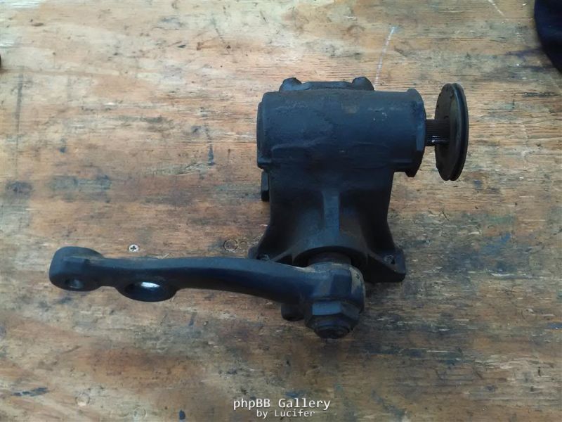

The steering box was a bit worn and sticky. So I took it apart. The upper ball bearing was pretty tired. Hmmm, ok, so take apart a stock beetle's steering box. Fork me, again!!! These are different sized bearings to the stock beetle box. So do some online searching - once again, these bearings are unique to the 1302 and some 1303's.
OK, one bearing has a VW number and the other bearing has a FAG number.
VW - no sorry, part not listed here or in Germany.
FAG - no sorry, part isnt listed in any of our catalogs.
WTF???
More online searching. OK, new steering boxes are available, but only for LHD cars. Maybe it can be converter to RHD using my parts, maybe not. Pretty expensive chance to take.
Now, since I have been to every bearing supplier I can find, I start going to gearbox repair shops, drive shaft and CV joint centers and power steering repair shops. Finally I find one power steering shop that tried to help. The guys took apart various steering boxes including a Nissan 1400 steering box. Guess what? No, it didnt fit either.
:mrgreen:
They found a steering box from a 1969 ford mustang that they did a power steering conversion on a few days before I walked in. Amazingly this box had the same bearings as mine.
Now the guys knew how desperate I was, so they wouldnt sell me the bearings without me paying them to refurbish the steering box. Hmmm.... what options do I have. So, R1700 for a new bearing, along with a refurbished steering box. Ok, they did renew the bushes inside the box, so it wasnt all just money thrown into the wind...

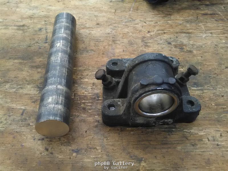

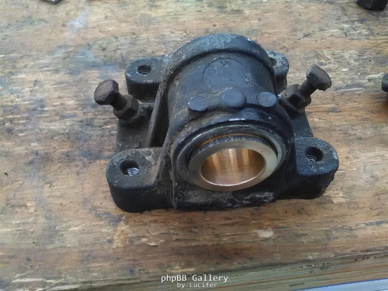

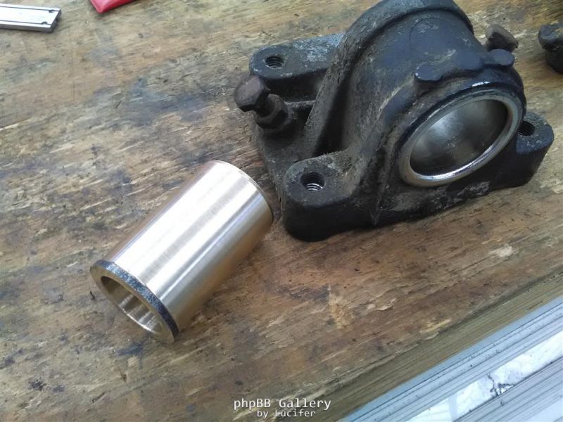

Then I took the idler arm unit apart and found the bush pretty damn worn out.

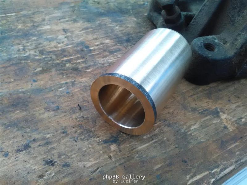

Online searching I found that a few companies offer a brass bush instead of the rubber bush which reduces play quite a bit. So I made one up out of brass stock I had lying around.
The bush is a slight press fit and the inside diameter is approx 0.03mm wider than the shaft it supports. So hopefully this serves the purpose it is intended to serve.

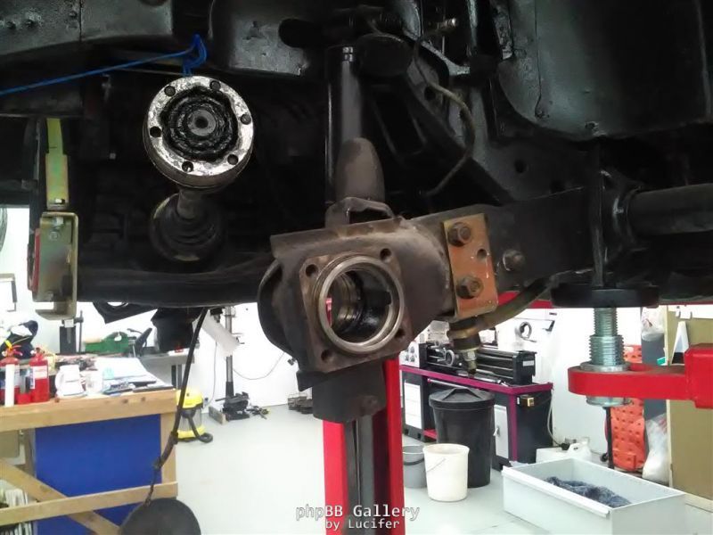

So, start at the front. Hmmm, stub axles are a different size to those on a K&L car. So try to find bearings that will fit my stub axles and the hubs. Yea, no such bearing size exists. So I am currently facing 2 options. Custom make new hubs or make up inserts ti fit into the hubs to allow use of the bearings which I can find.
I'll probably go with the inserts for now.

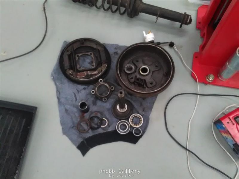

For now however, we start by removing the CV joints and stripping the axles.
Sourced and installed new bearings and seals.

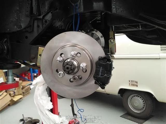

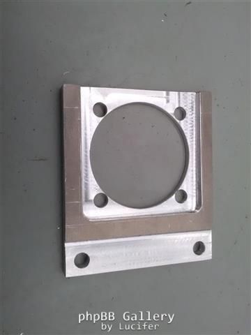

I then sourced rear discs which would fit my calipers, 280mm diameter. These now match the front discs and will look much better when behind the wheels. Yes, this car needs looks and functionality together.

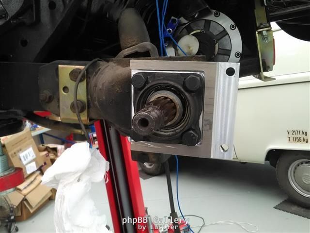

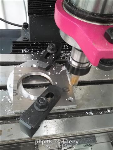

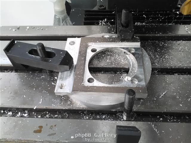

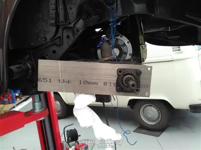

However, being a different diameter and height, the caliper now needs to move. So I had to make up caliper mounts.
Measure twice, cut once.
I wish it was that quick and easy. Anyway, about 10 hours later we have this

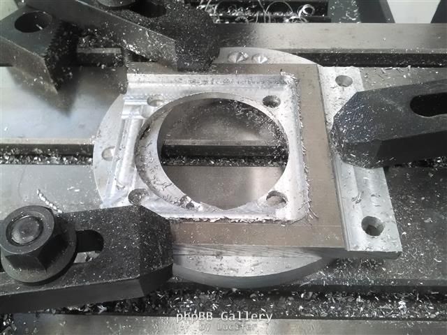

mocking up after first marking out and cutting
Back in milling machine
mocking up again

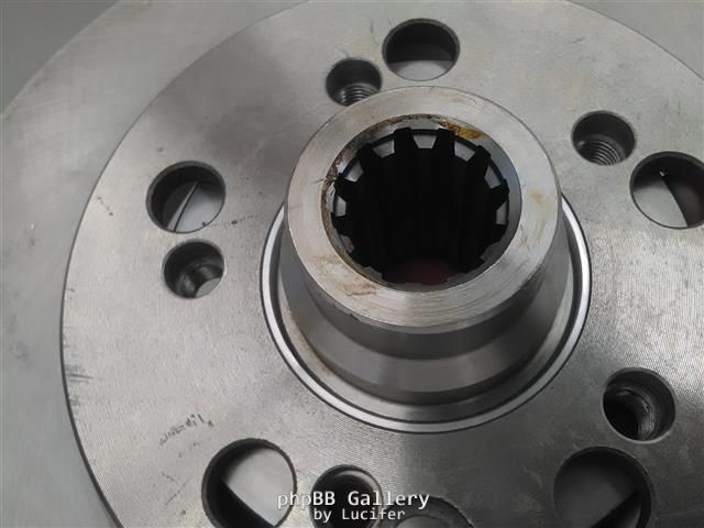

I then had to redrill the discs to my 5x100 pcd that I'll be using. While doing this, I decided that I needed to make inserts to fit over the hubs and fit inside the discs to locate them and allow the discs to run properly true to the hub without affecting balance and causing wobbles. I am proud of this one - the inside of the insert is 0.02mm larger in diameter than the hub and the outside is again 0.02mm smaller than the disc spigot. So things fit easily and sit properly.
Final pic
I am still busy with this project, but its nearly done. But its good enough to post pictures so long.

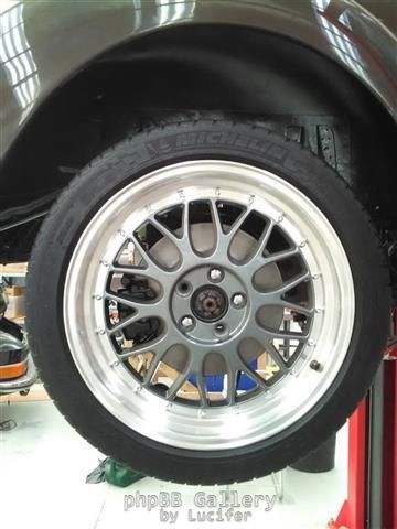

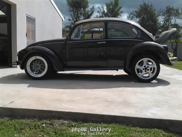

Rear is nearly there. Not done yet, but here is the test fit of the rim with the 280mm disc rotor behind it.
Definitely looking much better then the smaller golf rotor would. I need to do this for Angrrr at some stage too.
For now though, its time to move onto the front and make some progress there.
I've got a small shopping list of things I still need for the rear (more aluminium stock and longer wheel bolts for example), so I'll focus on the front end for now until I have no option but to go shopping for bits.

Looks awesome Tony! Definitely agree that it looks much better than the small Golf rotors. See you fitted new rubber to the rims as well. Nice!
(o= i =o) (o\ ! /o)
Re: Tony's 1302S
lol, that is actually Angrrr's old tyres - the two that were worth keeping

Slowly taking shape. Disc brake conversion is taking longer than expected, but its getting there.
Rear will need to be lowered and the rear rims are just on so I can move the car.

Really like the look and color of those front wheels on the beetle.
Re: Tony's 1302S
Thanks Guys.
D - yea, I am also wondering if I'll need to get them painted or not

Tony those front wheels do look good. What colour do you want to paint them ?
Re: Tony's 1302S
not divulging all of my secrets just yet
