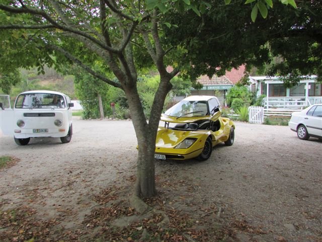

Anyway thanks guys, we got the Panel Van down to George and back...
In the next post i will list all that was done to the 1971 P/V but now good news.

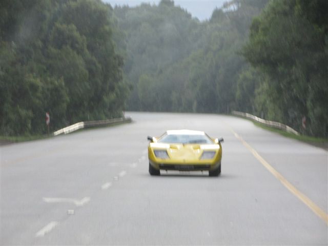

Johan (Eagle) joined me on the Saturday early morning run to George, as I was still working on the bus at 18H00 the Friday night.
She run fantastic, but on the way back home, approx, 10Km from home the brakes started binding due to the MC not bleeding back to the Brake fluid tank
so this week we will get a new one and ready the Bus for KKK.

glad she ran well. Congrats. Now the rest of the project continues...
That Eagle does look pretty!

You right Tony, after the KKK, I will have all the time I need to get to the "Work in Progress" project of the Panel Van
Getting her on the road is 1st priority, then I will not loose interest in a dust collector in the back of the workshop....
Have Great plans for her, one would be to name it, as it is replacing a legend, and has big shoes to fill, the Fugly has dug deep into my hart.
Johan 1st had an Alfa motor in the Eagle, but found it too unreliable, so he fitted a Golf motor, and is much happier now. She looks and drives excellent.
Should get him to do a Project thread here on the forum on it. "Hoor jy Johan....."

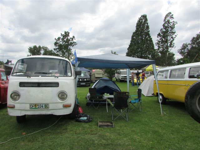

The run to George was a shake loose, to see if she has any issues.
On return I replaced the MC, bled the brakes again, and sealed the wind screen as we where well wetted in George.
So off we went to Parys.....
She ran well bit heavy on fuel, but she did not miss a beat.
As we entered Kroonstad, the Chines starter decided it had had it 4 years of service and was well overdue for a break down.
So push starting her was on the menu as from that time.
tried to do some emergency repair at the KKK, but with little success.
The arrival at the KKK, signified that her mechanics where in line with where i wanted her to be, now we just have to do the body.
I was even more chuffed, and beaming with pride when the FIG'S bestrode a Award on her.
She made it under her own steam, and was not a trailer queen like a lot of better looking buses. :mrgreen:
