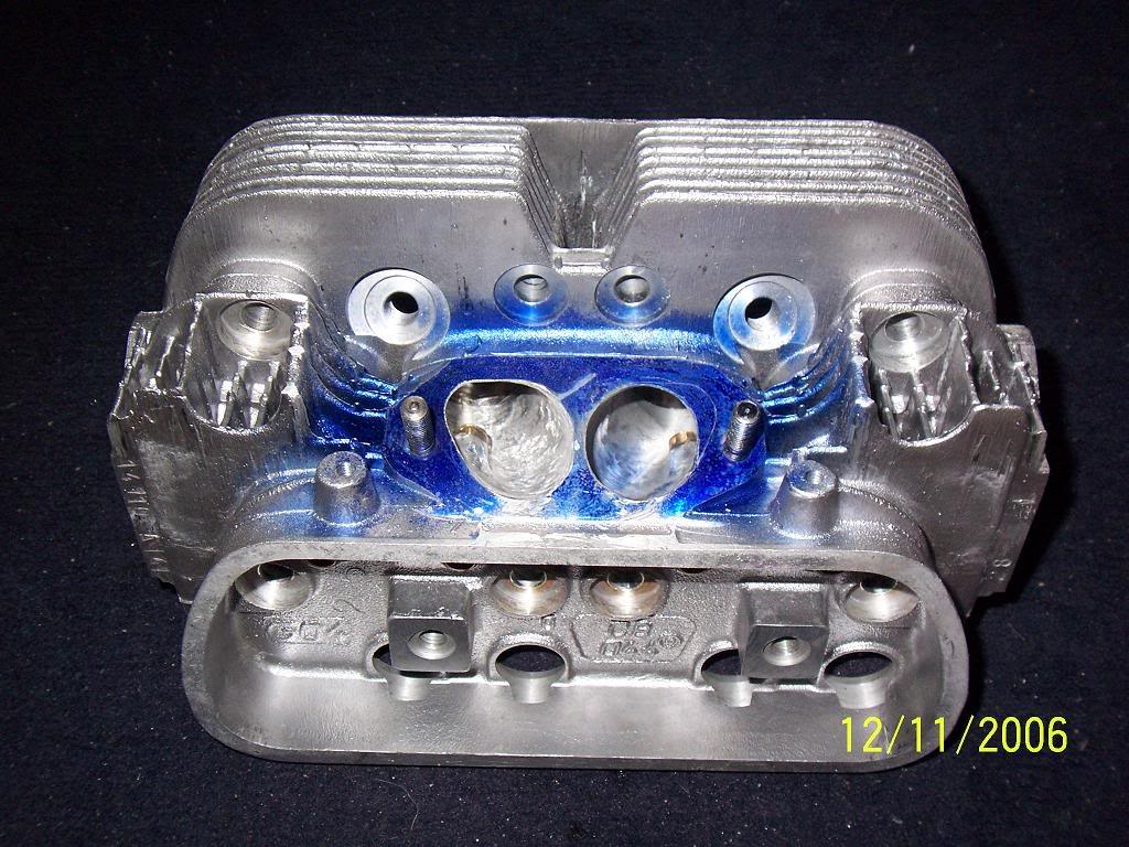

the second pic should give it away...

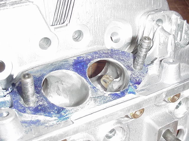

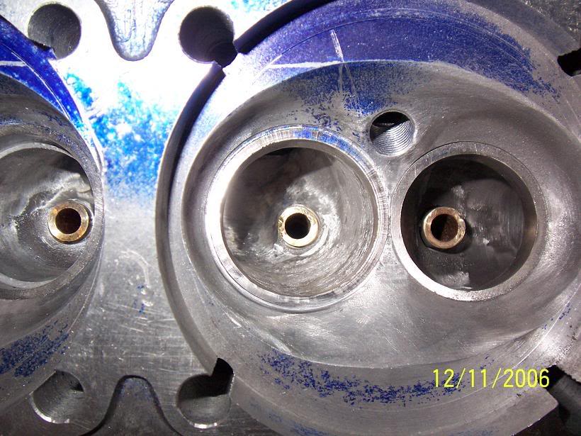

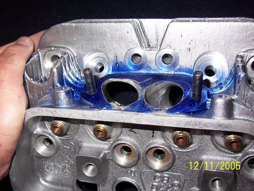

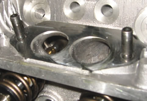

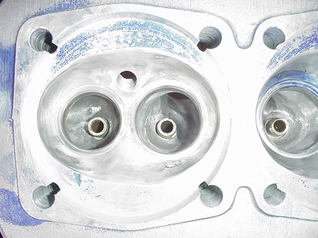

The progress of the heads......
as I got them
Then stage 1 for the 40x35 valves
I cant find the pics of stage 2 of the 40x35 ports...

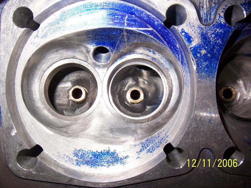

I then decided to F-it and got the heads reseated for 42x37.5 valves
New seats installed
now the seats are blended in

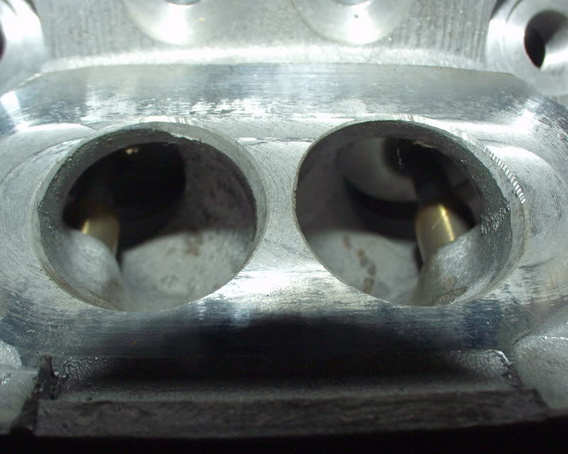

First port finished

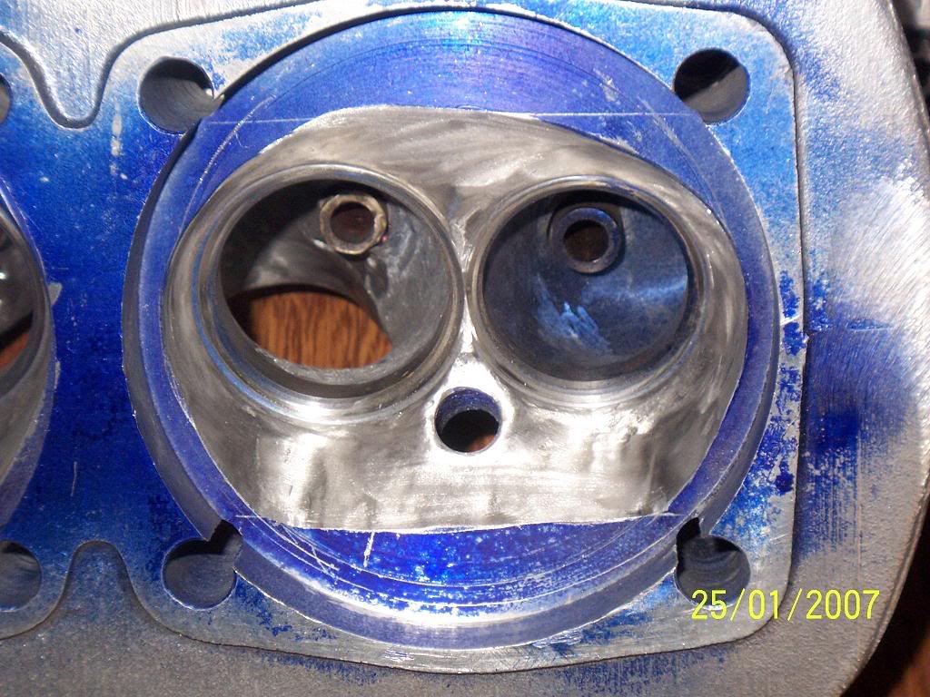

combustion chamber

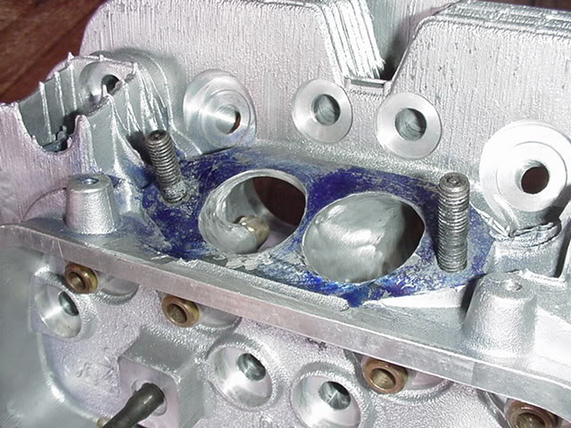

After all that I deceided to step up to 44x38 valves... so I bought another set and started again...
The other heads are finished but the manifolds still need work, only 1 monifold port is complete and 1 is halfway....
The new heads manifolds have not been started yet.[/img]
as I got them
New seats installed
First port finished
combustion chamber
