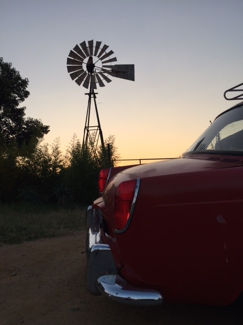

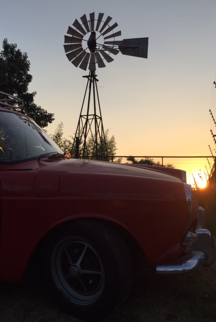

Despite the horrid steering, I had a pic in mind from a location not far from my house, been on my mind for years, so today I figured, lets drive there and get that shot.
a reminder - The Vision

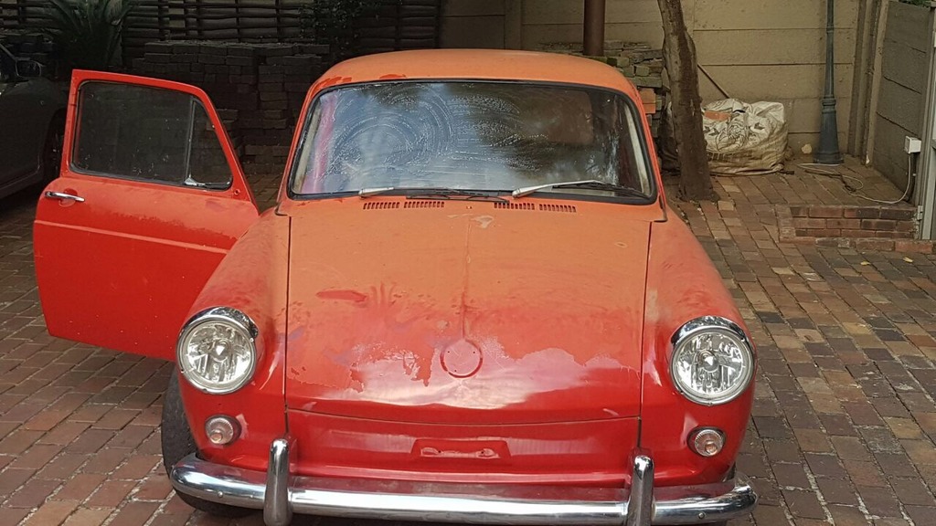

Just unloaded

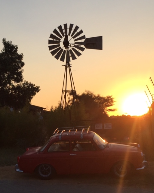

After a clean, tidy and some accessories - The End Result
and a sixties style pic to match the car
LOTS to do, but a running project, is SO much better, than a standing project.
