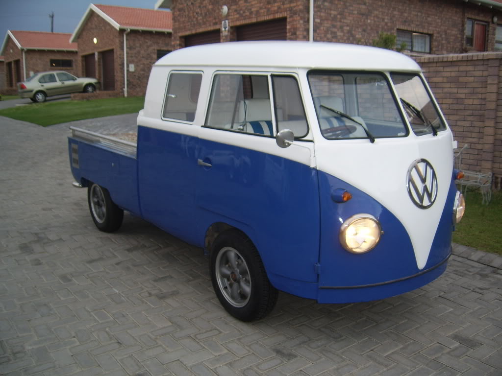

With the help of BAB,we got the wiring sorted today.Just a little clean-up,and everything will be good.
Compare these 2 pics
Today
Today

Re: My '62 DC project on a roll!!(Update)
Uhhmm
your'e not standing infront of ur own garage duh!!!
Ok i see da lights are working and some railing done on the back.
"Money talks & Bullshit walks"
- Posts: 11732
Don't worry ACwannabee,I'm just showing what she looks like now.
There are actually a couple of differances between the 2.
Railings,new lights,new flicker lenses,new tyres,air ducts on the back and just for Zero,she is clean and polished!
