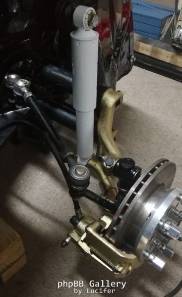

Things that are taking up time now are stupid things like getting the entire front suspension on. When I tried to bolt the shock on I noticed there was almost no thread in the beam to take the bolt. Everything had to come off again to drill and get the tread insert in. I ended up doing this both sides as the thread pitch of the insert is different to the one in the beam. I dont want to end up with different sizes left and right.
And then everything back on again. I ended up taking the adapters with the 12x1.5 studs to FFR to get the bigger studs inserted.
Seeing that I got all the brake parts from Dave I ended up taking the adapters back to him to press in the bigger studs just in case the other guy stuff something up.

What disc brake setup are you using?

Riaan.N wrote: Wed Jul 31, 2019 3:47 pm What disc brake setup are you using?
Not sure, I think its just a golf setup with the adapters.
