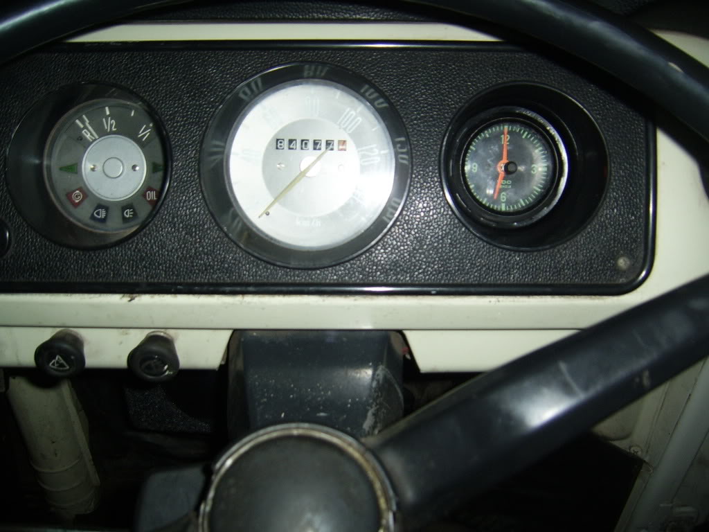

Got the speedo and fuel gauge working.Now I can see how fast I'm going and if I have enough fuel to keep it going at that speed.Fitted a VDO watch I got from a Beetle,but for some reason it doesn't want to work.Will check it out at a lter stage.

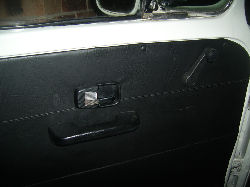

Right hand door window mechanism is also fixed after a cannibalised a beetle mechanism for the winding bit and riveted onto the old mechanism.The bottom part that holds the glass was also badly rusted,so I made a new one from aluminium.

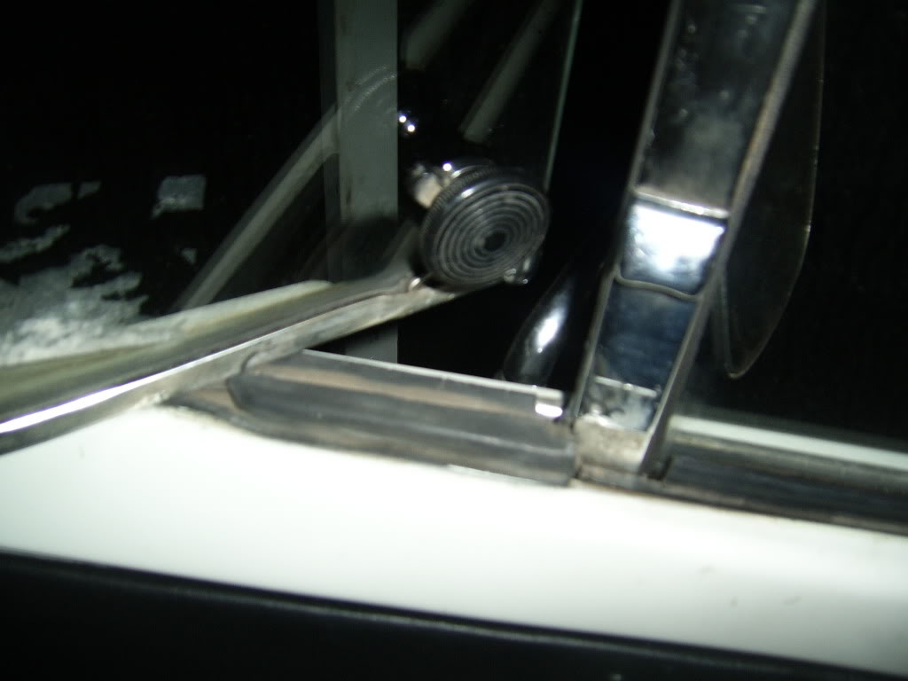

Quater lights can also lock now after I fitted locks I took off old Beetle quater lights.

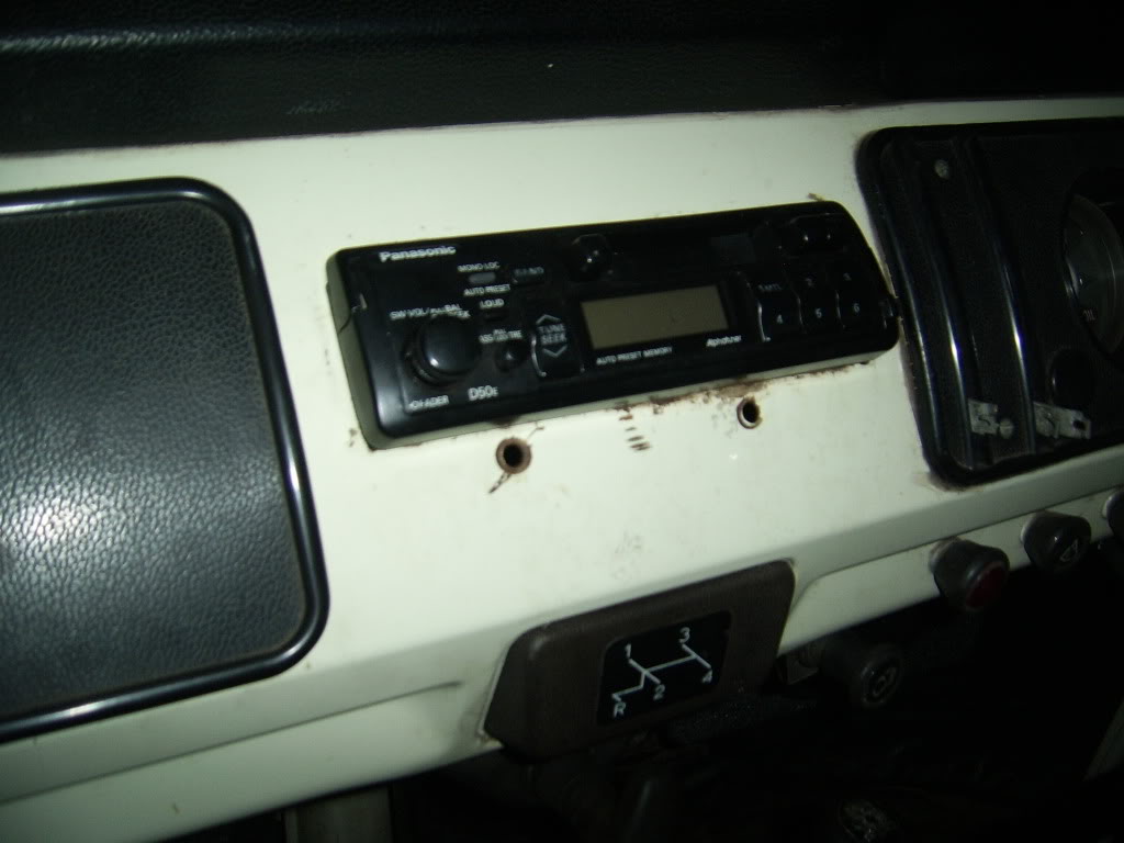

Got an old pull-out Panasonic radio for free and now I have sound too.

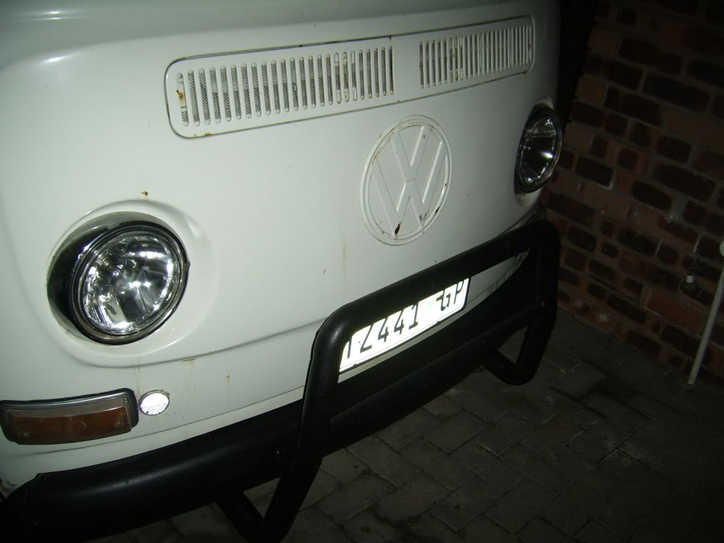

Fitted new headlight as the old ones was not working.The parlights still don't work,but I'll get to that this week.

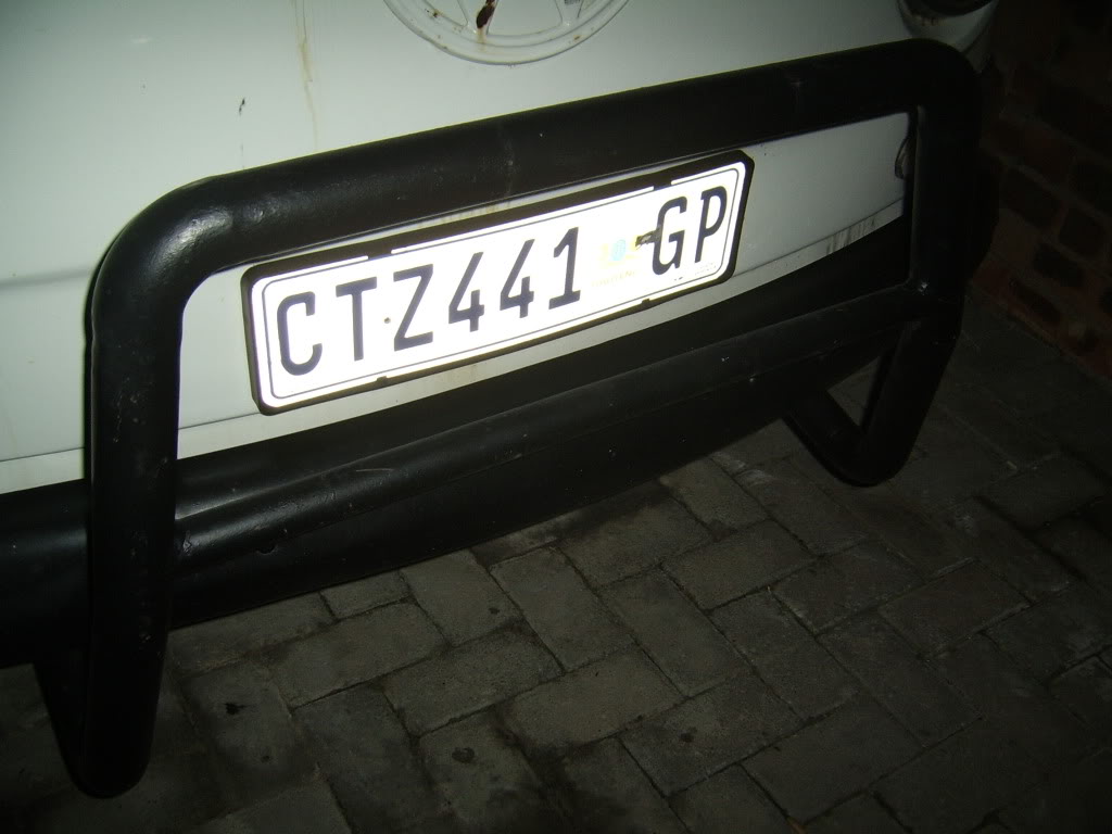

The numberplate was held onto the nudgebar with cable ties.Got a numberplate holder and put it where it belong.

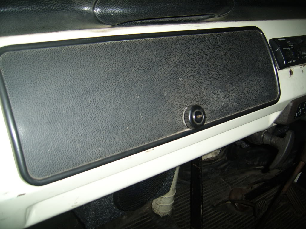

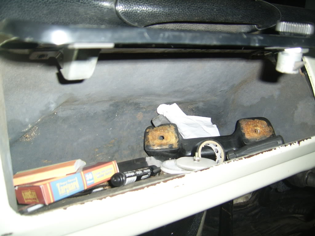

From the DC I'm stripping,I got a good glovebox box and the glovebox cover and fitted that.Now the dash looks complete.

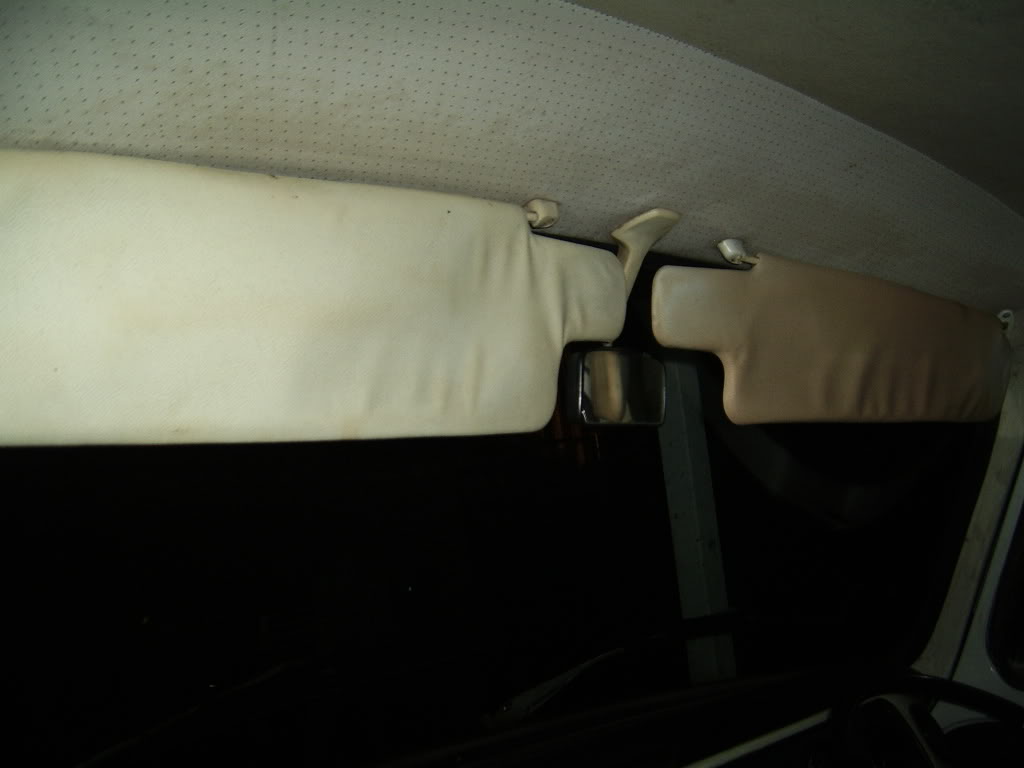

Got the interior light working and also the dash lights.Turns out the the dim and bright turn knob was dirty,and cleaned the sunvisors.

Nice work! Did you know that a s/c or d/c Bay, being workhorses, came without glovebox covers from the factory?
- Posts: 11732
Re: My Lowlight SC
Yes,fig said so,but I like my stuff covered.
