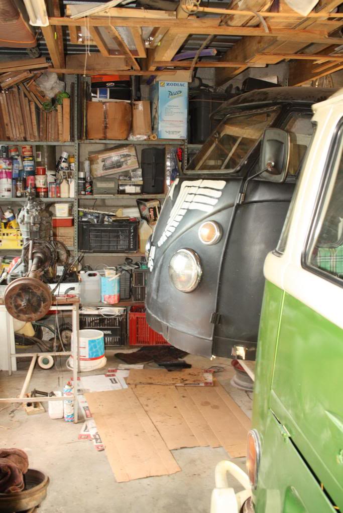

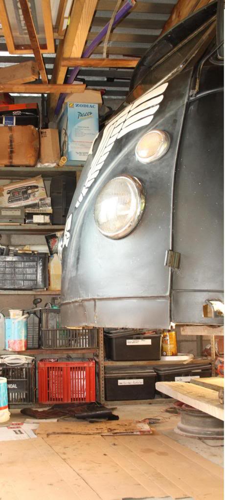

But we managed to get the front lifted

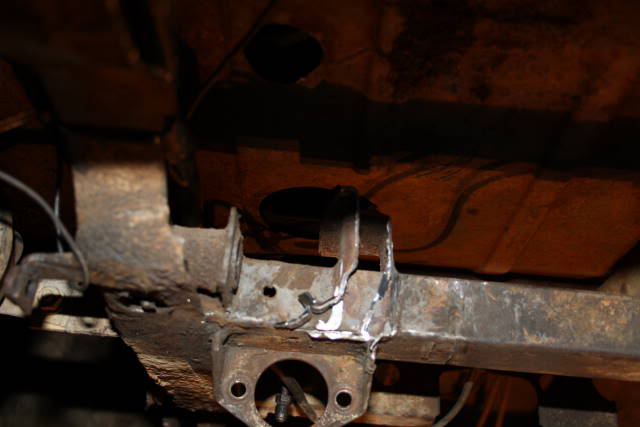

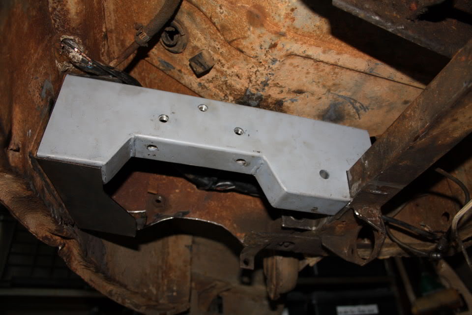

Update on Panel:

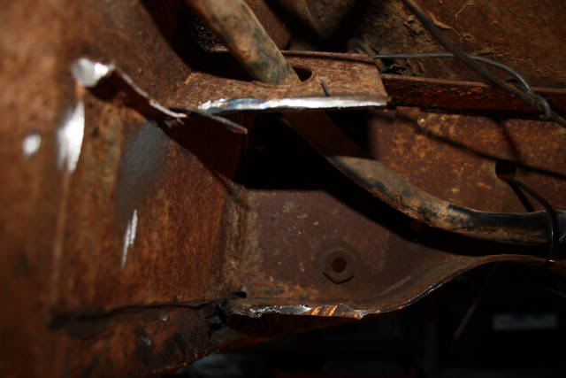

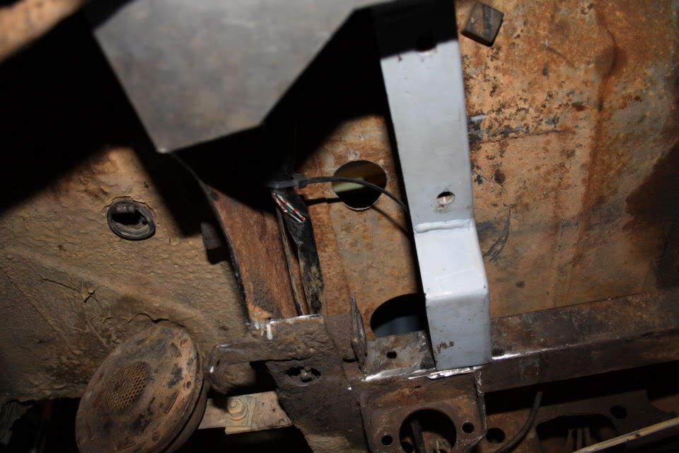

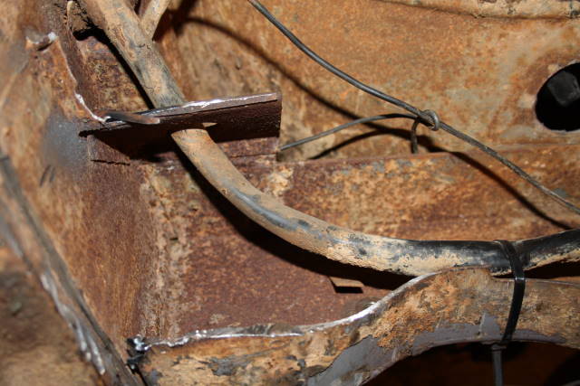

Grinded steering mount off and made way for the new one, Mocking up the set-up to see where to weld.
New section in
With steering box attached:
Side view, the steering box just sticks out
Update on Panel:
New section in

Lovely.....why the steering box so high..... you planning on slamming this lovely bus?

I'll just say loweringDutch_Diver wrote:Lovely.....why the steering box so high..... you planning on slamming this lovely bus?

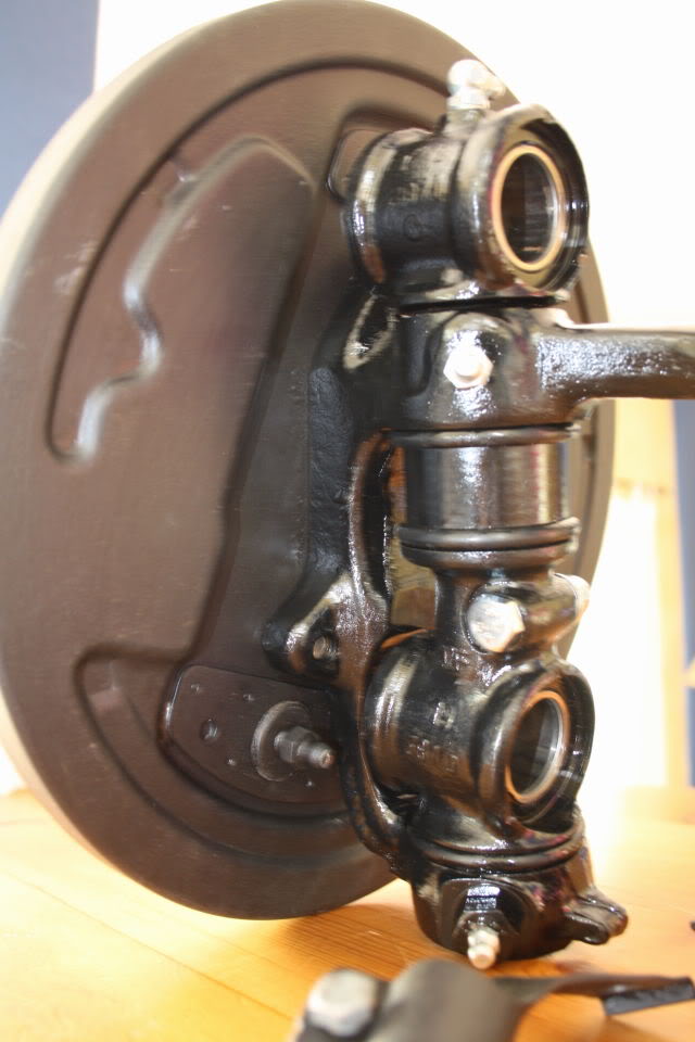

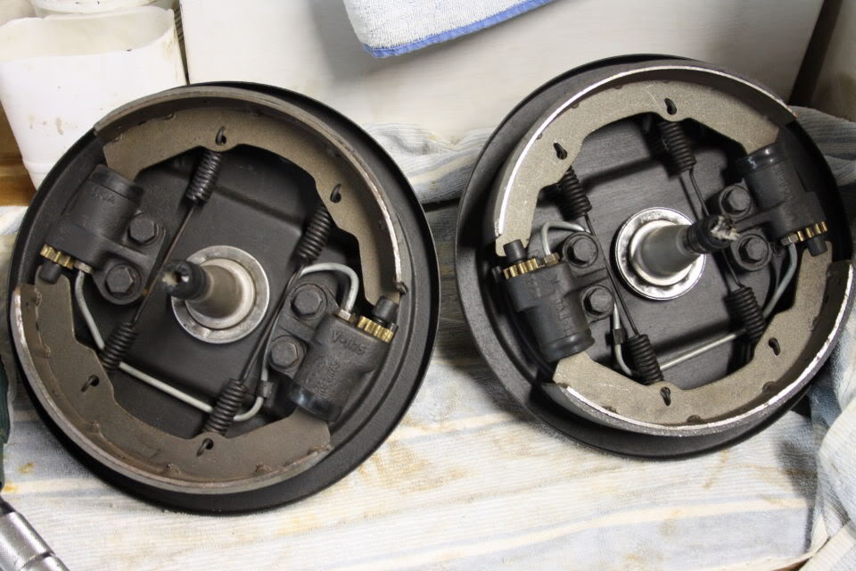

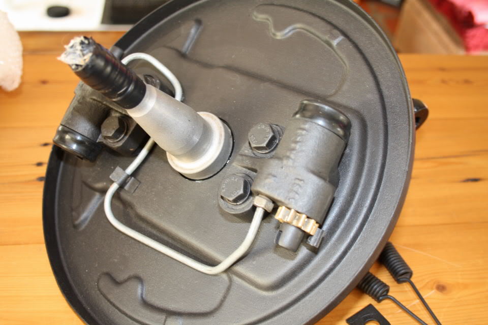

Started getting the brakes back together
- karmakoma

Finished my brakes last night,

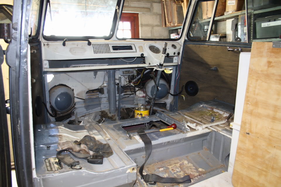

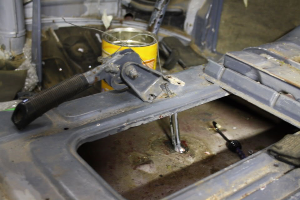

While doing the steering box raise I found a lot of mods done to the bus, with loads of wires running everywhere.
I decided to rip them out, The brake fluid reservoir was underneath the fuse box and the electrics is a mess. Need to tidy everything up nicely
So its one step foward and three back
Some dodge handbrake mod.
Seats removed and messy wires

Yey-ek-sê- where's your bulkhead?!?
