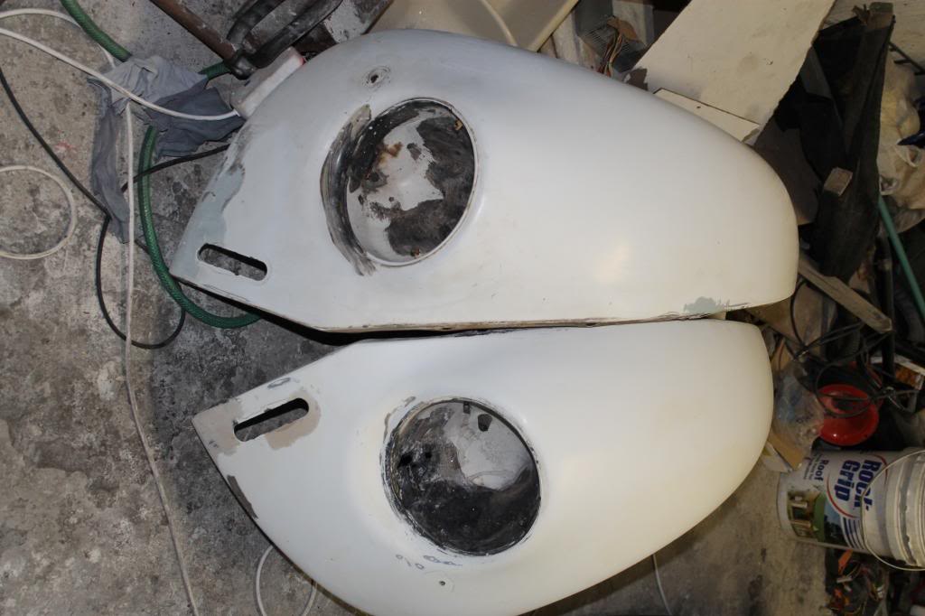

Can anybody see Richard Pryor in the first 2 pics of the previous post???
:lol: :lol: :lol: :lol: :lol: :lol: :lol: :lol: :lol: :lol: :lol:
Posts: 4054
Been thanked: 21 times
Re: My Project beetle - wish me luck !
Post by Ron&Gill »
hitlers revenge wrote:Can anybody see Richard Pryor in the first 2 pics of the previous post???
Jawragtag, we must be smoking from the same doberman. :bn:

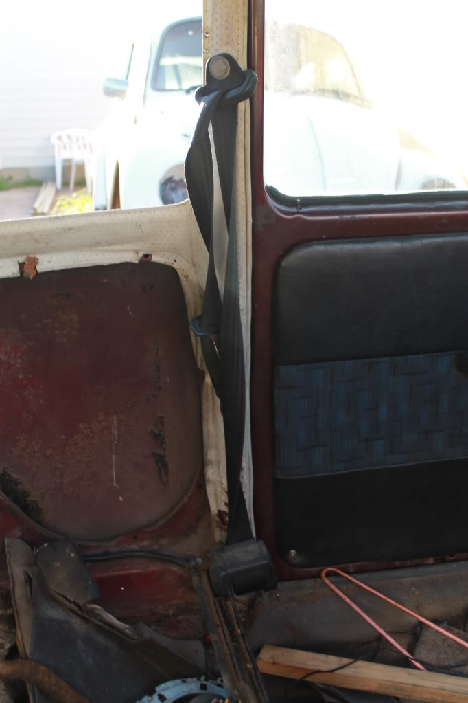

Does anyone know if these seatbelts are original equipment or is it just someones mod?

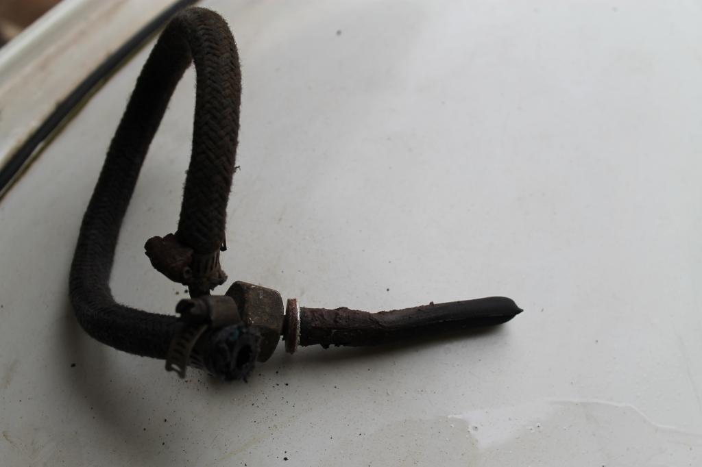

I replaced the needle in the Solex carbeuretter, cleaned the complete fuel line from front to back , including the filter in the petrol tank.

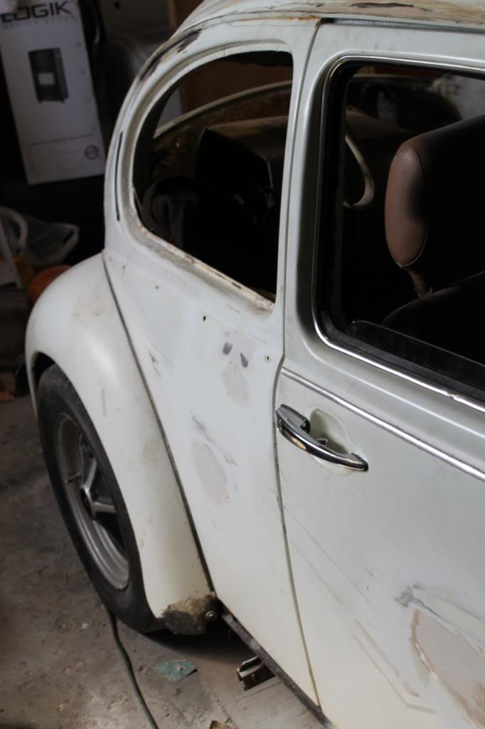

Yesterday I replaced the vacuum pipe between the distributor and the carb and the oil pressure switch and have removed the rear screen to tackal a rust problem>

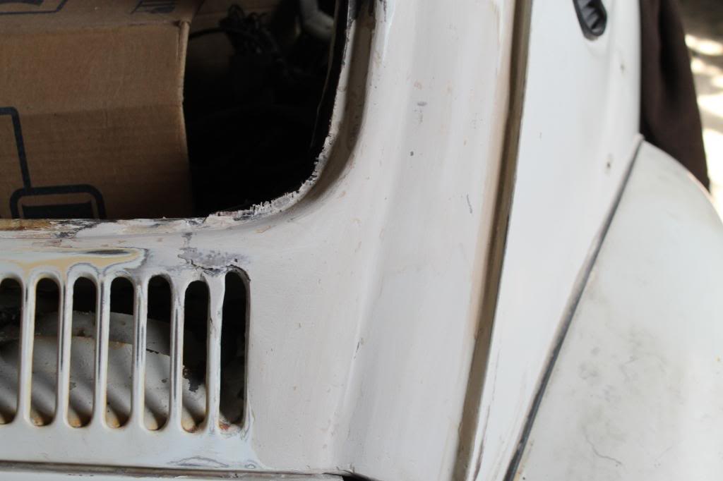

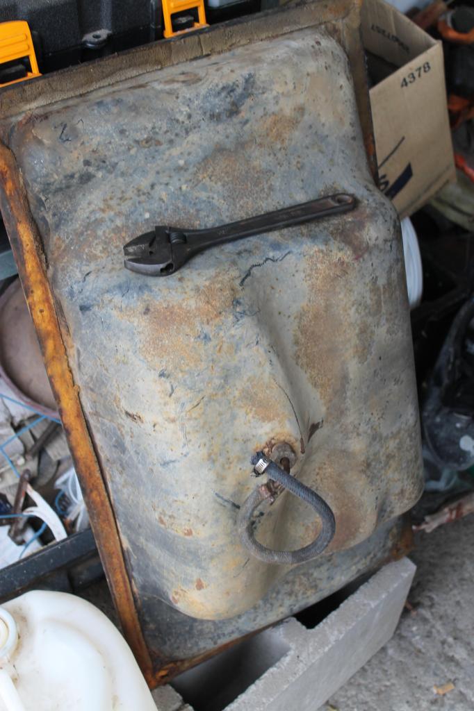

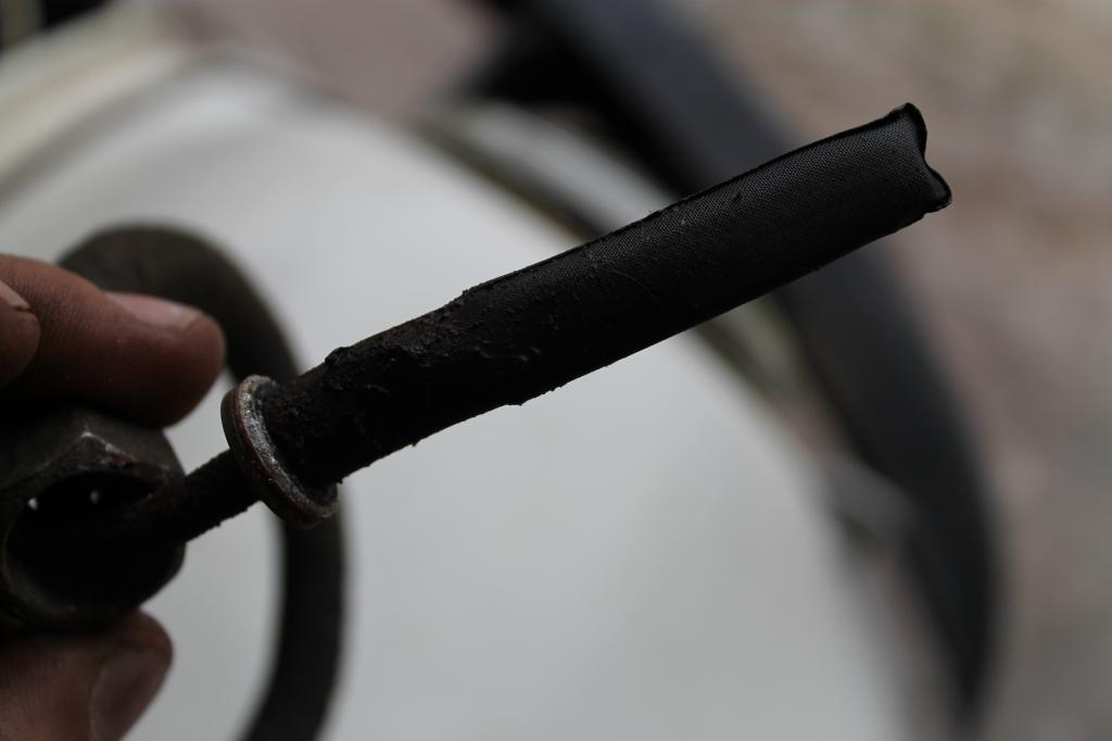

So happy new year to all and a wot wot ! Have been busy ( only slightly ) over the festive season on the nameless white bug. I cleaned out the petrol tank and that small filter, that screws inside the tank. Tank still looks fairly solid for a young bug

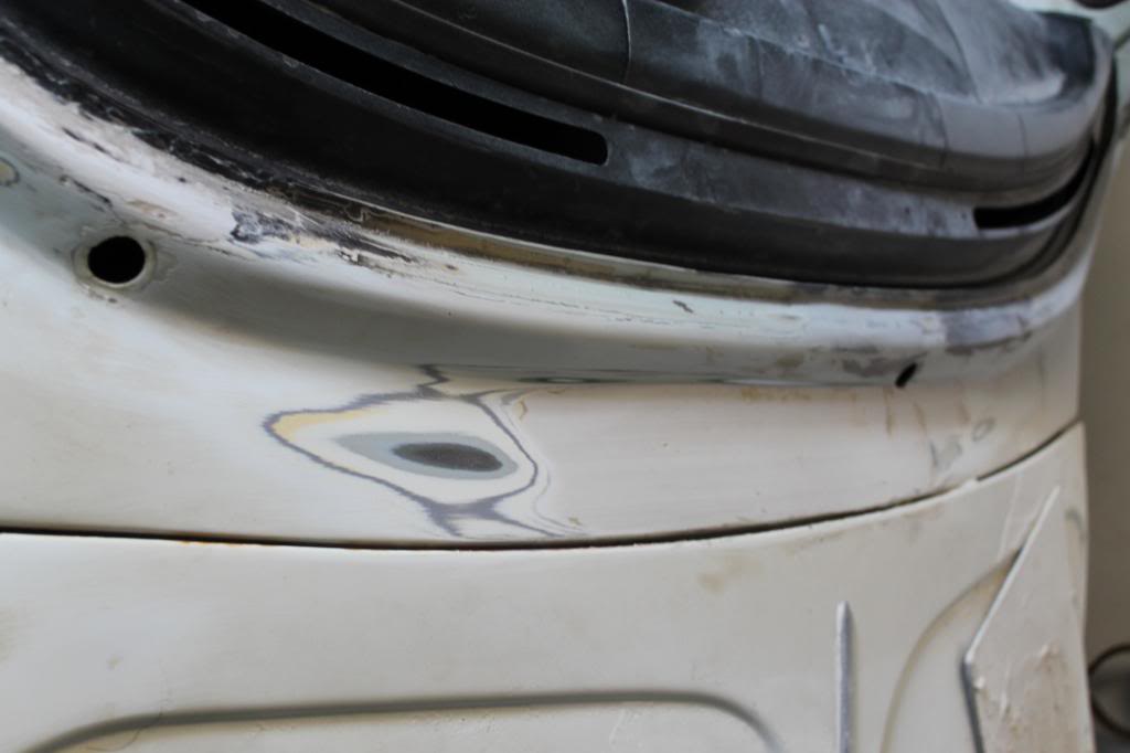

I have also been busy with some bodywork , closed up some holes with fiberglass mat & resin and then shaped with body putty.
The vents were so rotten, I shaved them off

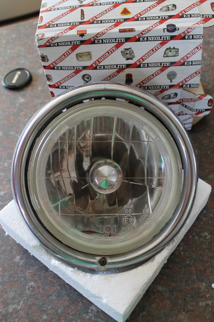

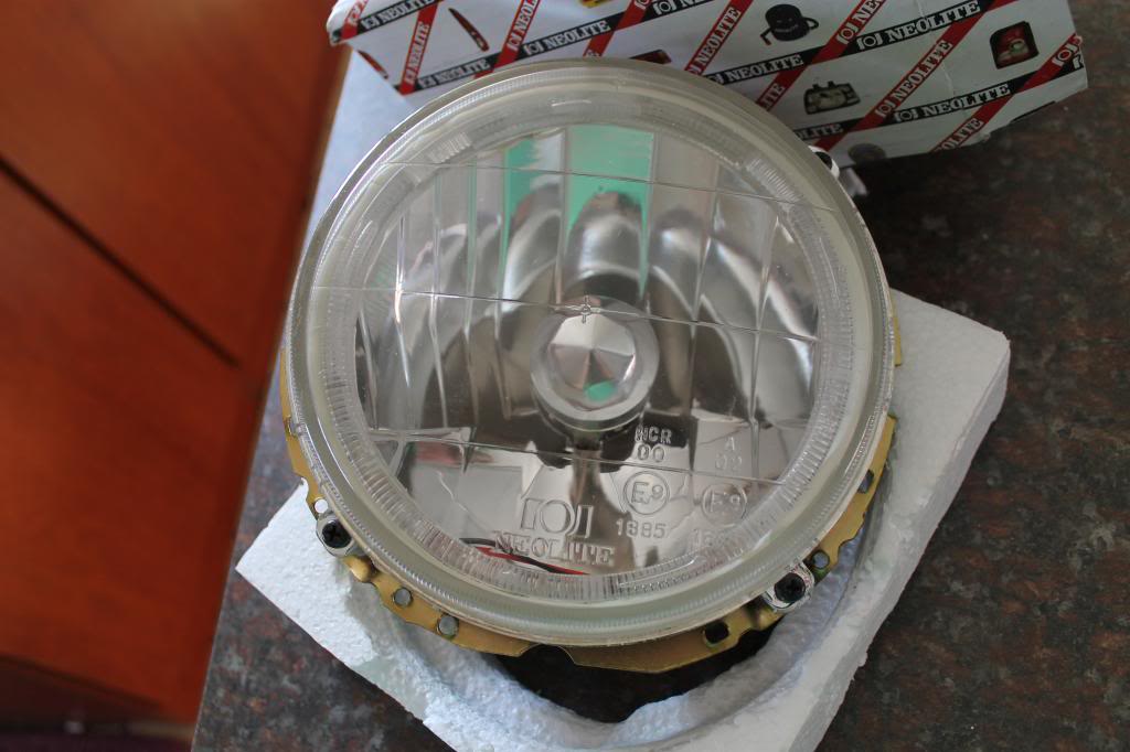

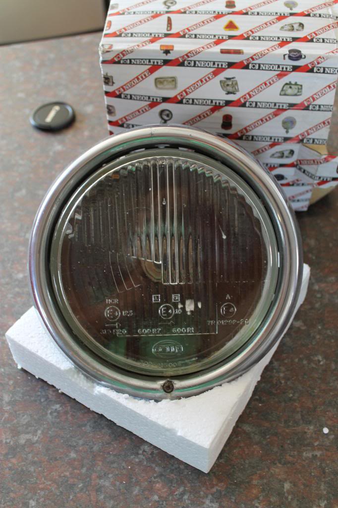

A friend of mine got me these lights as a present for helping him out, apparently they will fit a citi golf as well. Did'nt know that
and with the ring
Looks far better than this one

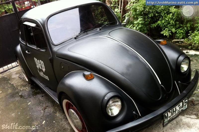

Also I have finally decided the car will be sprayed matt black like this one.
Progress in the making
Remember, if you spray matt black, you must mix all you paint in one go and spray everything all at once.
From experience with my ghia.
If I were you I would rather go for Satin Black.
Have a look at a black 350Z at your nearest Nissan dealer

Yes I heard its quite tricky doing matt black , Satin was a thought but I like the matt finish
Post by JonnoDub »
Update:

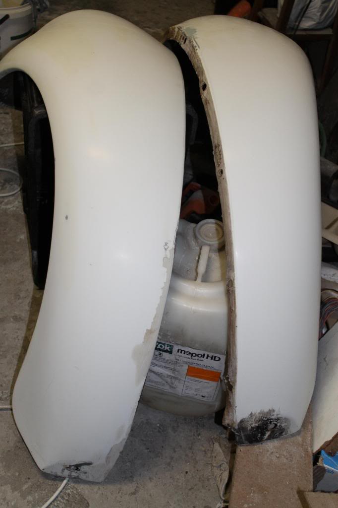

Rubbing rubbing and more rubbing! So far the front fenders are nearing completion and ready for MS primer. I worked off all the big dings that were filled with body putty after they were panelbeated. The PO must have hit some speed bumps as the part/s where the bumper goes in through the fenders were completely mangled , so far no major rust has been seen . Where I find rust I remove the flaky bits and apply NS23 from plascon , its a metal primer that stops oxidation and reoxidation(Rust). Gonna see how well it works
! I am trying to get an hour in every other night as I dont want my baby "growing roots' in the garage !
