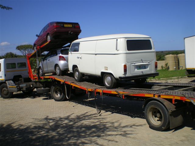

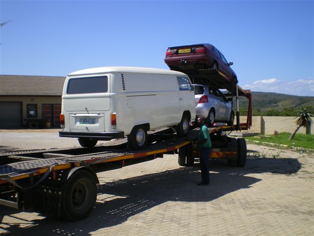

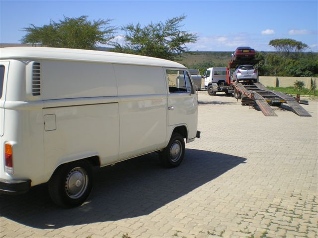

OK, so the Van has had its short hibernation, and had a great time here in Hippy town, but all good things must come to an end, and its off back home, with the "Z" Van.
Loaded her up for her final stage back home and with a tear in the eye, saw here disappear into the distance.

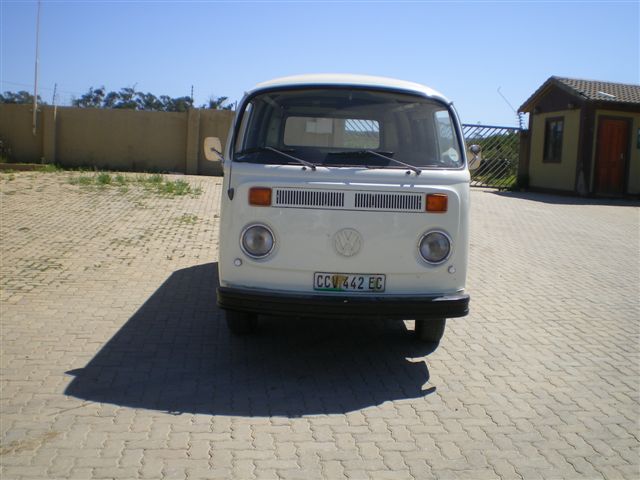

Have fun with her Mr.Z, she be a good looker.
Re: Tony Z has a Baywindow Panel Van
That Kombi needs to come to Klapmuts, perhaps a deviation of sorts on the N1 ???? :twisted:
It is such a STUNNING example
Very very nice Tony ......

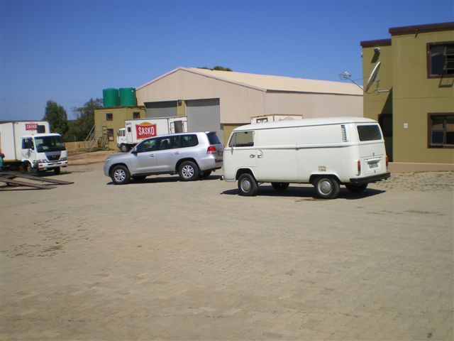

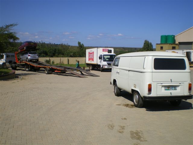

The bus was dropped off at my place a short while ago. She started up first time with a lekka puff of smoke from the exhaust. No photos or close examination yet, there is way too much going on at home to spare any attention to the bus.

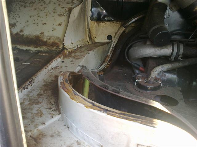

Since the bus arrived without a engine bay seal, I decided that my first option is to purchase and install this rubber.
So, after helping a fellow forum member in Somerset West, I head to grandslam on my way home and ask for a seal. I get a seal and then cannot figure out how this seal is supposed to fit.
After much online searching, it turns out that the engine bay in my German panel van is/was designed for the type 4 engine and isnt the same as the usual 1600 engine bay. It has a 1600 engine and "conversion tins".
I looked over this setup and now understand why there isnt a seal in place... to get this one right, I highly doubt you can do this with the engine in place.... so it involves removing the engine to fit a seal. I am really not keen on trying to fit the correct seal behind the fan housing or trying to line it up as it should be when installing the engine, so I went off to Pro Auto Rubber and got hold of a seal which I think will fit. I can add one half of the seal to the engine bay and the other half to the engine, when fitted the two should overlap nicely and provide a decent enough seal.... but only time will tell

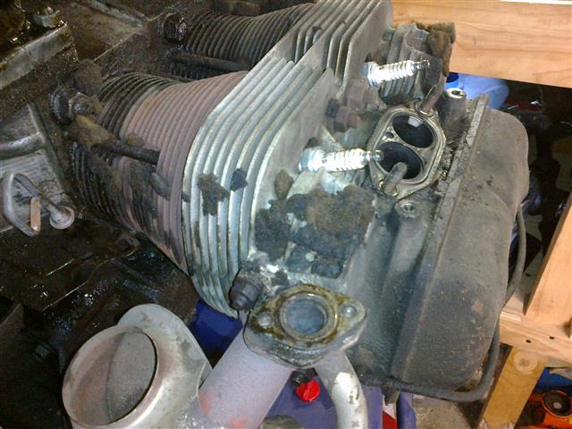

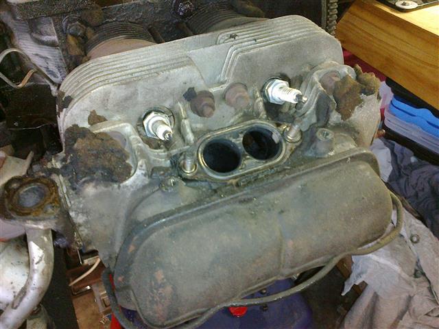

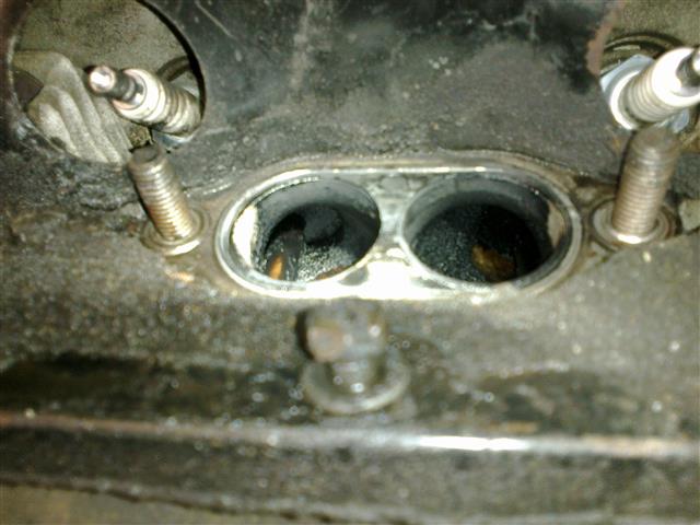

Once I got the engine out and onto the engine stand, took off the various bits and pieces to turn the engine from turnkey to a longblock.
The carb is in fantastic condition and even the choke still works properly. Anyway, after removing the inlet manifolds, I spot plenty carbon buildup in the inlet manifold, inlet ports and on the inlet valves.
I had to chisel a couple of exhaust nuts off as they were nicely seized in place and the exhaust didnt give the space to properly fit a spanner onto the nut without it slipping off.
Once getting the tins off, I found a whole lot of foam possibly from the oil cooler pressed into the heads limiting their cooling and also stuck between the barrels, stopping airflow down between cylinders.
As you can see, this foam is everywhere... I am really surprised that this engine didnt cook itself to death. I am also glad I decided not to go for a nice cruise until after I fitted a engine bay seal.
