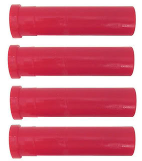

The learning Tutorial to a shockless beam,hey you never know if you read this and it works out in the end, you might of learnt something new. :mrgreen:
Uerathane bushings
On the beam urethane bushings are fitted instead of roller bearings as the urethane bushings provide friction to control the movement of the suspension. Thus almost takes the place of the shock but not completely, since your ACVW is fitted with torsion leafs (these sit in your beams tubes) your ACVW has a these leafs continually forcing its way back to its original position. Your torsion leafs are attached to your trailing arms that sit inside the urethane bushing that fits in to the tube.
and for those of you who dont know this is what urethane bushings looks like.
1972
