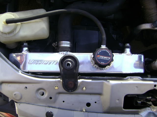

So a big update will be happening tomorro. Exhaust finally goes in. After trying to find someone to do a 3 silencer system in very tight confines, the guys that finally said that they could do it, were 5 minutes from my house.
Van Der Graff in Hermanstad. Total price for this very short, very intricate set-up - R1400, the car will be there for the day. This weekend is radiator mount mock, I was looking for the smallest possible method of cooling so that the radiator can be out back. Answer......92-00 Honda Civic VTEC dual core radiator. This full alimimium radiator allows about 30% better cooling that a stock civic radiator, yet it's 1/2 the size of normal car radiators. I'be used loads of aftermarket honda stuff over the years on my hondas and love the compact size and quality.
There are loads of knock offs on the market, but I was able to to get a genuine mishimoto at a local supplier that's been on a car for less than a month. This is a R3000 radiator that cost me a 3rd of that. There's a reason that a large jetta single core radiator from goldwagen is only R230. This gives you an idea of how small this thing is.
Total size is 50mm thick, (yeah she's beefy), 58cm long, (no problemo) and best of all, 37cm wide. So this will allow me to mount this radiator opposite the engine with a standard Honda Civic cooling fan and shroud. Then it's a visit to willem to construct the intake ducts as well as the shroud that will cover the whole front of the intake mount, leaving a hole for the radiator. The radiator will actually be mounted facing forwards slightly to take advantage of the cool air coming under the wheel well. Once these are done, I can do the expansion tank and air-intake box (stock VW polo with cold air induction)
Then it's water pipe mock up, which should take me about 20 minutes as I plan on using stock VW units with some hard lines mounted to the chassis rails. Then it's running my Honda Civic fuel hard lines. these are nice as they have all the mountings on as well as mounting clips and brackets, so it'll look neat. They are ali pieces and have insulation around them and can still be bent if need be. I paid R40 for both the main and the return, the main has the banjo fitting so I'll be able to use the small Honda Civic fuel filter, then I'll have to have a honda-to-VW pipe made up to work the rest of the way.
