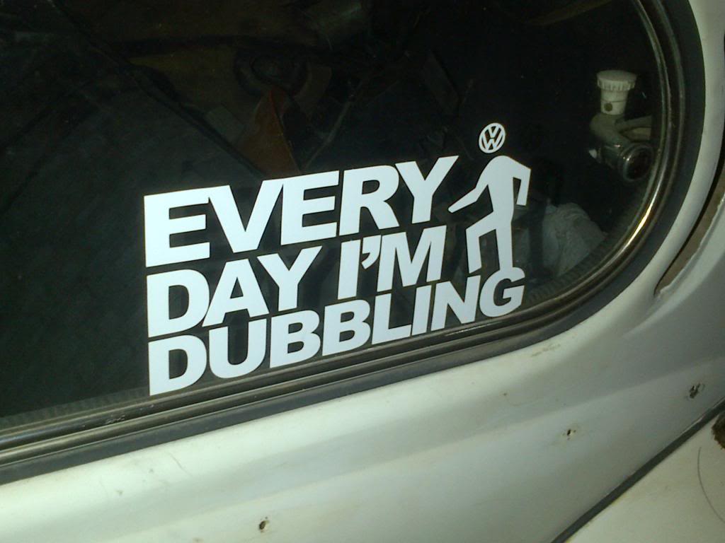

Ja so not a progress update, a bit slow on that sector
, A buddy of mine donated a sticker to the cause. Check it OUT !
