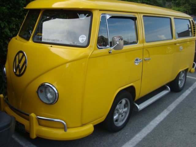

Nice, all he should do is fit big samba windows in the roof to match the side window size...
