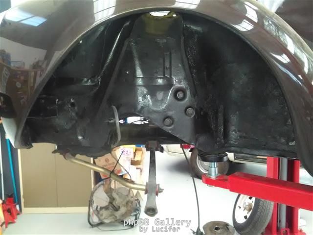

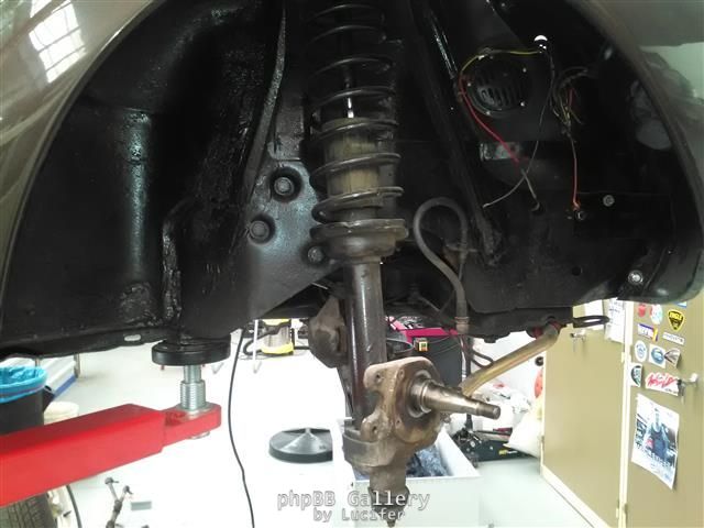

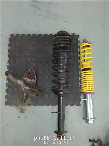

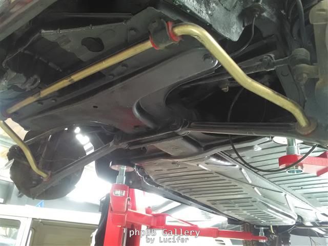

Then to add to Terry's question about the difference between the 1302 and the "normal" beetles...
Have a look at the following pictures of the front suspension and compare them to the front end of the normal bug

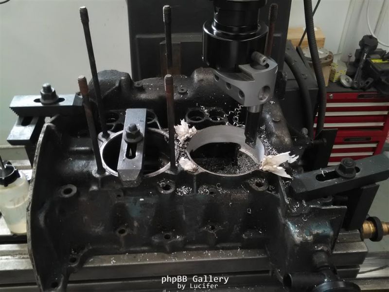

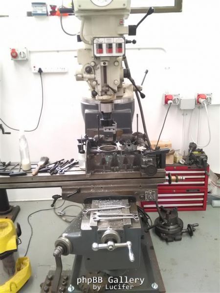

I am going the type 4 route with this one. The block is supposed to be nearly bulletproof, but amazingly, I have bought and then resold 3 cases before finally finding one that I am happy to use for my project. Maybe I am just trying to be too perfect.
So far, I have opened up the case for the barrels I am planning on using as well as cut the case for the cooling system.
It seems I didnt take any pics of the cooling system mocked up, but here are two of the cutting for the barrels

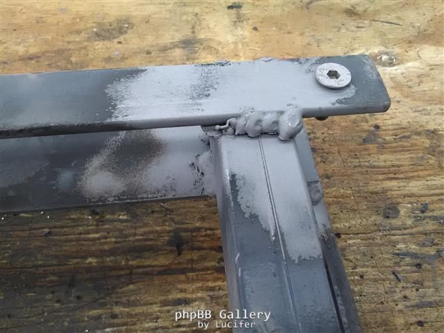

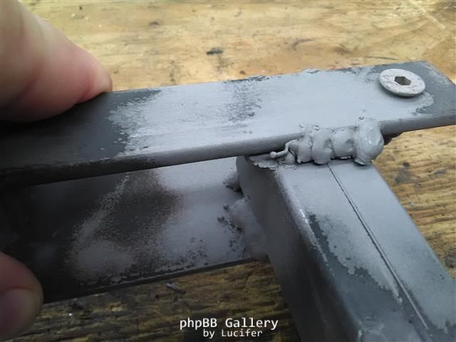

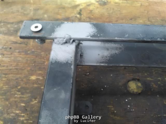

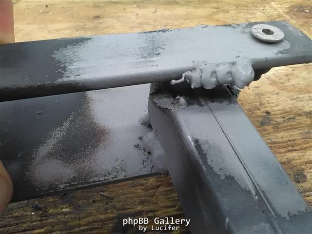

Another thing that I double checked a short while ago was my custom made seat mounts to fit my new seats.
I sent the seats up to JHB when the car was first getting done so they could be fitted properly.
Well, you draw your own conclusions as to the quality of the work that I got back.
And no, I didnt need to use a hammer to break those welds, they came pre-broken. I'm glad I checked this one...
Needless to say, I still consider myself more of a grinder than a welder and even though my welding is pretty poor, the end result (no picture) is much stronger than what I started off with. Ugly, but better.
Doesnt help using stick to join 4mm flats to 2mm thick box section... thats my excuse and I'm sticking with it.

Even I can weld better than that I actually cant believe they would allow work like that leave their shop its a disgrace hell no man.
So now Turning Tony when can I book a ride in this here car I am getting jealous now with all the things you are fitting except those seats. Looking good I must say wish I could be there to see the progress. Oh well they have just blown up a substation up the road no Power until tmrw missed F1 qualifying. Thanks for the posts Tony interesting I must say.
