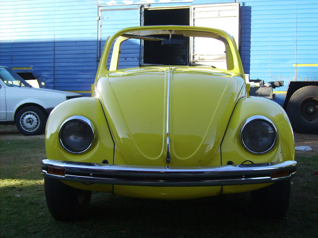

Finally after threatening the glass guys I piced up the 1pce window glass today so that can get fitted and the bug can go to the upholster for the roof
Also started on the front end got a spare front h beam and cut and welded the adjusters in with my Co2 and smoothend the welds nisely coz before I welded them in I chamferd a nice V between the Beam and the adjusters that just gives a better penetrating weld so that is done
now to clean all the old ghries and shit off and paint it and assemble with all that nice goodies I bought for it a while back
Will put some pics up of that in due time
Here is some of the slow progress

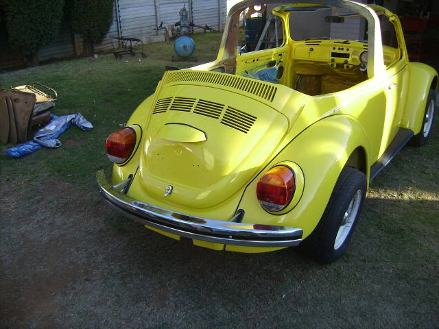

Wow a momth has gone by since I did something on this bug
Well after batling basically the whole dat till 3pm with the import 1pce rubber kitt there is a shit load of prepping to be done to get this rubbers to fit in the guids and stripping the ends to curle up and the clips I had a humur failure
I wanted to have the scraper rubbers inn aswell before the bug goes to the Upholstery guy for the soft top so I just fitted the Back guide for the window and fitted the glass and lined it up all the way wound up
So will have a go at it another day that was to much for one day
The front top part of the window frame I will go and find some u rubber of some new cars to neaten it up coz if I`m going to fit the normal bug u felt it stick out to much and will look very shit
The front end I painted and I have built a bracket that fits on my engine stand with a cut off front piece of a rusted old chassis and bolted the H-beam up to that so I could assemble all the electroplated goodies to the beam and all the urethane bits with the thicker anti roll bar with the vented crosdrilled discs
Will keep you guys posted
