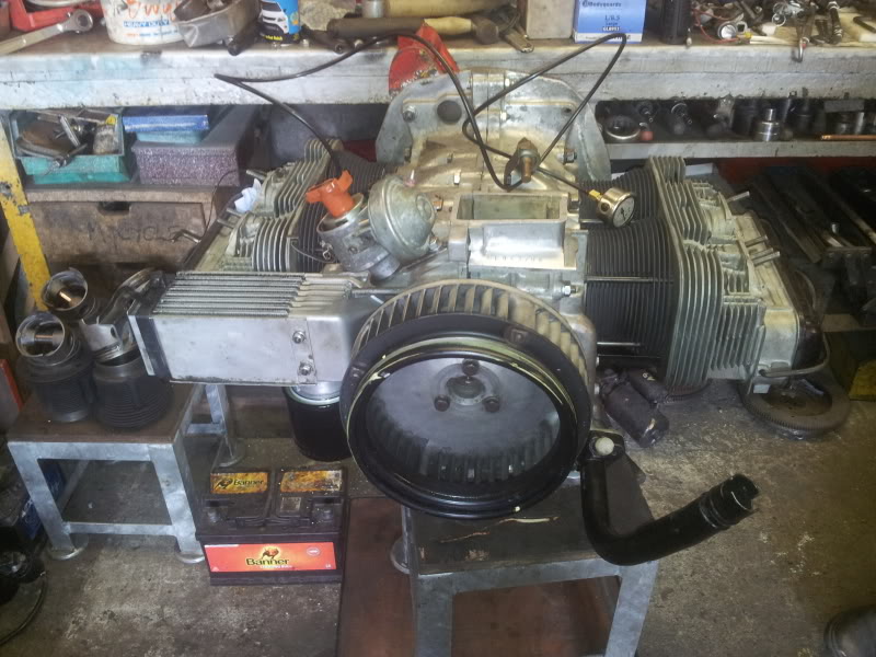

Hi Chris

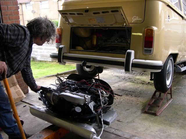

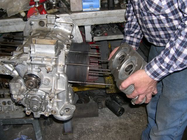

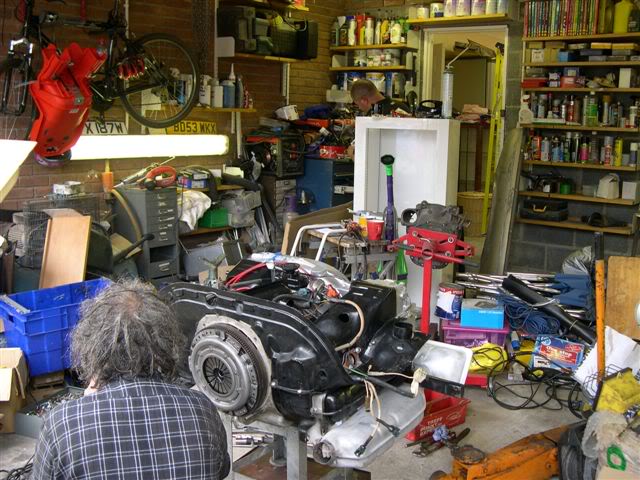

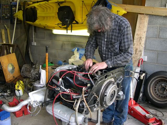

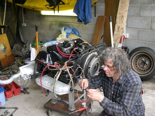

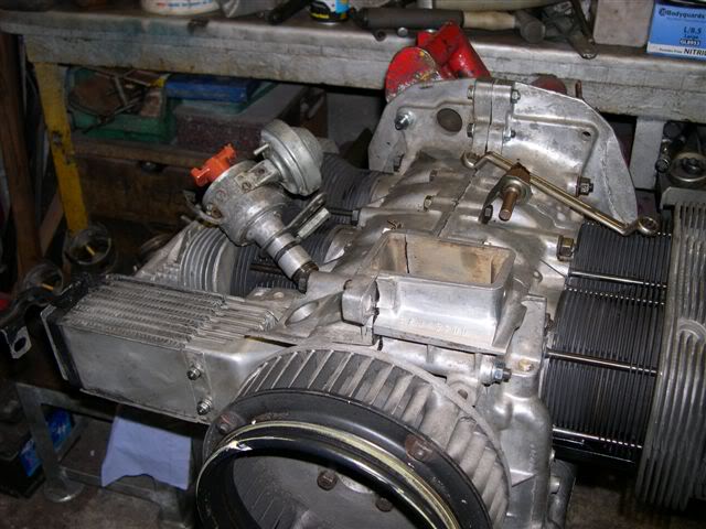

I made good progress last night, fitted cooler, filler, filter, new
followers with break in paste, then push rod tubes, all additionally
sealed.
Fitted rockers and push rods, installed distrubutor drive shaft in
correct mesh to achieve the timing for no 1 cylinder, then the
distributor.

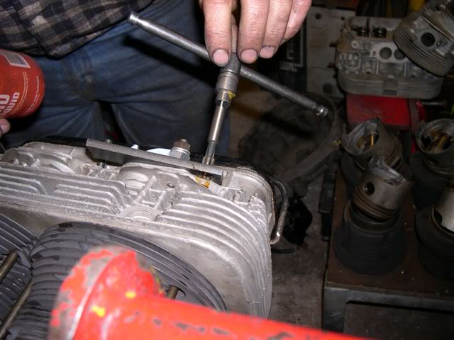

Proceeded to set the pre-load on the tappet adjusters, two turns from
clearance and then re-checked.

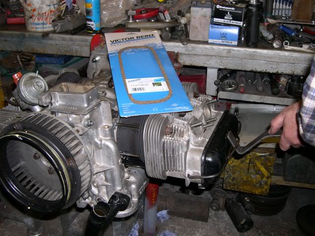

Cleaned the rocker covers, fitted new gaskets and clicked up.

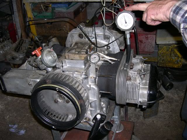

Filled case with 15/40 oil, spun engine over - all OK.

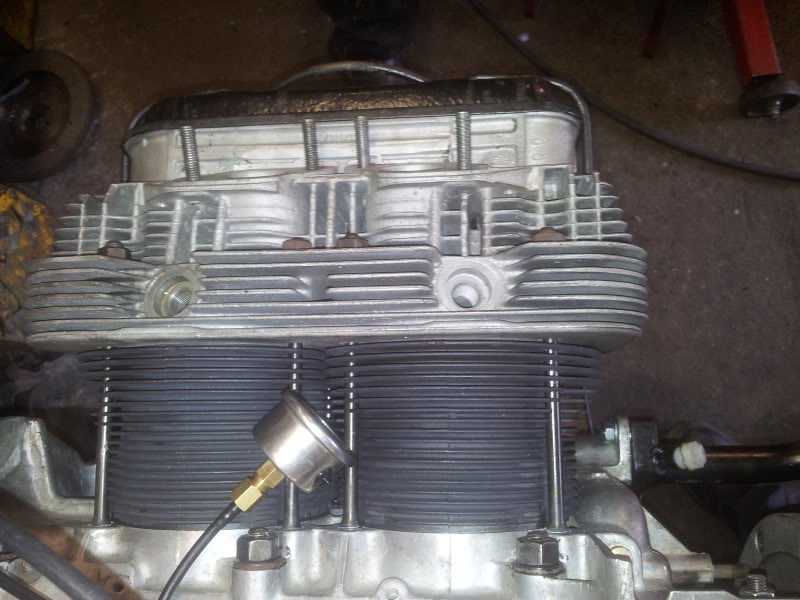

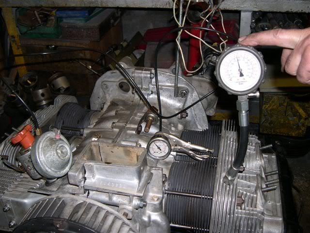

Connected master oil pressure guage, 40psi on starter speed, very good.
Tested compressions, all at 140, excellent for first reading.

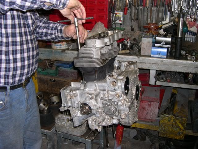

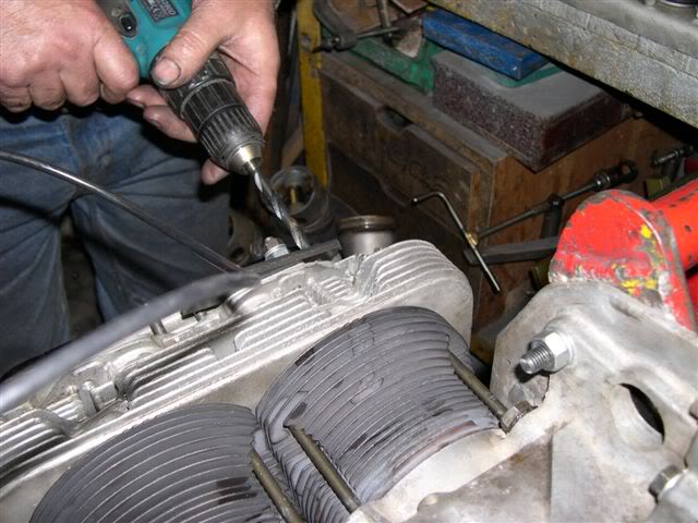

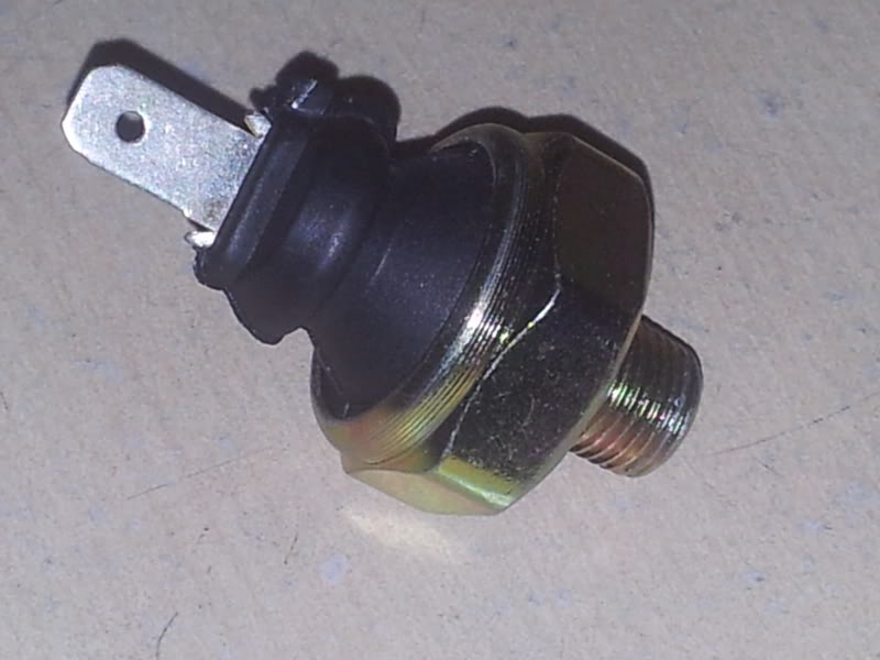

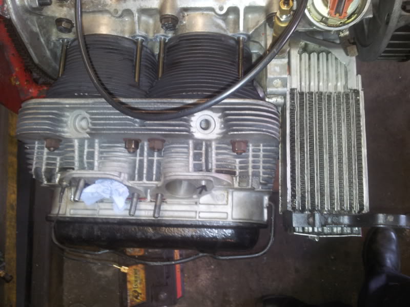

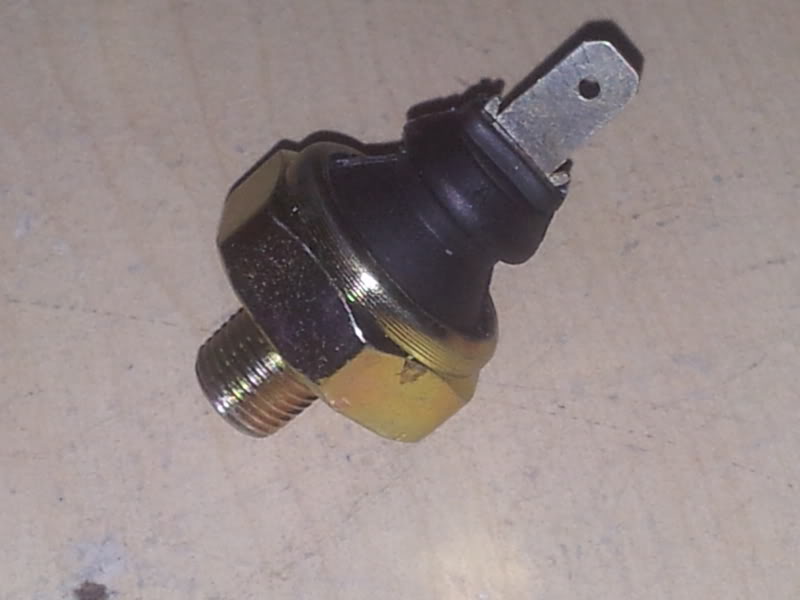

I had to re-tap the head on no 3 to a metric fine pitch to accept the
heat sensor, as the heads that were used did not have the threaded
provision for the fuel injection heat sensor.

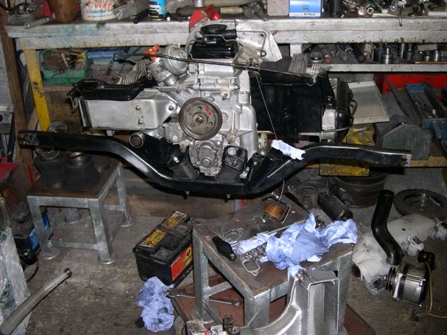

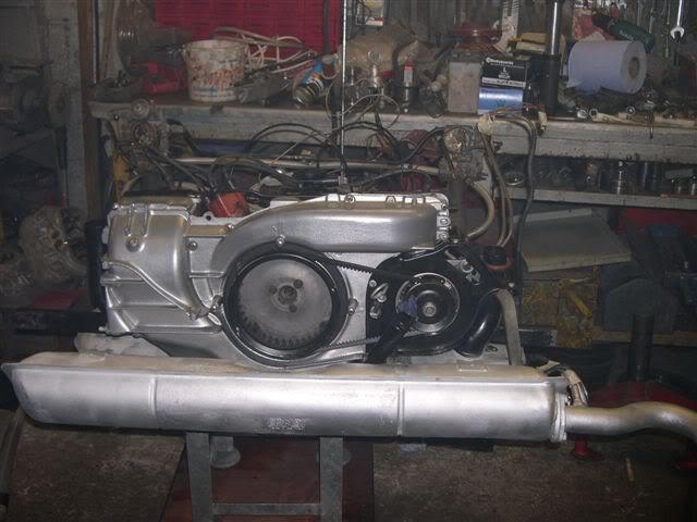

Today I can fit all items - fan, tinwork etc - ready to bench start it.
Keep you posted
