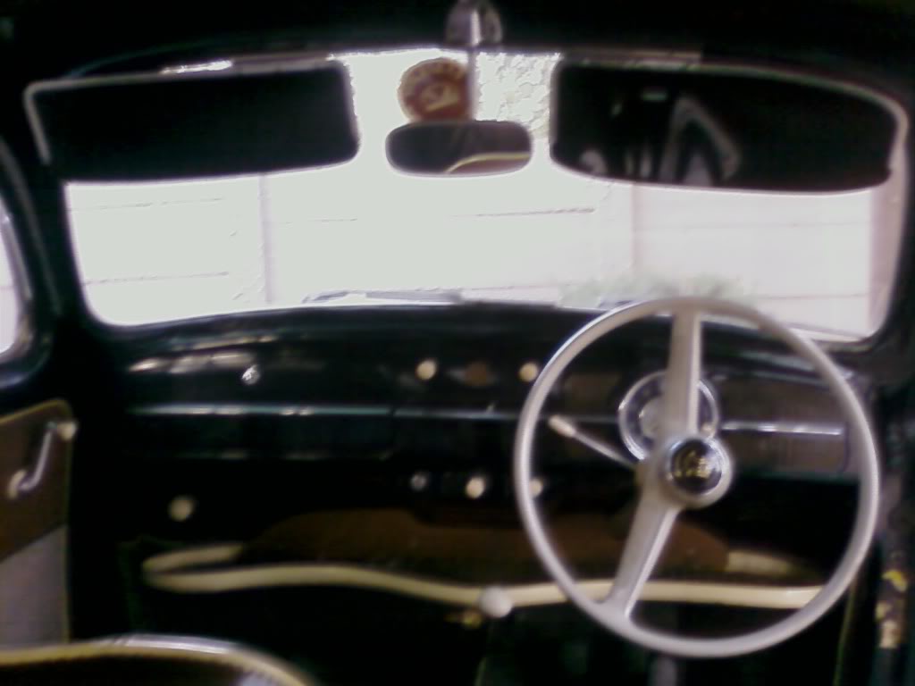

Rudi, your note that the passenger visor was an extra in the fifties got me thinking. Perhaps if the left does not match the right exactly it wont be the end of the world in the interim. As they never would have looked the same anyway. Got home with a little light left and fitted the the new visor and then the assembly. Light was bad so this pic is very poor (its all planned to make it look vintage :-) ), but let me know what you think?
Also fitted the new wipers afterwards.

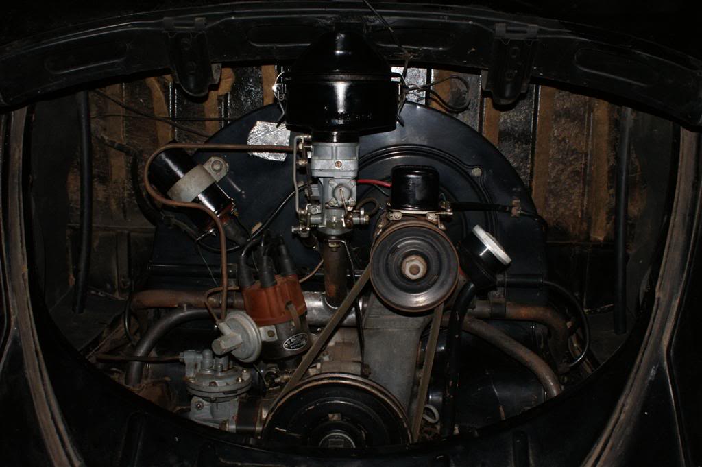

One thing that bothered me from day one is that air filter that looks like @#$@#. I'll refresh your memory:

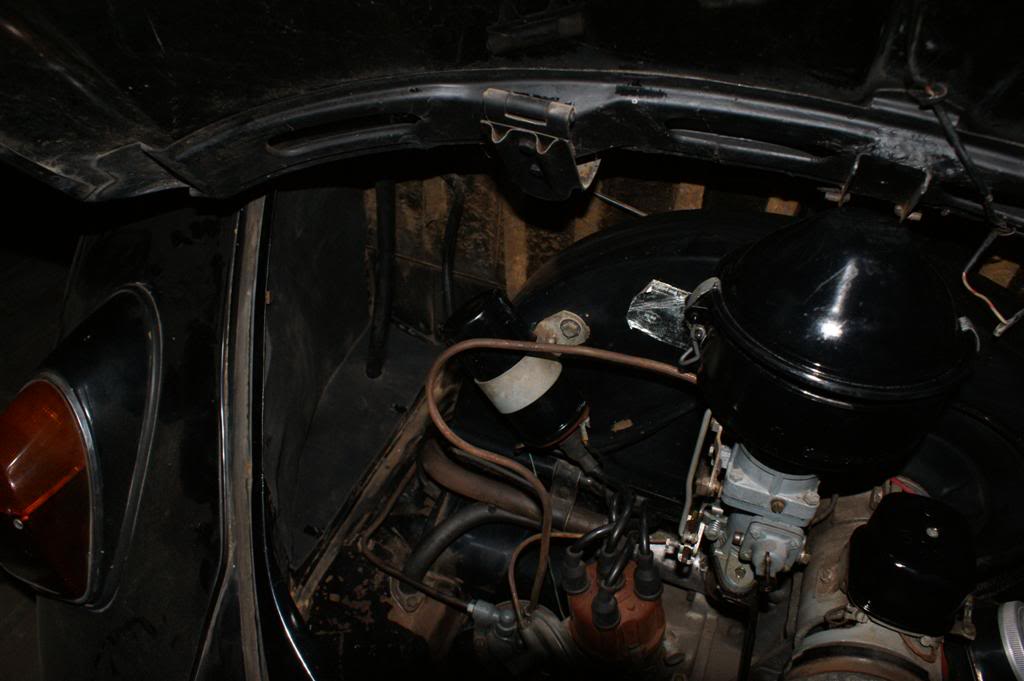

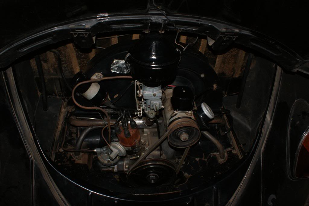

So out comes the air filter, and I figured while I am at it, lets take out the voltage regulator and touch that up as well.
First clean with petrol to get rid off all grease and oil, then wipe down, light sand with fine grit sandpaper just to give the paint something to cling to, and to get rid of any surface rust.
Three coats gloss black later it looked a lot better.
These two looked pretty good (not perfect, as I am a novice), also realized that I should have sanded the whole thing down to bare metal, then primered and only then painted if I wanted that perfect finish.
Once these two items were almost done, I couldnt leave the coil looking all tatty, so out it came.
Since I was busy, I also removed the old firewall, then cleaned the engine bay.
Fitted the new firewall on the sides of the engine bay, but it got too dark to attempt to fit the main rear firewall section.

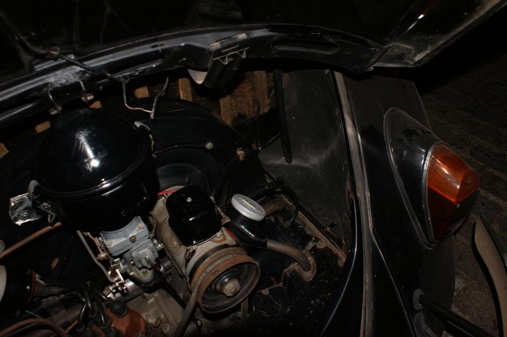

Replaced the coil, regulator cover and air filter, but when I wanted to move her to the garage to start with the firewall main section, she wouldn't start. I am hoping its just a loose cable or something.
It was a little dark, but you should be able to see the new firewall bits and spraypainted parts. The new firewall sections are a little dusty, will clean those once the whole job is done. The brownish stuff on the rear firewall is the original felt sections they used for sound deadening (I am guessing), and they are in good shape, so I figure I'll keep it there. All the original steel tabs are still intact to reattach the firewall, so before resorting to glueing it, I'll try to reuse them. Good news is that there was no rust ANYWHERE. The engine tin looks like it was installed just the other day :hangloose: Also found two cotton triangles in the corners of the engine bay behind the left and right firewall sections. I supposed they were there to help suppress noise to the inside of the cabin?
Is it worth taking off the pulley to respray, or can I mask and do it in place?
Your thoughts on anything else I should consider, anything I did right/wrong?

Re: the new firewall cutout section going at the back - I stand corrected, but I have heard many times of overheating problems arising from not gluing that main section of the firewall to the rear metal. If it's not 100% secured, the suction from the fan housing (just in front of where the firewall cutout section is to be attached) causes it to be vacuumed onto the fan hosing opening which hinders airflow and causes the engine to overheat.
Just a thought.

Take heed of Gavin's advice concerning the firewall material. You dont want that engine to be damaged by overheating due to material in the fan. Those little cotton triangles just limit the noise inside the car.
I will remove the top pulley for repaint. It is so easy to remove and put back. The bottom one is also not that difficult if you have a puller.
