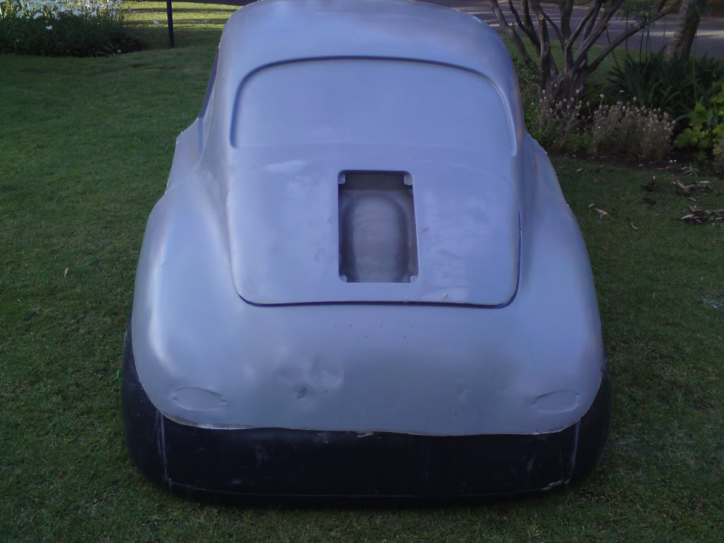

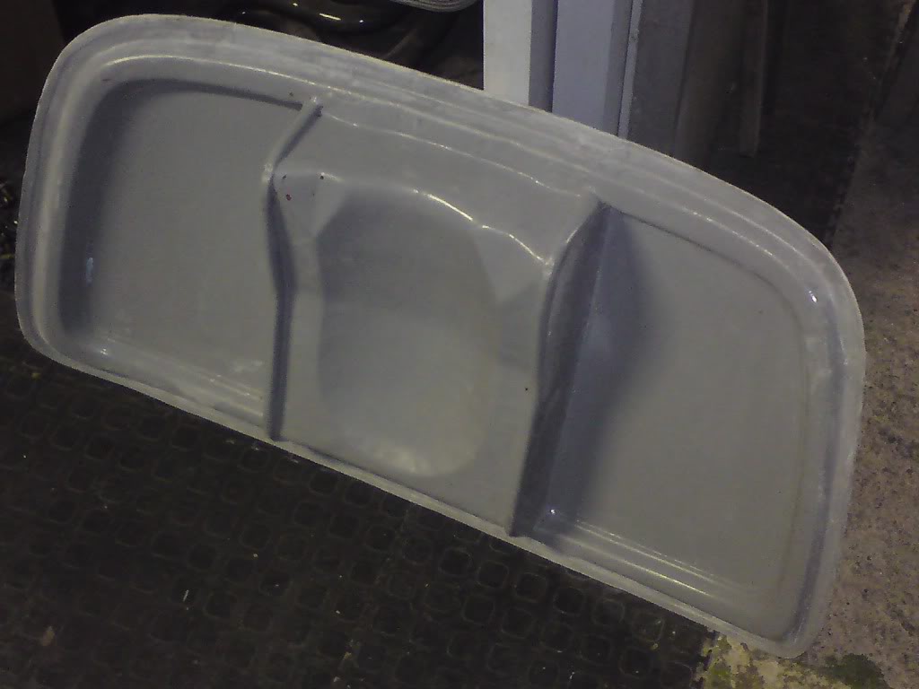

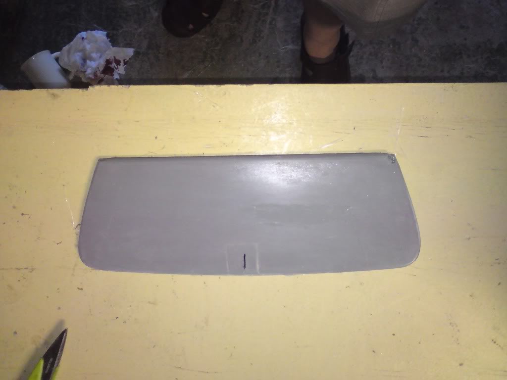

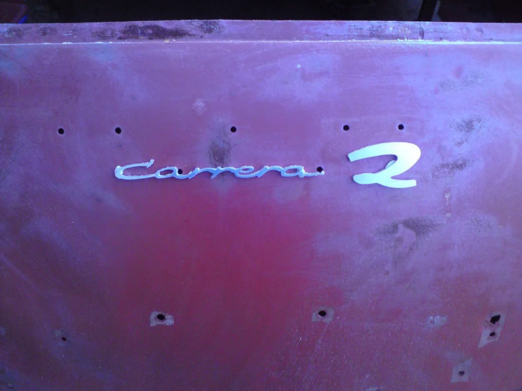

A little happened during the weekend The first decklid is made and the dash modified to rhd just needs glassing and finishing the cubby hole lid is also done and so is the sills. a good friend facilitated the making of Carrera badges and here is the result :D

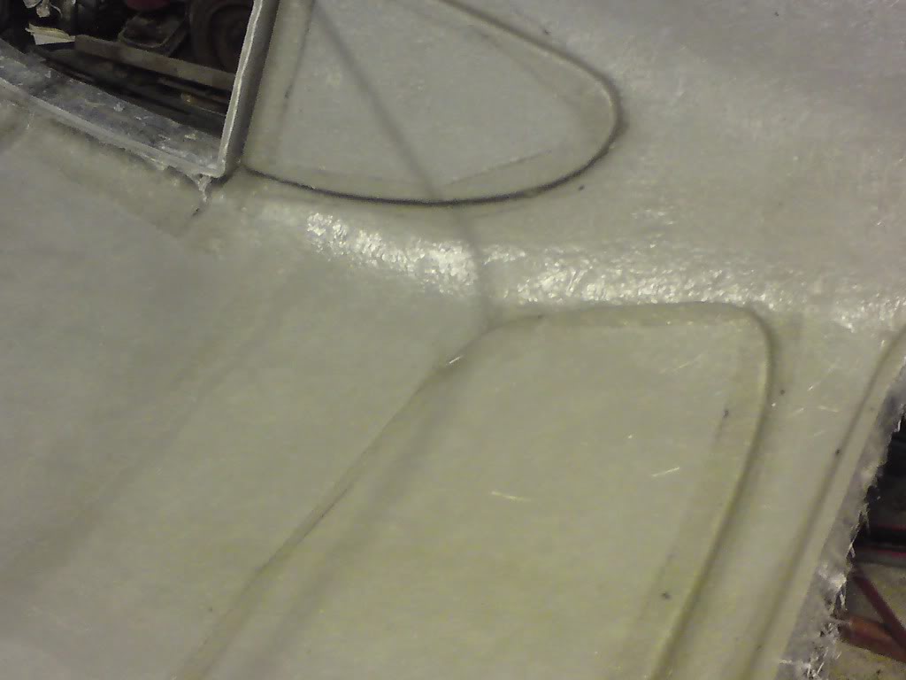

I also added the first of 3 layers of glass to the roof this is done slowly on purpose in order to minimise warpage in my temporary mould

Foto's wys nie hoeveel werk daar in daai paar prentjies ingegaan het nie!
Keep it up and keep the pictures coming.
With a Carera 2 badge, I am now VERY curious as to whats going to go behind the back seats.... :D :shock: :twisted
Can't wait to find out.

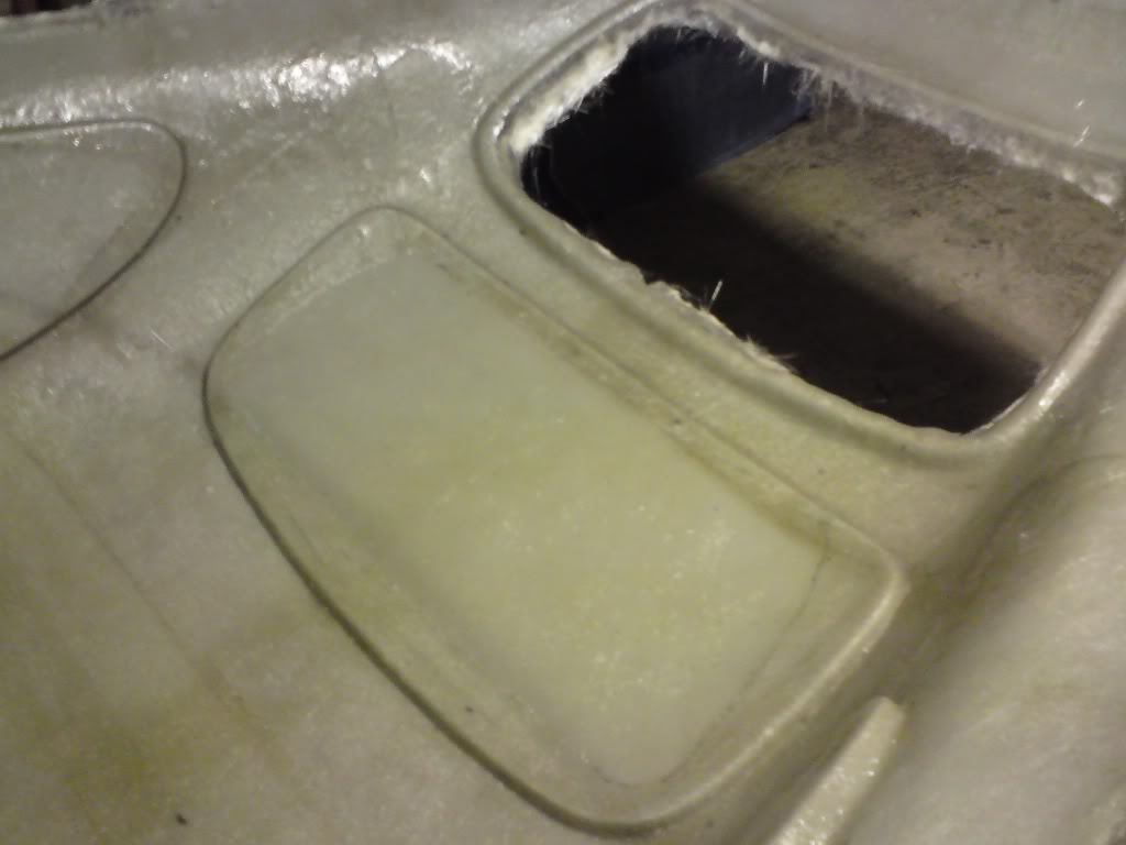

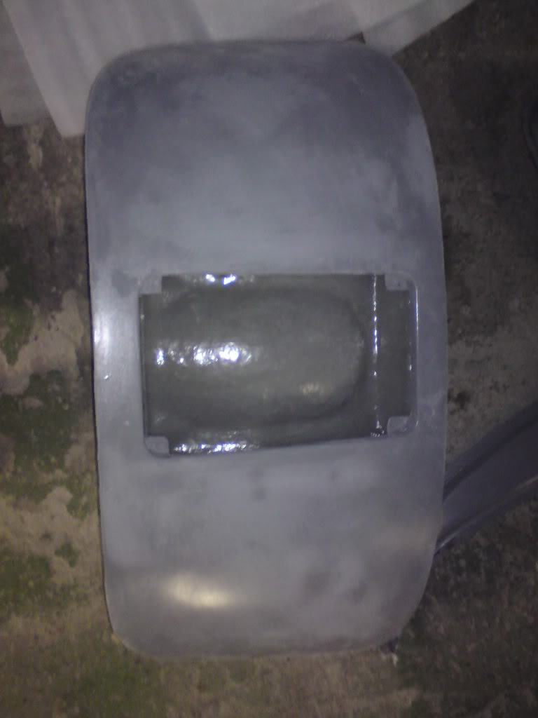

Idea
From the 356 conversions i've seen, the engine lid is a double skinned fibre glass item.. Personally i think it'll look great if you smooth the inner part, the area where you see through the top mount engine grill..
Its just one of those finishing touches i think will set it apart from other 356's

look at these photos Carrearas had an inner grille as well
http://gallery.mac.com/tomdewalt#100043

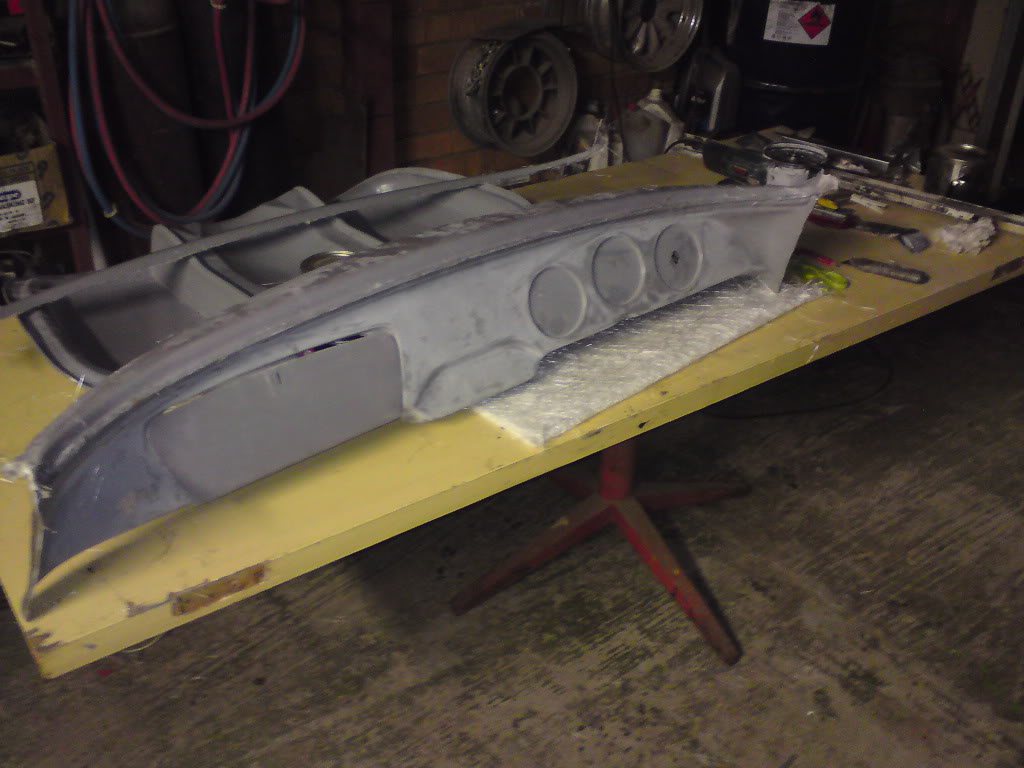

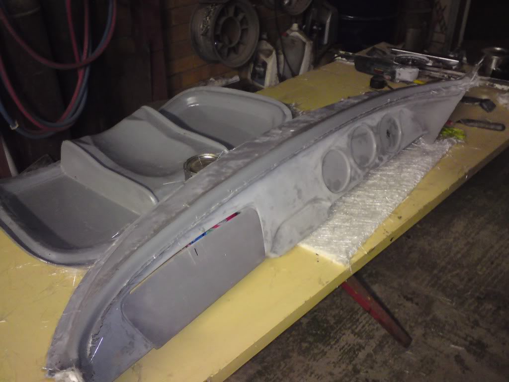

Well the new roof has now been done in the mould and will cure until the weekend I will probably pop it out and try for first fitment.
it is done in 400 gsm mat with 3 layers to complete. I might use core mat for future mouldings.

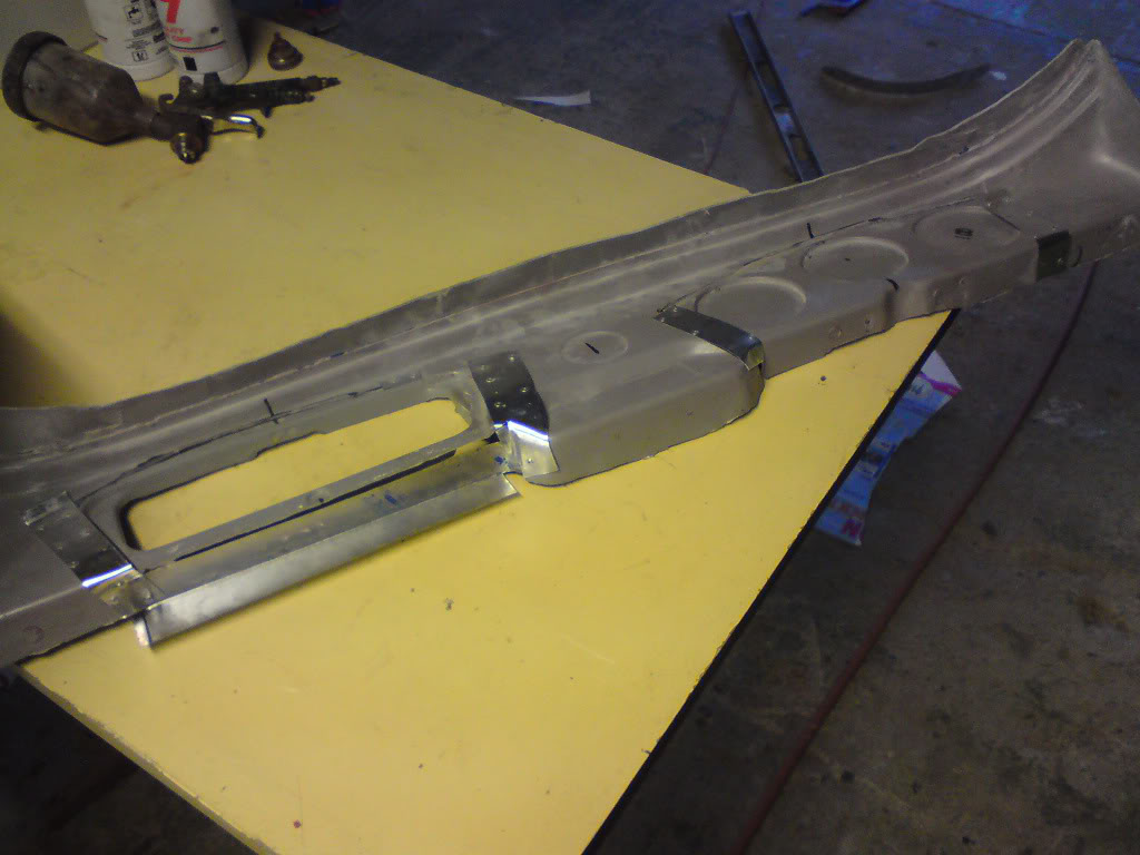

the two dash pieces as well as the right hand drive conversion is now together and ready for final work
Since fiberglass does not like radiuses of less than 8mm the way Porsche made the dash was a no when replicating it in Fiberglass thus I made a extra upper mould which would eliminate the porsche ridge. As this is covered by the dash pad it will be invisible to the observer.

IMPI wrote:Well the new roof has now been done in the mould and will cure until the weekend I will probably pop it out and try for first fitment.
Armand
Its looking great! Are you using a cross strand weave or cut strand type mat?
IMPI
Posts: 1897
What model do you have?: sp2
Been thanked: 78 times
Re: TOY 356 NW
Post by IMPI »
Hi I am using chopped strand mat 450gm sqm not the 400 I was talking about and nade by Owens corning the resins are NCS

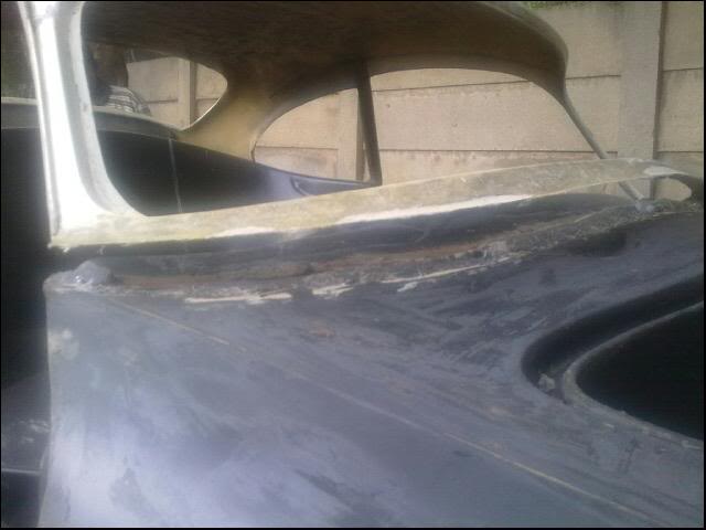

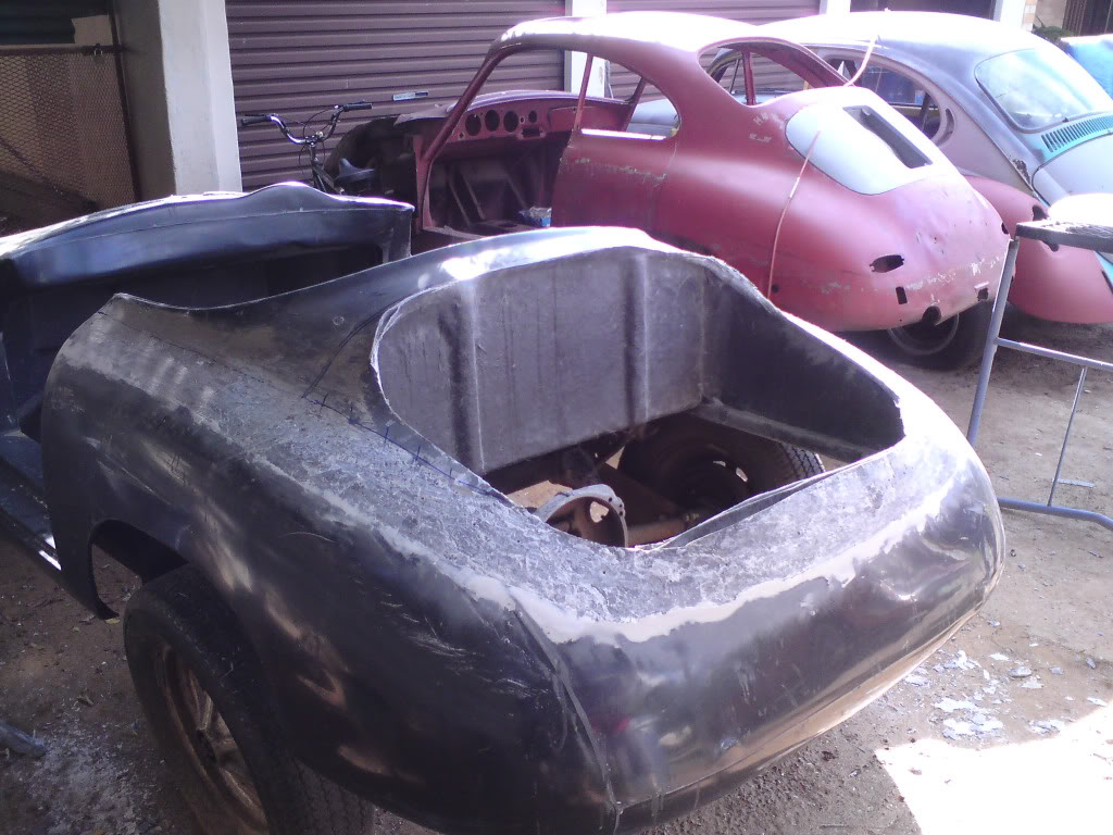

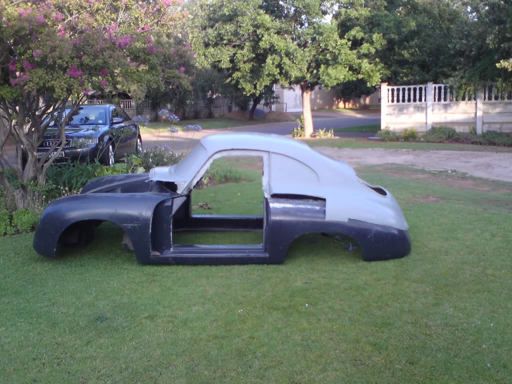

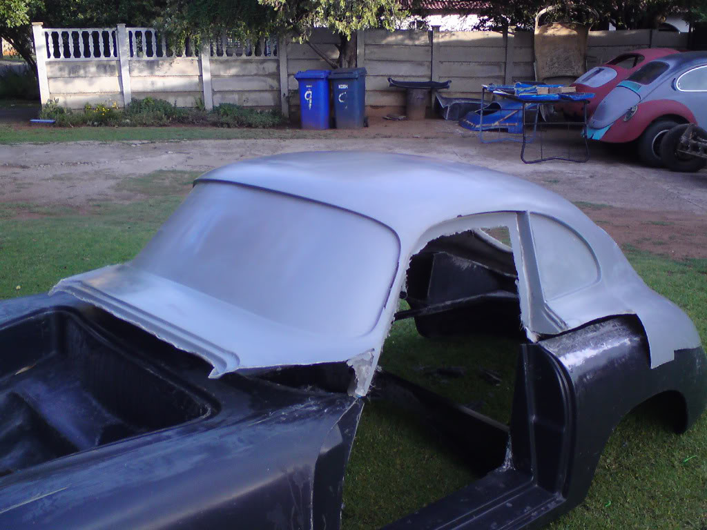

A lot of things has happened this week.
When removing the old roof the thing sprang up an assumed the right shape no wonder real doors and windows wouldnt fit.
With the roof finally removed
the new roof came out of the mould ok but the mould split in a few places as it was only built for this one roof
The big task is now to trim the two halves in such a way that I end up with a whole that is square and usable
Armand
