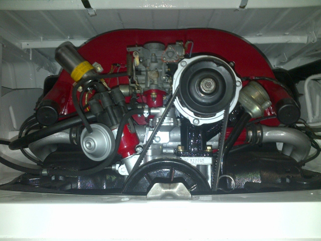

Think you need looking at the non-return valve that is inline, they always give trouble, I had to rework mine to make it work.

Looking awsome, nice job, I noticed in the pic. that the tin that guides the hot air from the oil cooler out of the engine compartment is missing, hopefully it was fitted prior to the engine going in otherwise you going to recycle hot air, and will lead to a overheating.

Eish, I have no idea what's wrong with the booster, think it's not working at all.
Brakes are good but the pedal is hard.
Will find out about the stuffiies around the engine and overheating, I know that some bits and parts
didn't work and were blocked off, not sure but think it's something to do with the heater.
I'll be back in Gauteng next week Friday, hopefully everthing will be sorted by then.
Thanx for the advice, I realy appreciate it, will let the mechanic know what you guys said.

Where is your brake booster getting air from.
There should be a pipe that runs from the booster all the way to the inlet manifold of number 3 and 4 piston.
You should see a place on the manifold for a pipe fitting to screw into.
I cannot see this pipe on the pictures of your engine in situ.

Dave, I think that the pipe under the carb, passing the back of the distributor cap, is the pipe for the booster.
But the pipe looks new and in one section, and no sign of the non-return valve in the pipe. The non-return valve is a plastic valve that slides into the two ends of the pipe that is cut near the booster.
Also, the other side of the booster, must have an filtered air intake, that is un-restricted, to allow the booster to do its work.

Squire
I have never seen that before. Surely though the fitting from the inlet tube would be to small for that size pipe.
Therefore I ask the question - Is the booster getting enough air from that point, never mind the non-return valve.?????????????????????????????????????

Good point....

OK, I was picked up from Lanseria airport in my bus!!!
She is running and going like a Kulula Boeing.
A Golf 2 booster was fitted and the brakes are 100%.
She is going back though, when you come to a stop/robot the engine cuts out and there is an oil leak between
the engine and gearbox.
I know that the next few weeks will be trail and error, sorting the little things till she is 100%.
Thank you to each and everyone for your advice, it really helped a lot.

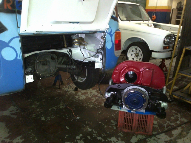

WOW!! Hallo all.
After nearly seven weeks our internet is up and running again after a veld fire destroyed the main cable.
My beloved Priscilla is at the garage again, a seal broke and the engine sucked in air that caused her to stutter and splutter - fixed
The brakes on the right hand side leaked brake fluid and the part on both sides are in the prosess of being replaced.

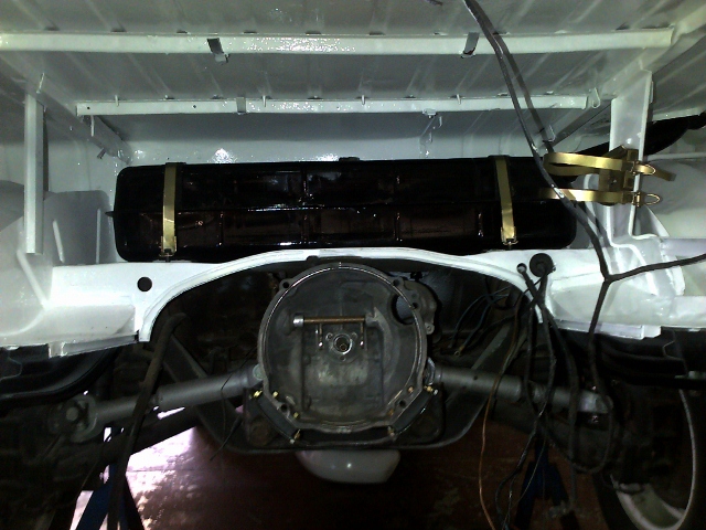

Had a fuel leak, the tank cracked where the filler pipe enters the tank, engine is coming out to get the tank out to braise the crack.
The speedo cable broke and was replaced.
The barn doors didn't lock, the bottom was rusted away - fixed.
