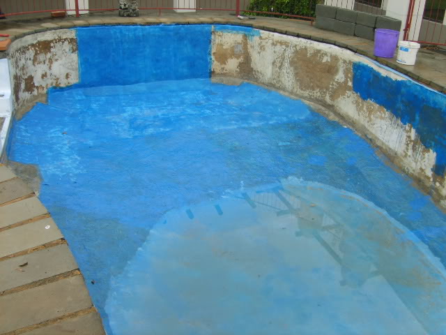

My job is much easier than yours with less contours and frills but still bad.This is what Im busy with -
about 100 sqm to be done. I only started early in the summer due to other job commitments and now Im battling with the rain.
Doing one layer of 450 gm and a layer of resin as a paint layer and then when winter comes Ill put one or two layers again
Doing it all on my own –even the almost 6 tons of concrete that went in the floor.
But hope fully by Christmas we will be swimming

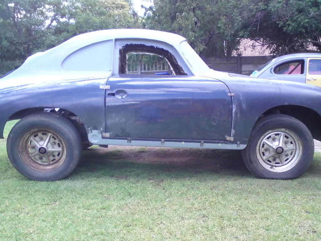

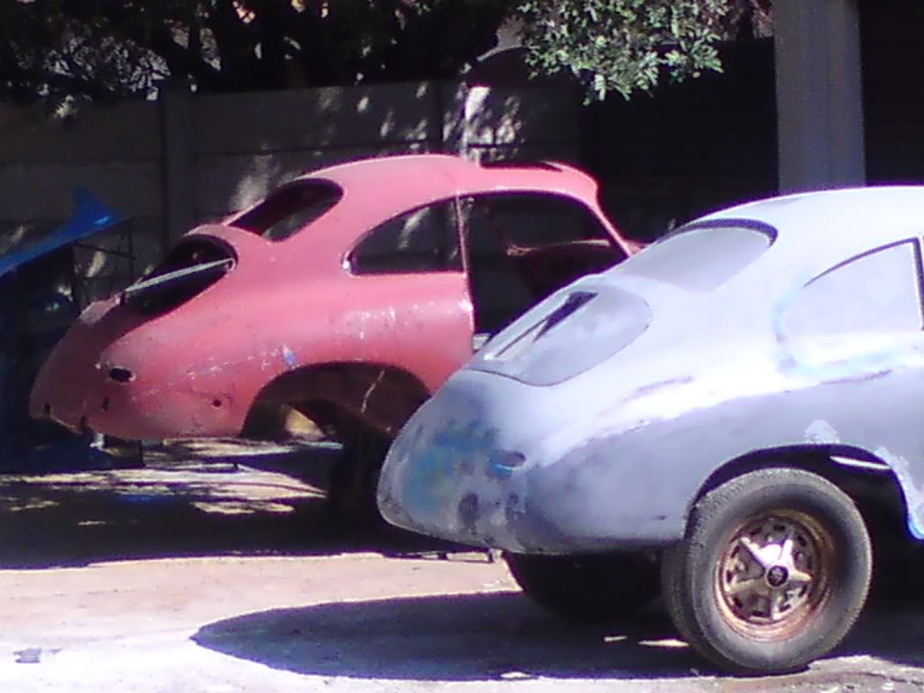

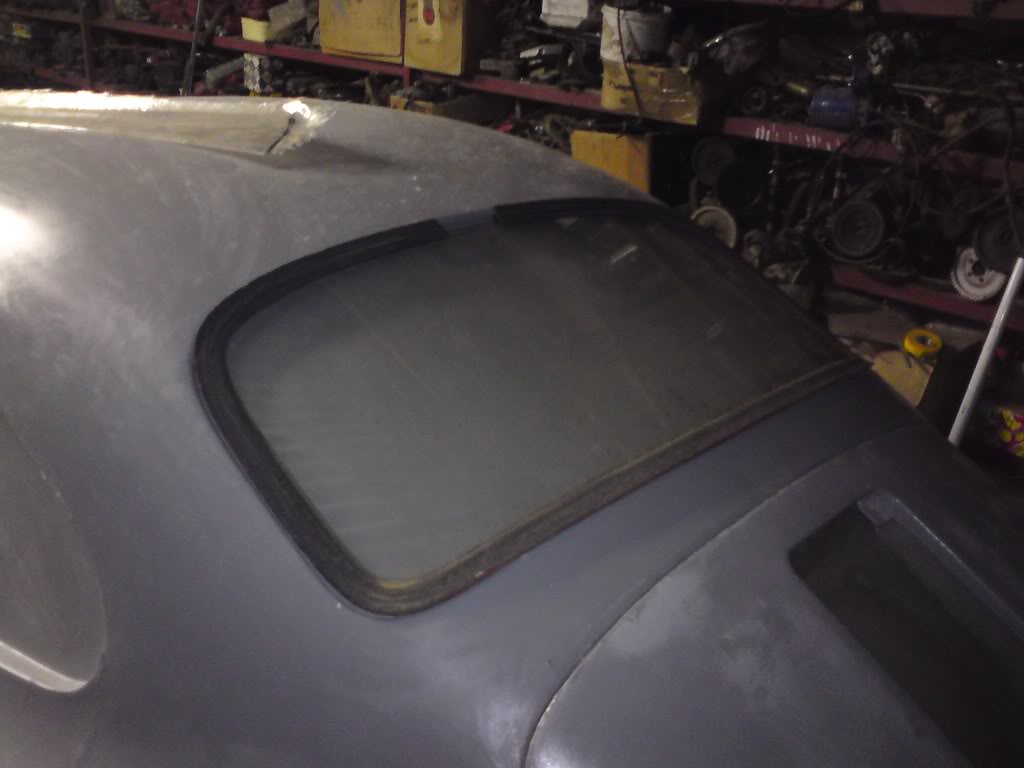

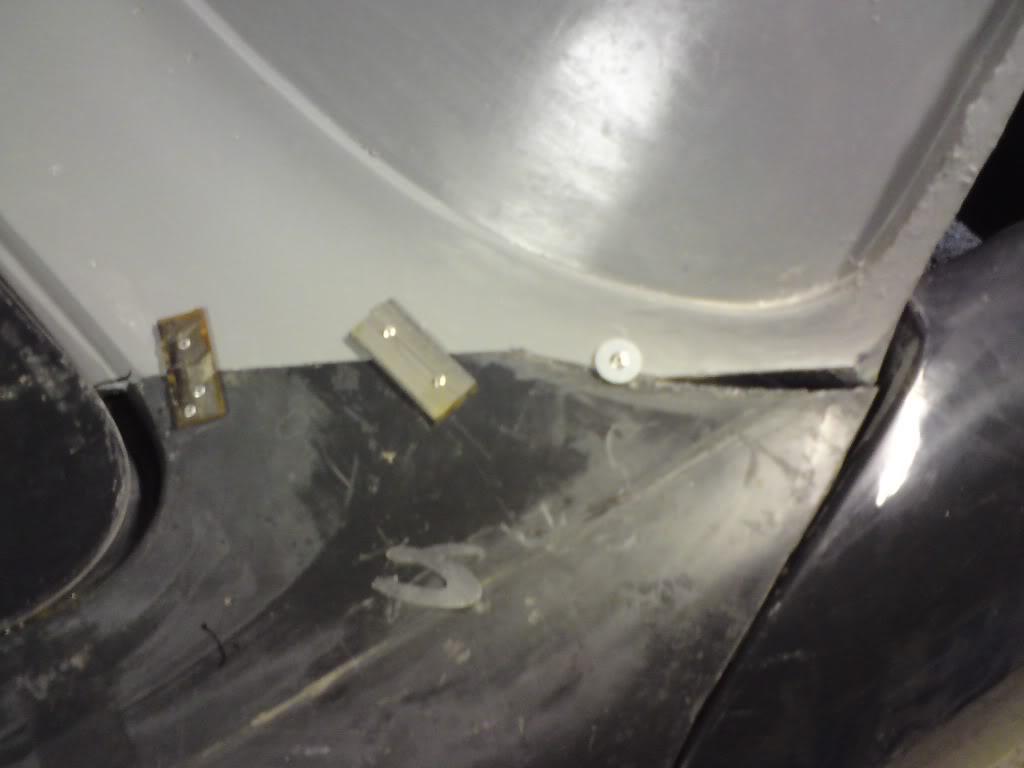

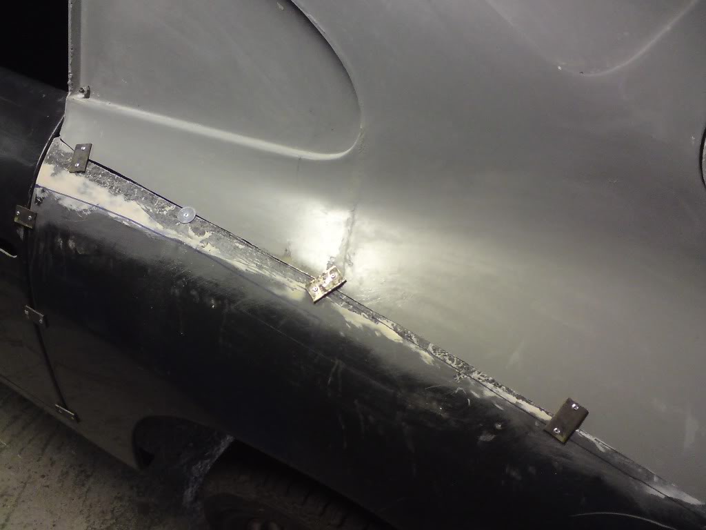

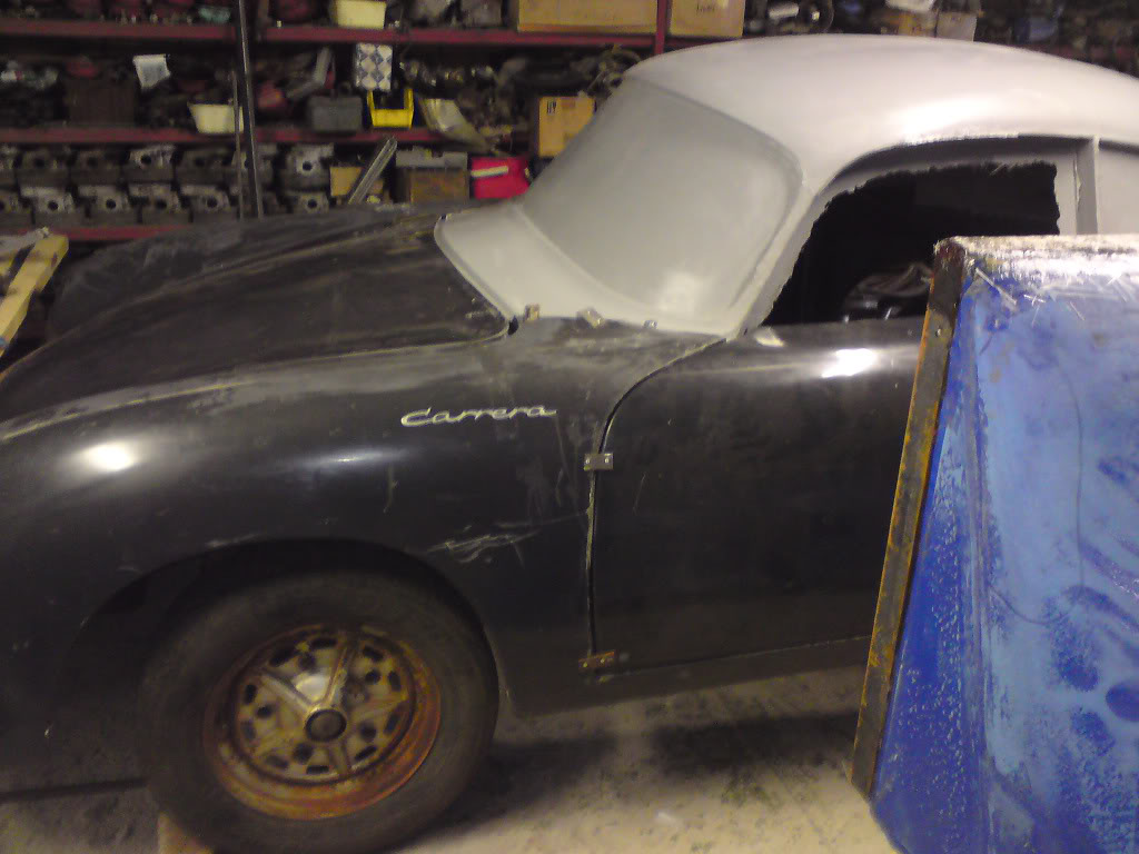

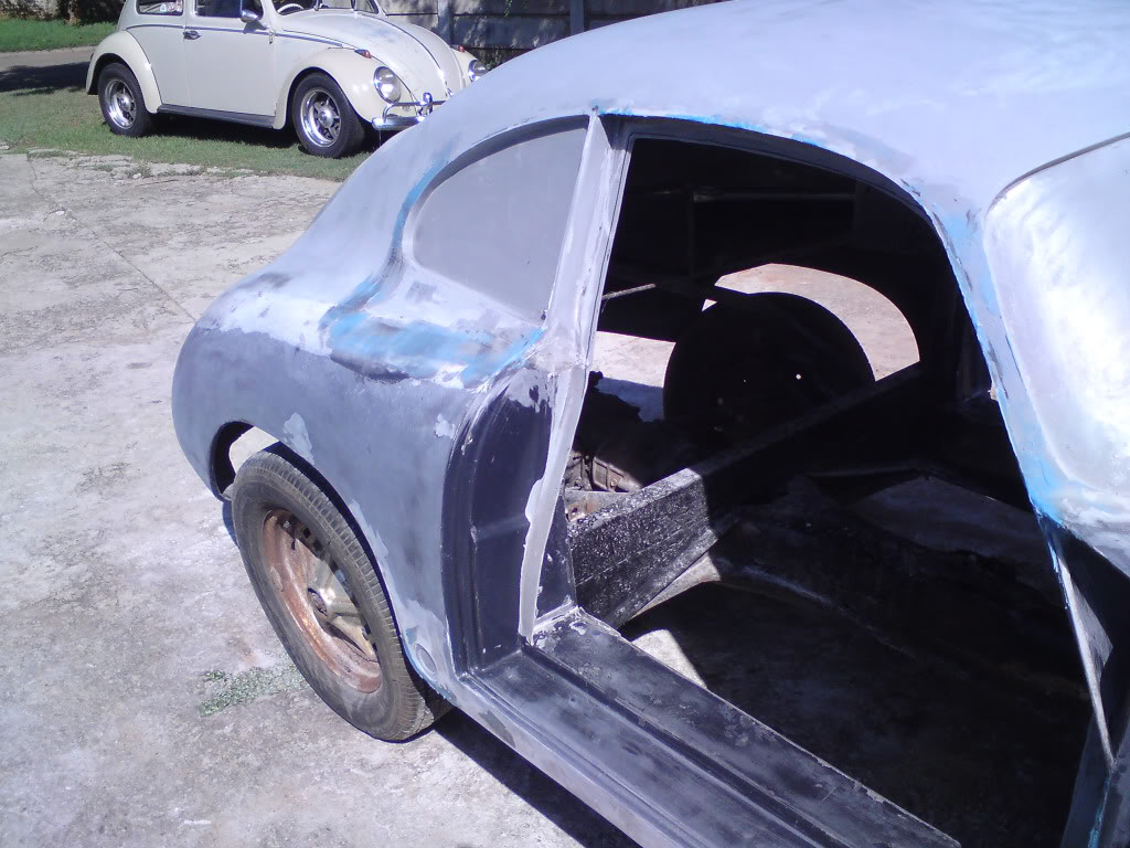

I spent the whole weekend mounting the roof with little strips of steel in preparation for the big glueing event. The two bodies are surprisingly close and the joins actually line up pretty well there is still tons of work but we are getting there
Even the rear window fits

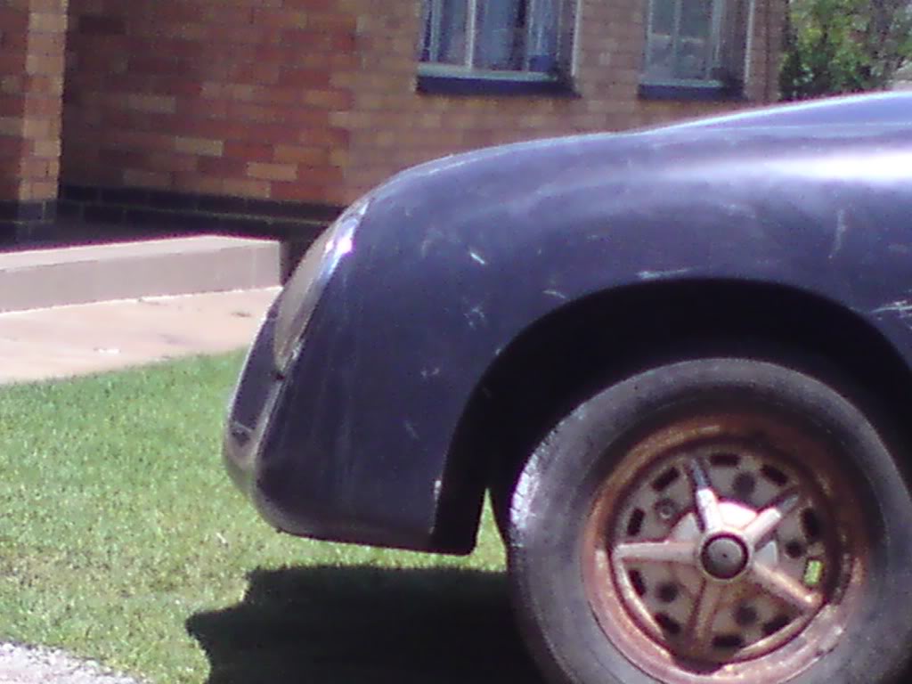

Real 356 A bodies had the headlights 35mm lower than the replica bodies (something to do with US laws)
The actual glueing together will take the rest of the week and then it will be back to the rear seat area to close that gaping hole

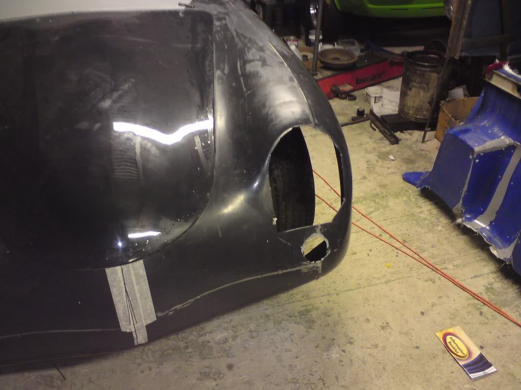

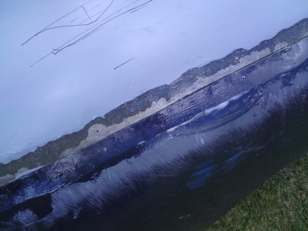

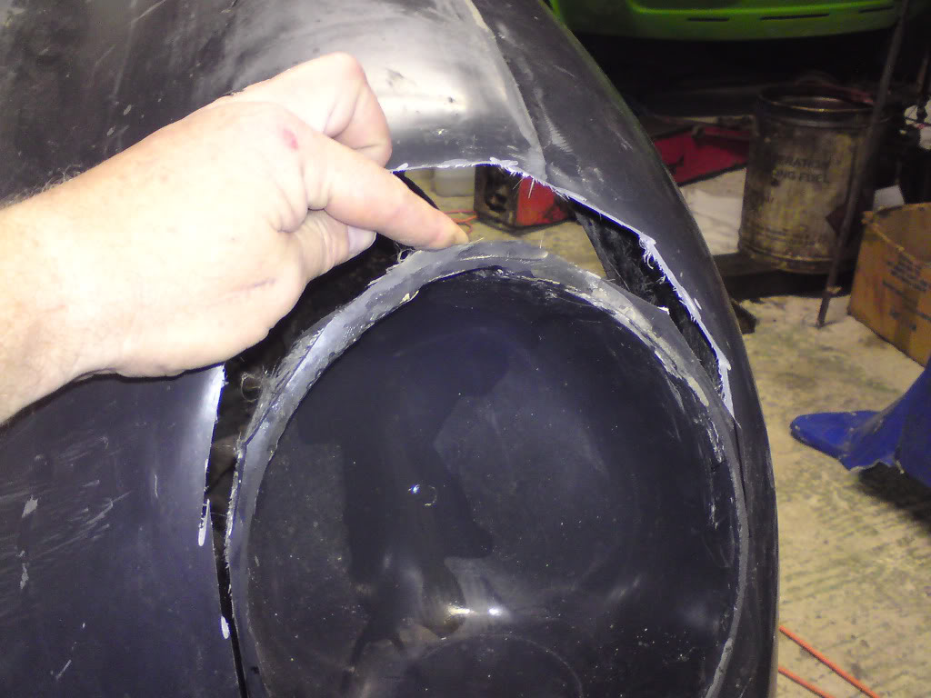

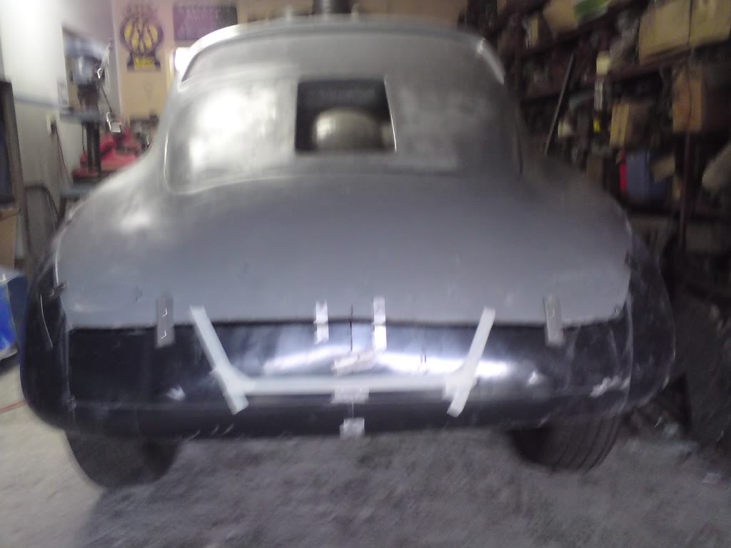

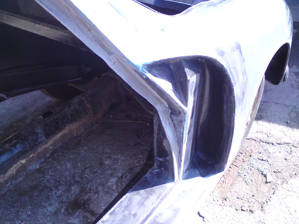

The roof and bottom has now been joined permanently obviously there is surface prep left and all those dents I copied from the original is still present in my copy. It was surprisingly easy to mate the two halves with only the rear end where the numberplate fits refusing to line up there was a centimeter deep mismatch which was cured by another patch piece from the original car. the method for joining glasfiber parts is as follows. first line up the parts join them with straps glass a layer or two on the underside and remove the straps when the fiberglass has cured. gring a v shaped notch at least 10 times the thickness of your fiberglass original this means for glass 5mm thick the v should be 50mm wide use thin strips of matting ond progressivele widening them until the original thickness is achieved if torn fiber mat was used at the bottom of the join this would render the joint invisible and as strong as the original glass.
ON the body there is a small drawing of the join this photo was taken after the v was ground and the itching started.

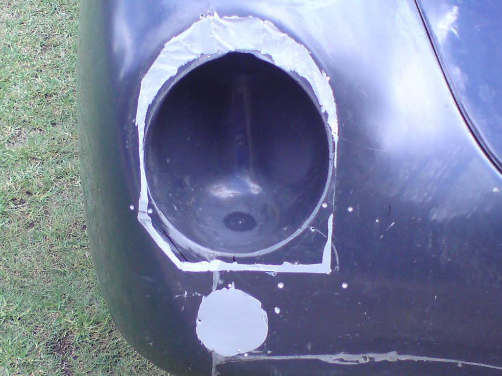

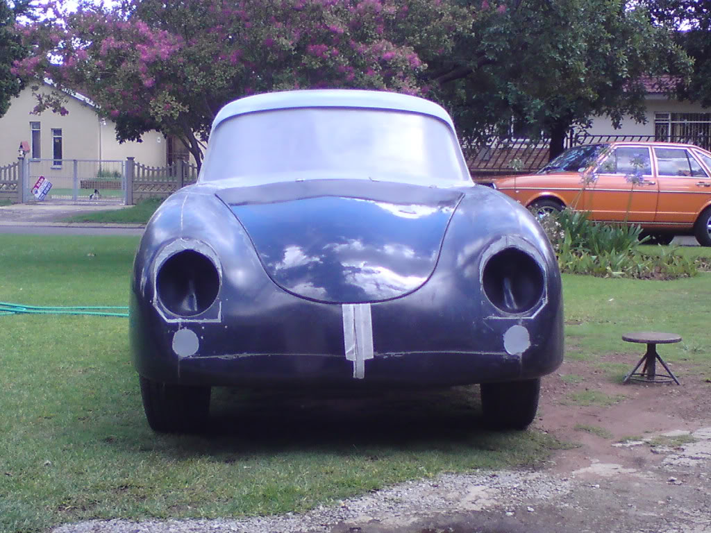

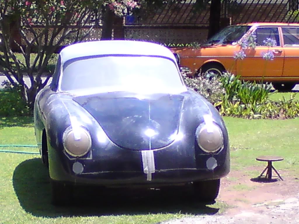

The headlight gaps filled in the top of the wheel arch has been thickened cosiderably and will be sanded to a more correct shape
The main shell is now largely together which leaves doors. I was lucky enough to be able to copy the tops of real doors and have moulded the inset pieces

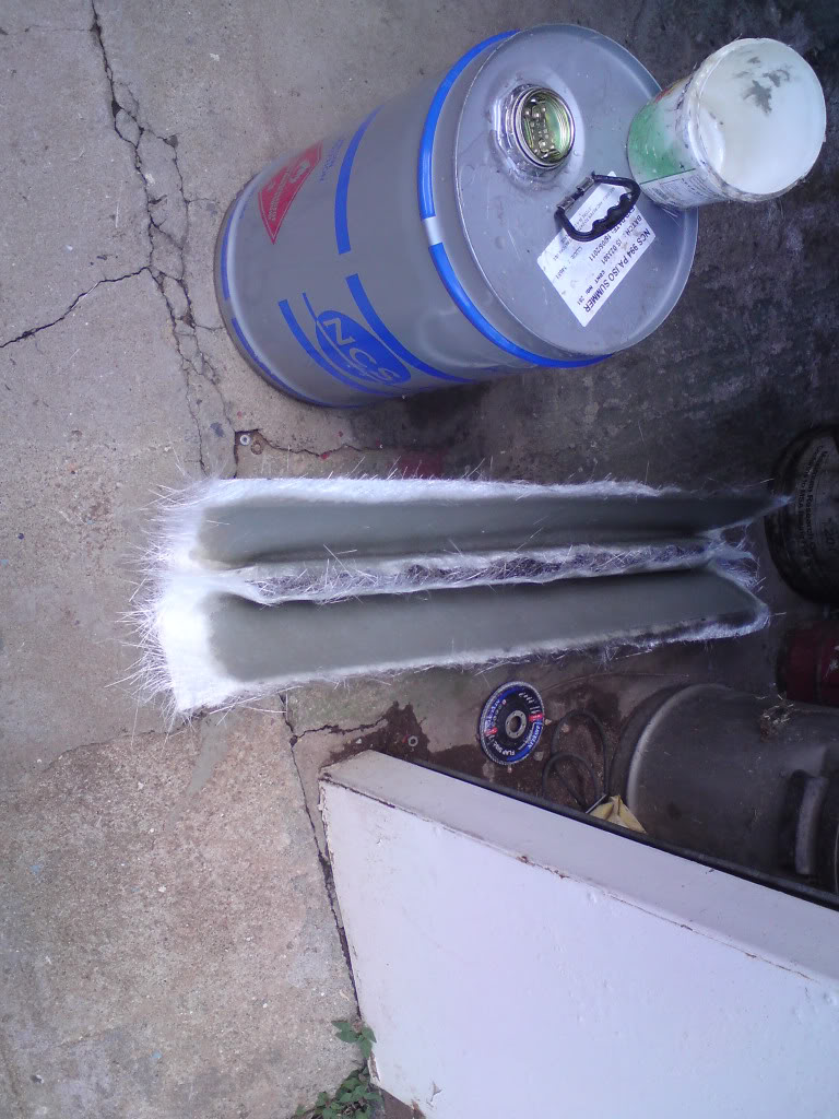

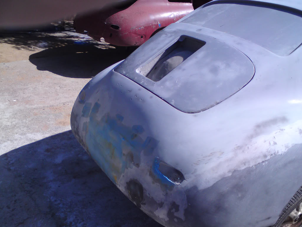

I am doing the preliminary filling with NCS Ultrabond in order to minimise the use of filler But it sure sands hard almost like sanding concrete
