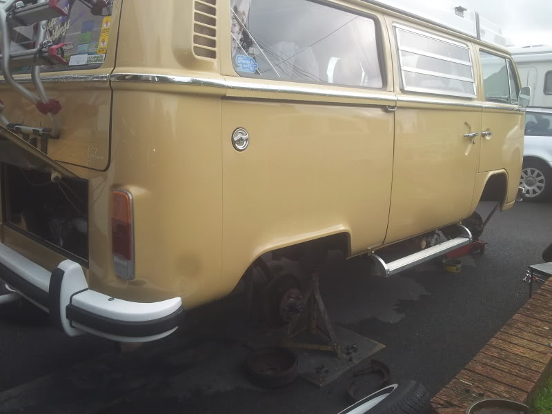

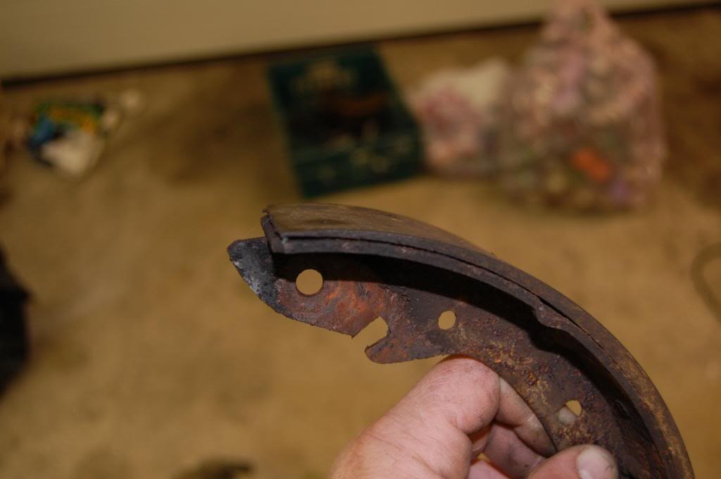

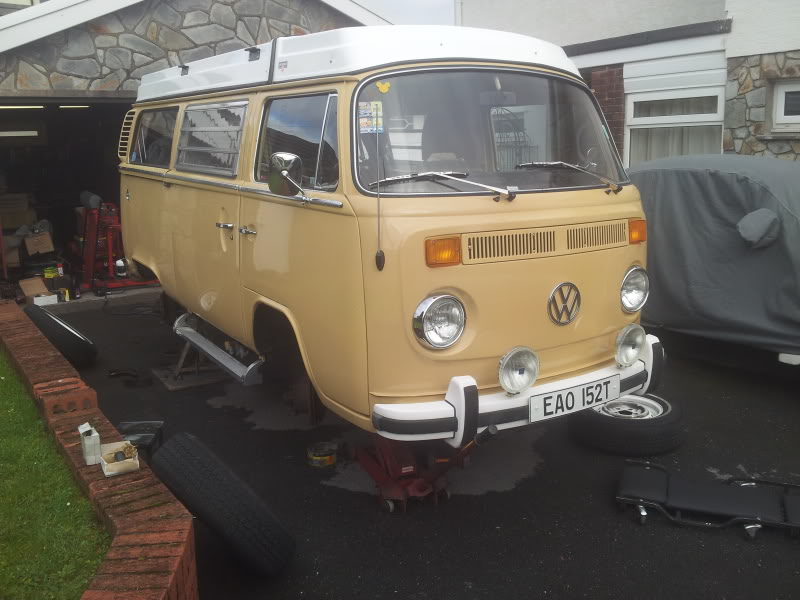

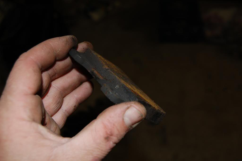

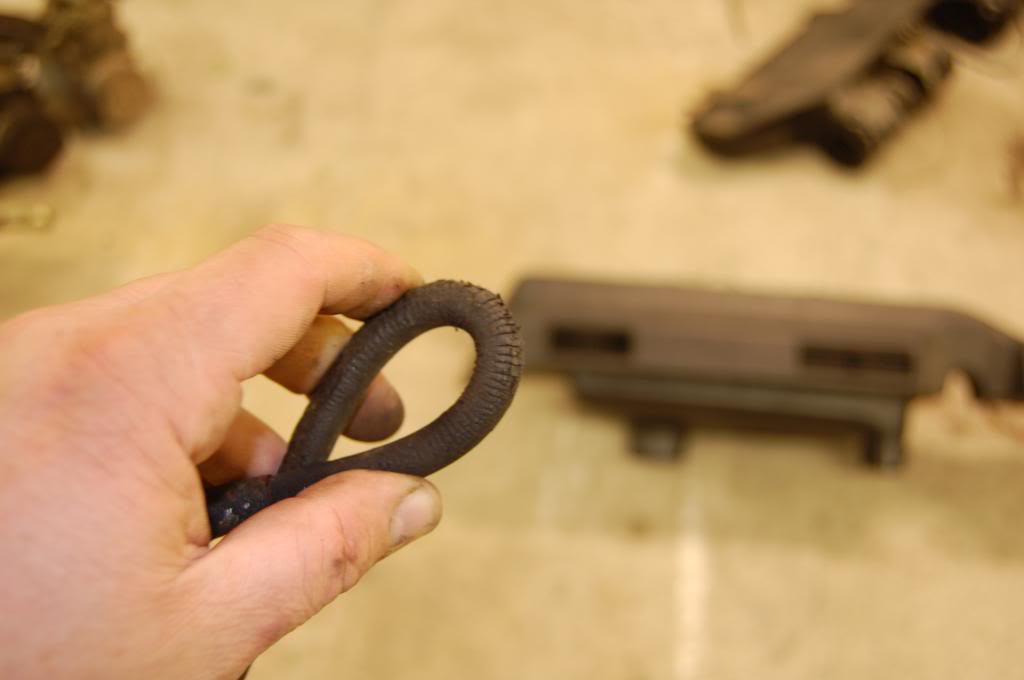

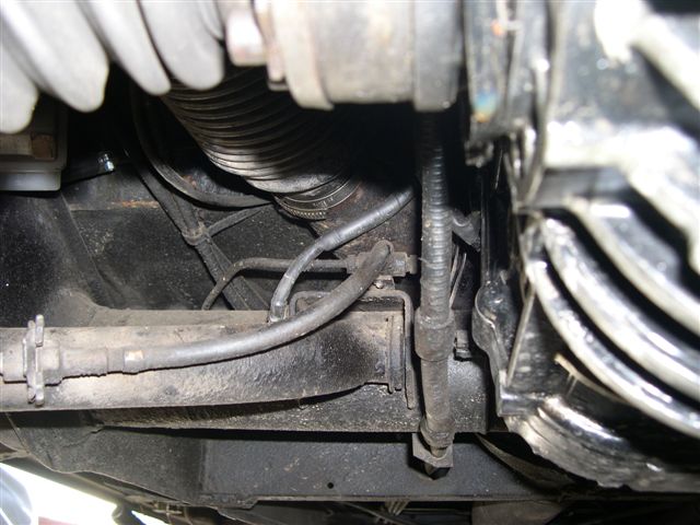

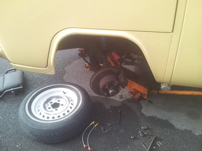

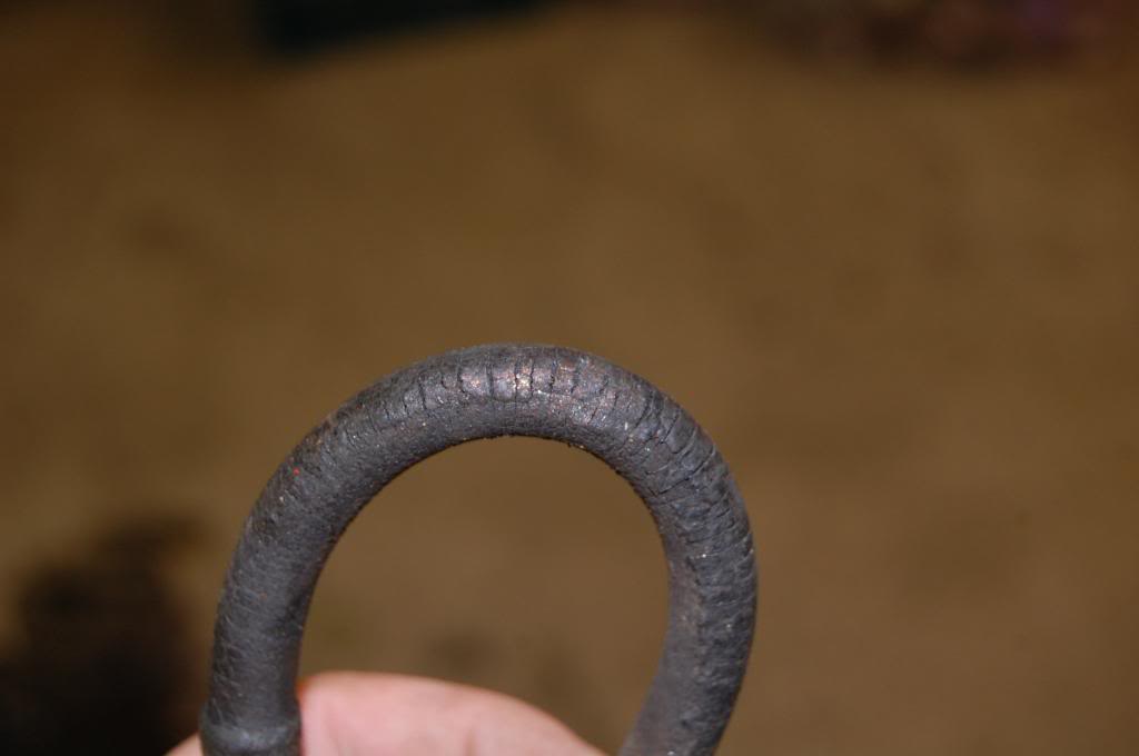

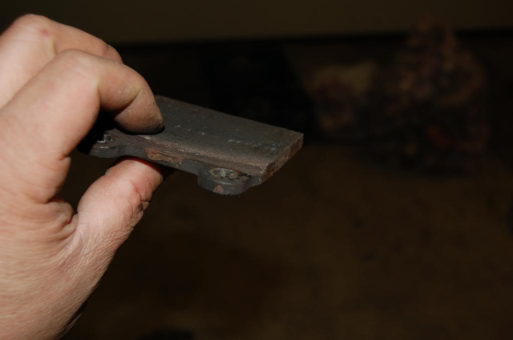

The old brake flexies are shot & badly perished, Tudor thinks they are the originals.
The drums & discs are also original but thankfully very good condition.

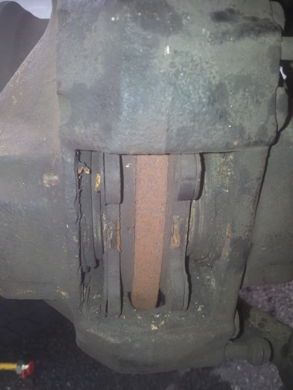

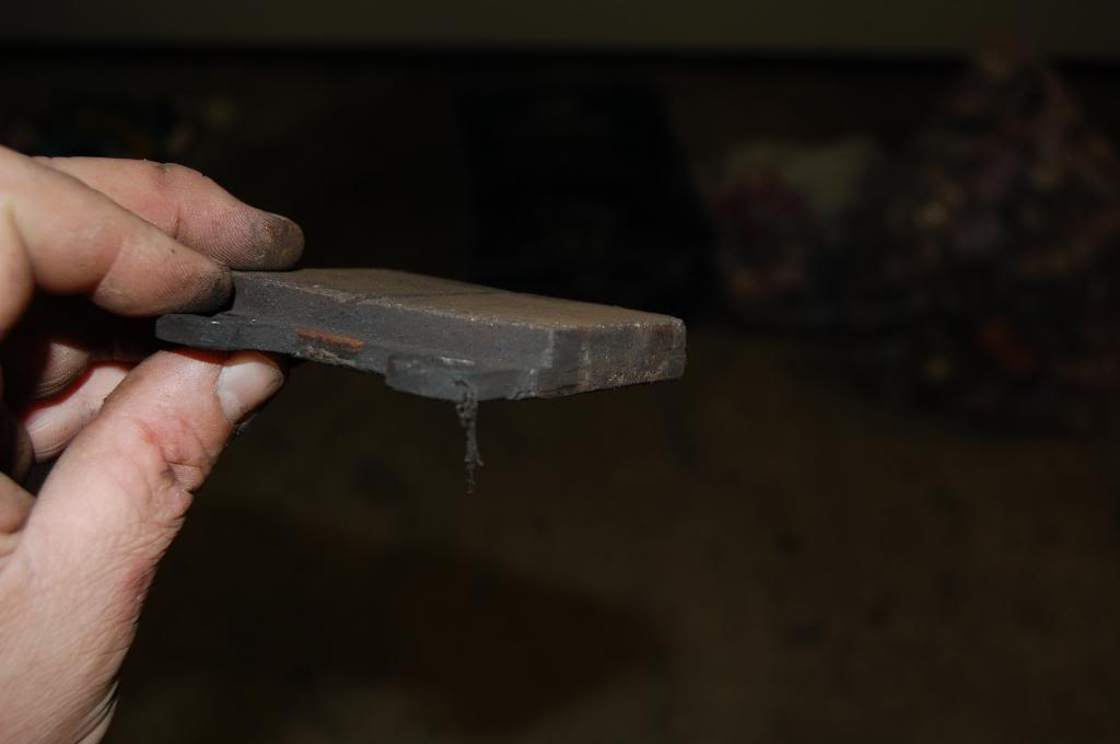

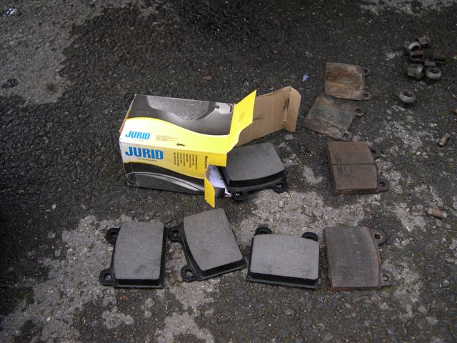

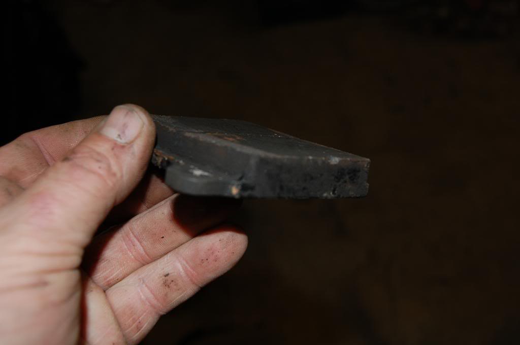

The front pads were very thin & wouldn't have lasted much longer.

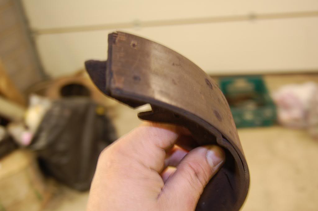

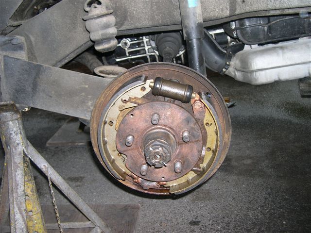

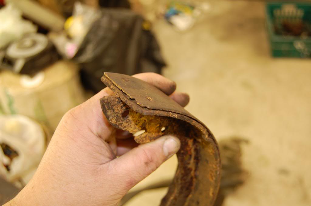

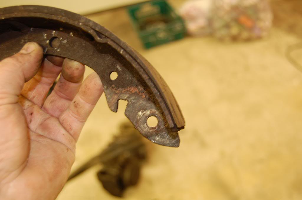

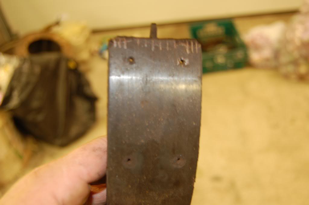

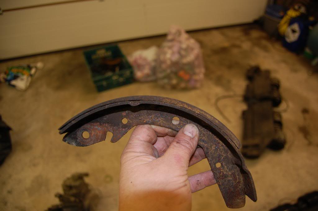

The rear shoes were very thin & the rivets are nearly through. I did say rivets so they are probably the originals too.

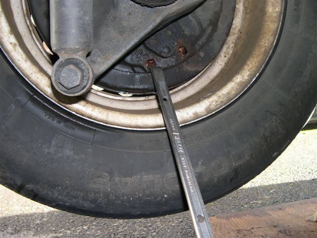

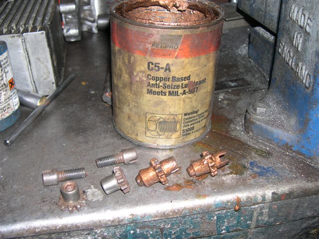

The rear adjusters were seized solid but Tudor has freed these off now.

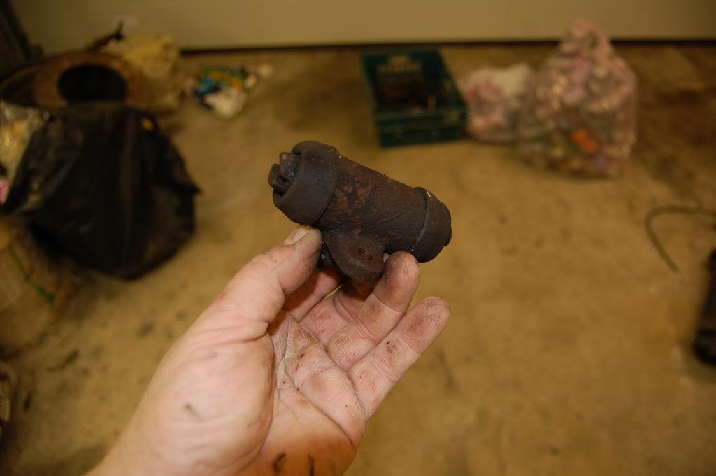

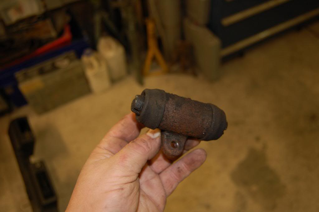

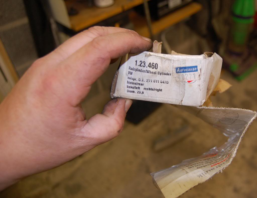

The rear cylinders are good but as I have NOS ones, Tudor is fitting them.
The cylinders are from Autocavern so they are proper old.

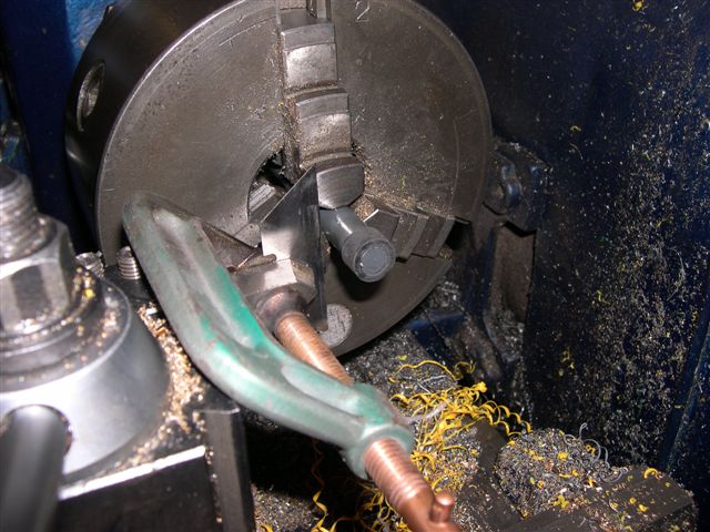

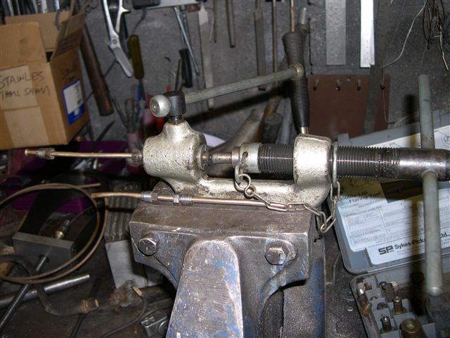

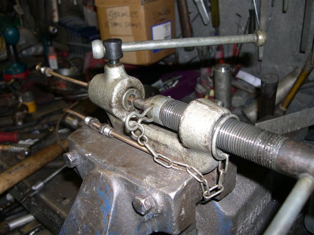

Tudor made up some cupernickel pipes to replace the ones picked up as an advisory on the MOT.

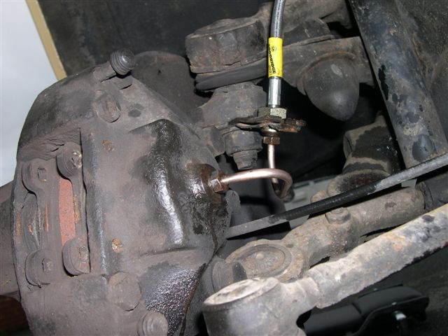

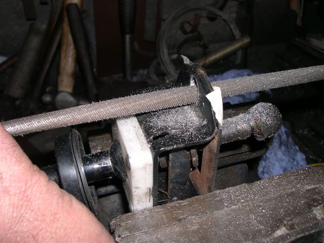

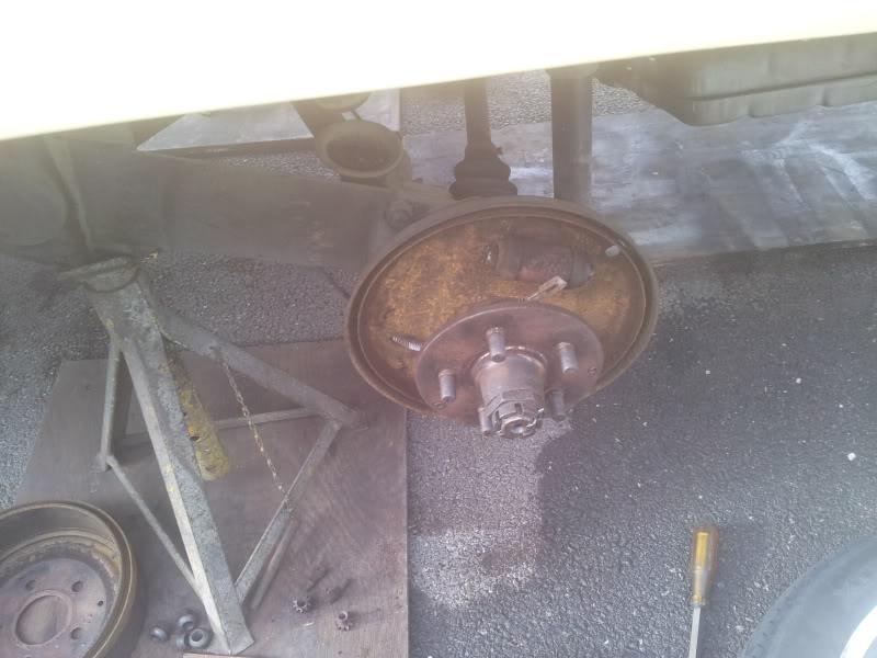

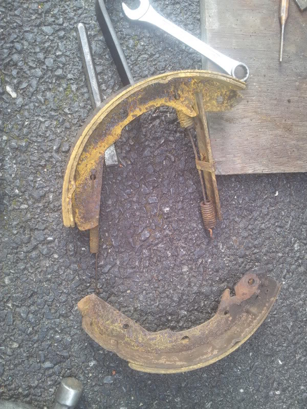

The new brake shoes didn't have the handbrake leaver on them so Tudor drilled out the old rivets, machined 2 new rivets on the lathe, & peened the ends over to replicate the originals.
Back brakes all reassembled with copper grease & ready for the drums:-

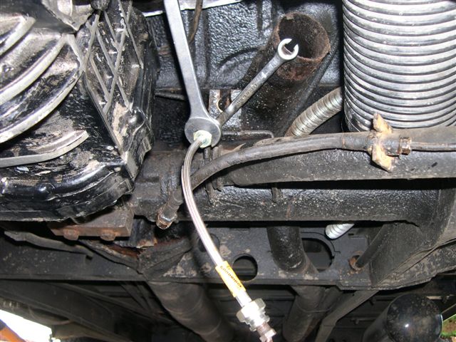

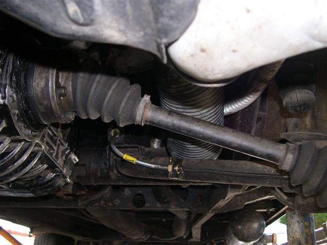

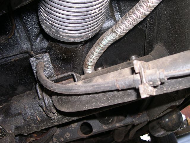

You can see the old flexy:-
The new one here:-

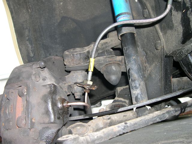

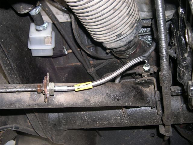

The other side:-
The new one:-

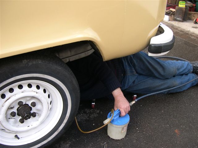

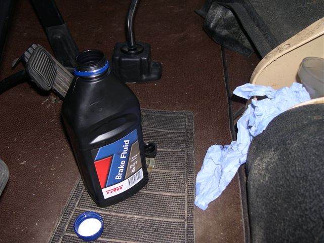

Bleeding the brake's, flushed all the old fluid out & replaced with new:-
Filled up with new fluid, this will be changed again in 3 years:-

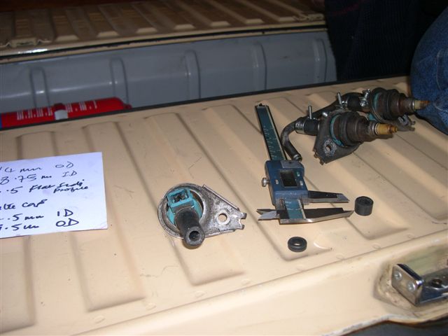

Since the rebuild we've had an issue with the injector seals, Tudor & Mike have now resolved this by making their own. They spent all day today sorting the seals out & tweaking the settings, the van now runs sweet as a Swiss watch:-

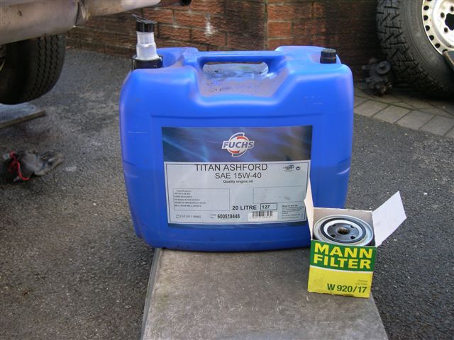

Finally Tudor replaced the oil & filter, Milly is now right until next winter:-

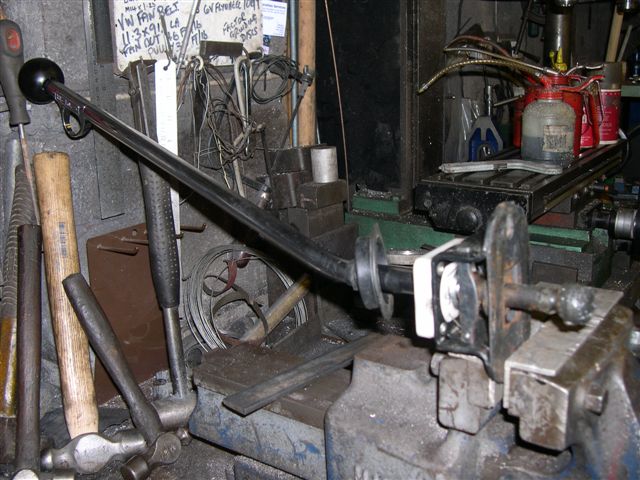

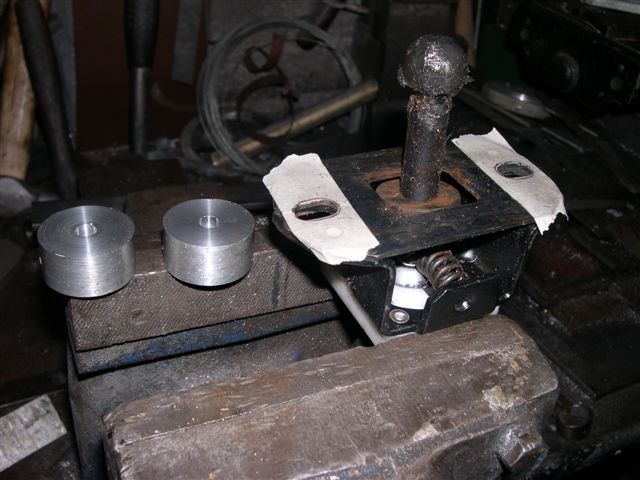

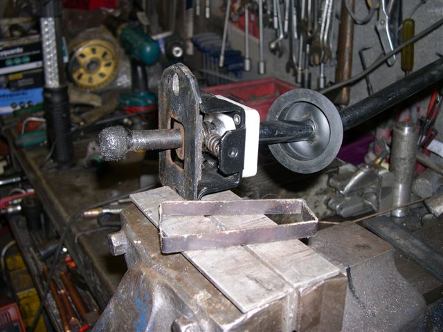

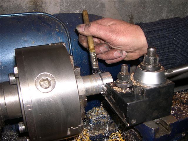

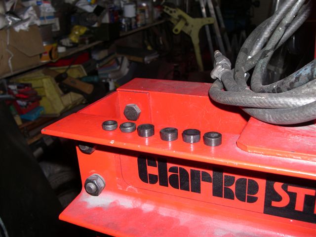

Tudor & Mike made up some spacers for the Empi gear linkage because the ones that come with it are rubbish, this allowed them to set the gear linkage properly so now you have to pull the leaver to select reverse & the other gear movements are silky smooth.

Change engine oil and filter using best 15/40 oil

Strip out fuel injectors, manufacture seals to correct size

Remove after market gear stick to rectify reverse selection problem
Fabricate spacer blocks to replace inferior spacer
Elongate mounting holes
Re-fit gear stick, set up and synchronise for correct selection of all gears and reverse gate

Went through the recently removed old brake parts, the pads, the first three aren't 2 bad:-
This one must have been on the sticky piston:-
Look how old these are, can anyone remember Autocavan?
The new pads:-
The new pads:-

The old cylinders:-
The old shoes:-
You can see that the linings are starting to break up & the rivets areworn badly, I was lucky that it did not score the drums:-
The rear flexy's were very bad & it looks like I should have changed them a long time ago:-
The old shoes:-

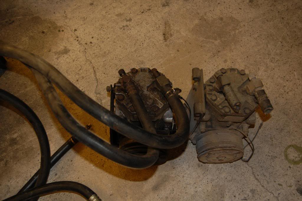

The original aircon pump & the one I've recently acquired:-
