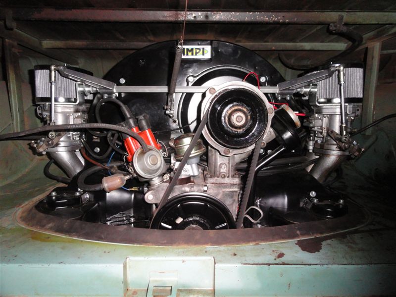

I spent the weekend at IMPI's replacing the engine and transmission in my 63 Dormobile.
Thanks to the IMPI family for the hospitality and hard labour!
Bugger built the new transmission from a heavily abused Fleetline box and RGBs and the results speak loudly for Bugger's magic hands. The new trans runs quiet and shifts smoothly. Thanks Bugger!
IMPI built me a 1776 with twin Weber 36IDFs and what a SWEET engine. I'll start a separate thread on this build and particularly the costs of building a mild performance custom type 1 engine to give forum members a sense of what goes into a proper engine build (mostly lot$ of money

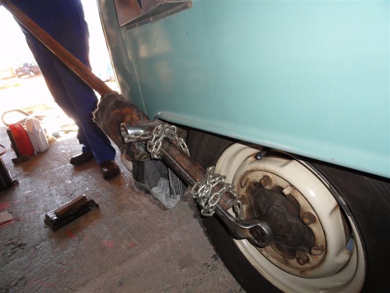

Boer maak 'n plan. I forgot my 46mm socket and power bar. IMPI didn't have one and we didn't find one in a quick trawl of the Orkney pawn shops, so we borrowed a 46mm spanner from a neighbour. But how to apply a cheater pipe to a big spanner?

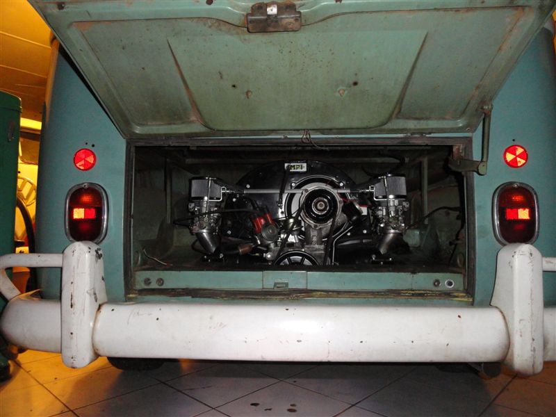

The pics of this engine installed just don't do justice to the work of art (and MAGIC) that IMPI produced. The 36hp fanshroud has full doghouse internals and is a work of art all on its own.
Right after getting the bus running again on Sunday, I loaded it up with all my tools, a large trolley jack, and the old engine and transmission (about half a ton's worth), and headed back to Lindequesdrif. Even on a tight new engine and driving slowly the power was amazing. I reckon the new engine is giving at least double the power of the old one with great torque. I'll post full specs in a dedicated thread.
The engine still needs some fine tuning and I need to properly tighten the new oil pressure sender, which leaks a bit, and get the alternator to charge, but otherwise it ran sooooo sweeeeetly on the way home, carrying the load with ease and flying up the hills, which was the main purpose the engine was built for.
Thanks again Armand, Wouter and Yolanda!!!

Fig, you should know better.....
please move your fuel filter
Otherwise looking awesome. Get the engine on a dyno to get the carbs perfect and see how she feels then

Tony Z wrote:Fig, you should know better.....

tony where to do you move your fuel filter? I suppose there should be one at the fuel tank's outlet aswell?
- Posts: 15009
anywhere outside of the engine bay - next to the gearbox near to where it comes out of the tunnel is a pretty good place
I was wondering who'd be the first to say that!
IMPI had the filter there while he was running it on his test bench. I will definitely be moving it before I drive the car again.
