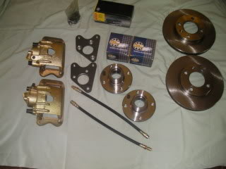

I can supply the complete kit, brake pipes bearings nuts bolts etc, just bolt on. R2200 Front. R3320 Rear.
It's easier than re-doing the drums, I have a step by step how to do it write up that goes with the kit.
It can be done with simple tools in less than 2 hours per side, no rocket science.
Kit consists of all new parts:
Vented disks
Caliper bracket
Hubs
Bearings
Brake lines
Calipers
Nuts & bolts
Brake pads
Rui 082 830 6493

RvanZ this is what i got in my kit (bought from Rui)all the parts you will need
