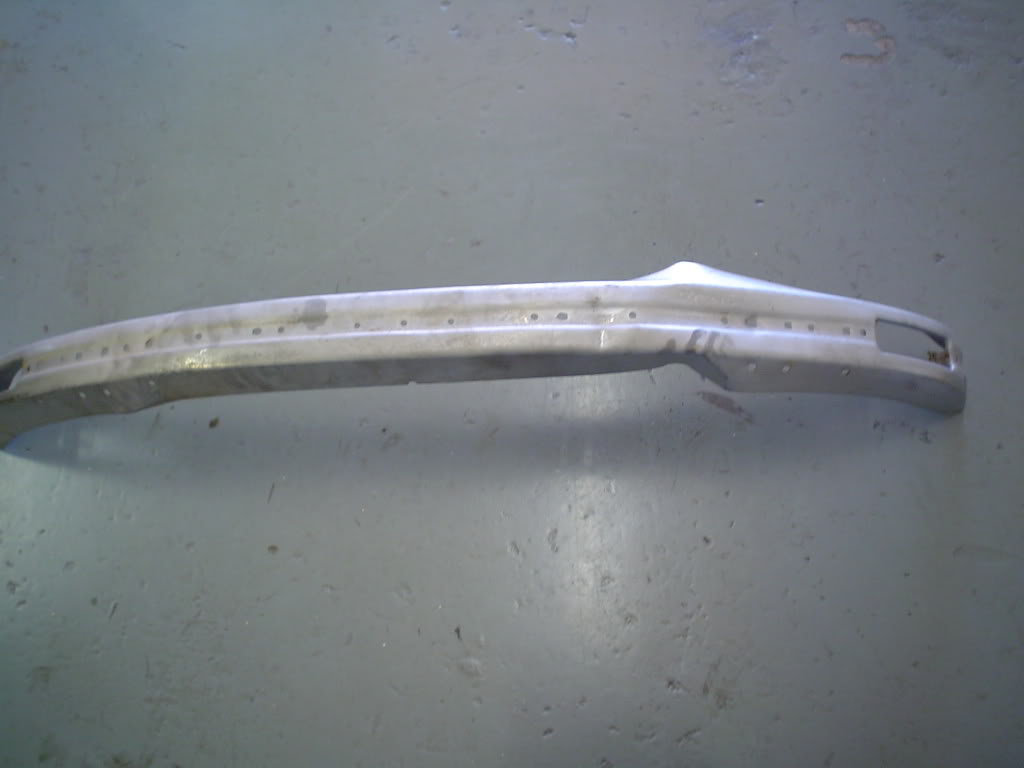

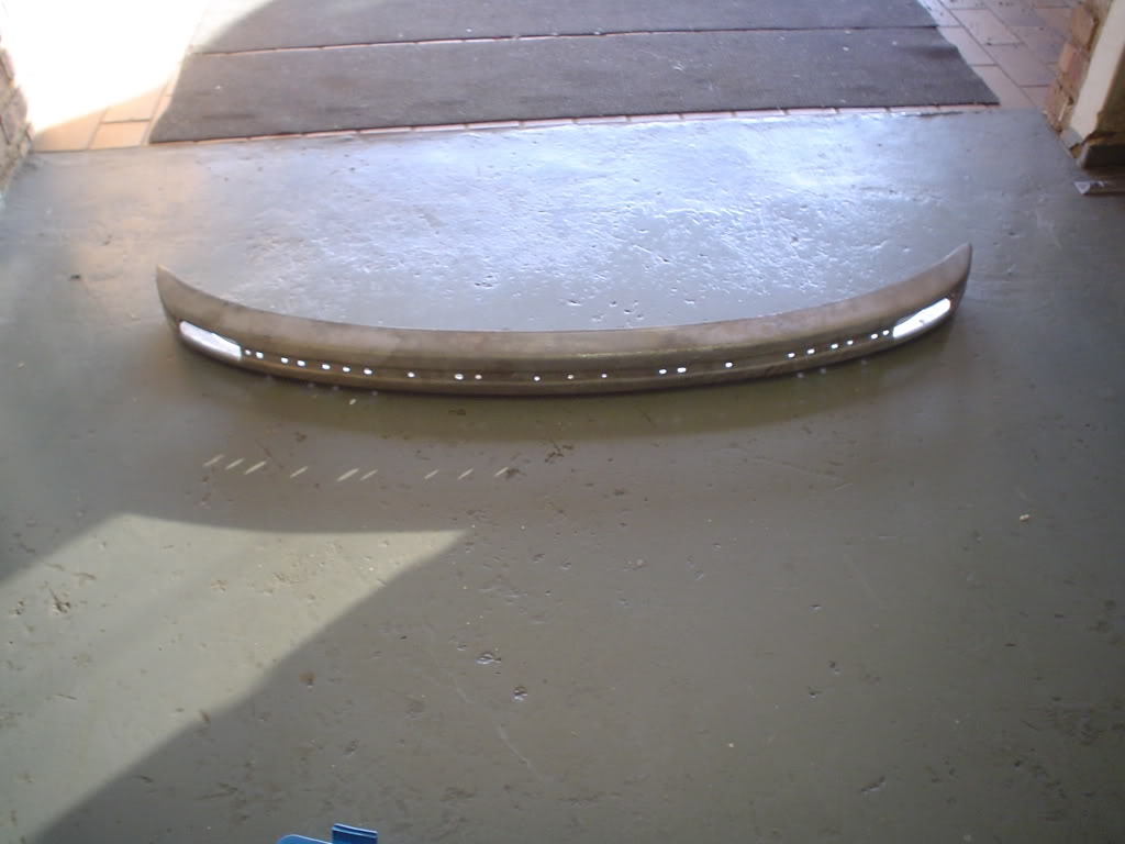

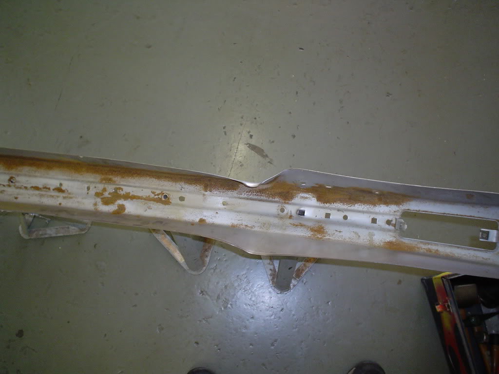

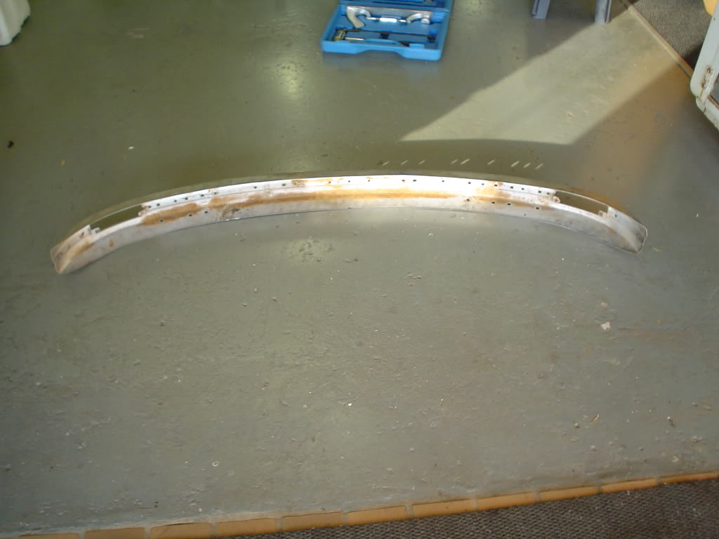

This afternoon we decided to try our hand at bumper straightening and the following is the result.
Before (I had the chrome removed in an acid bath beforehand)
After
The bumpers will be painted for the Twobucks project, so a skim coat of body filler will make it perfect.

Came out quite good. Is it better in real?? How'd you manage to do it? I've got 2 front bumpers that are in need of straightning

When the chrome was removed, the base metal came out with all rust etc removed. When the acid gets washed off, you immediately get a very slight layer of survace rust formed.
If you follow the correct procedure for filler you should have no problem with the adhesion of paint.
What I'll do here is to first sand the whole bumper with 600 paper to remove the layer of surface rust. I'll wipe that down with a tack rag to remove grease from finger prints. I'll follow that with a layer of body filler (mixed properly). I use BASF CAR SYSTEM filler. That will get sanded with a long board with 600 paper again. High spots will be knocked down and low spots filled. The plan is to not have more than 0,5mm of filler on the finished project. Then I'll apply sealer after a wipedown with a tack rag, follow that with spray filler, sand that down and then apply the carbon fibre finish folowed by a few layers of clearcoat with a bit of flexing agent mixed in to resist chipping.
This is the route I follow and so far it's worked for me.

It came out very nice. I would not send it for chrome plating as is as there are some minor imperfections that will show through, but nothing that cannot be filed smooth with a metal file.bugspray wrote:Came out quite good. Is it better in real?? How'd you manage to do it? I've got 2 front bumpers that are in need of straightning
I used the basic tools as found in the Adendorf's and Midas panel beating sets.
I used a selection of flat head hammers (to limit metal stretching) and some picking hammers with the relevant dollies to gently work the metal back into the original shape. (Banging with a hammer on some metal "gently" is an oxymoron, I know, but use your imagination)
We finished it off by "twisting" the bumper to get the correct "set" and level curve.
