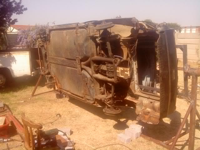

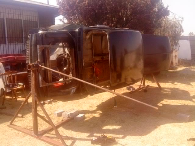

The Notch was spun around on the spit a couple of times to see what would fall out :
nothing but rust!
Then the real inspection started in the harsh light of day.

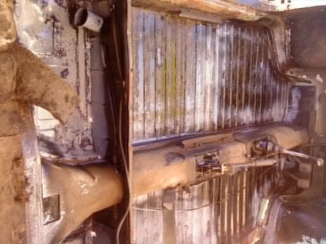

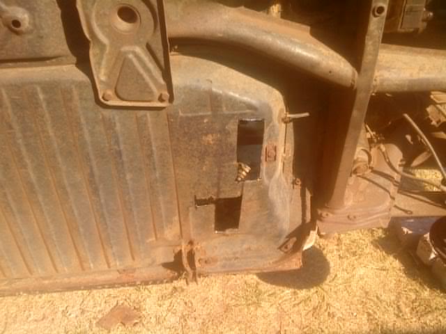

Hi guys, i did some more work on the notch today. The floor pans are so to say saved. There were alot of pin holes which i drilled out and welded up. They should be good for another few decades. Next week im going to cut out and replace the heater channels, as the most solid part on them is the fibreglass work that was done on it. Cheers for now, Ferdi.

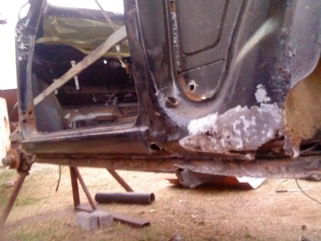

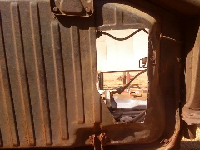

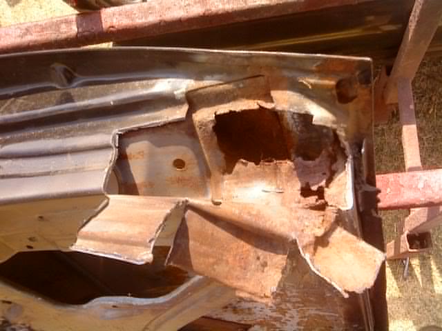

Some more rust and rot on the pan has been cut out, (if you have ever seen the movie Sixth Sense), I can see dead floorpans
but after a kind donation from a beetle that stood too close:
Aaahhh, much better, and if you know that comes from the PC game Duke Nukem, you also need a life

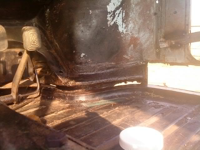

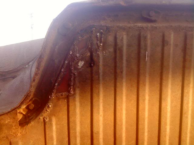

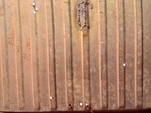

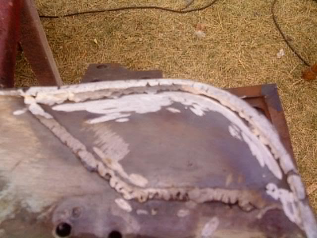

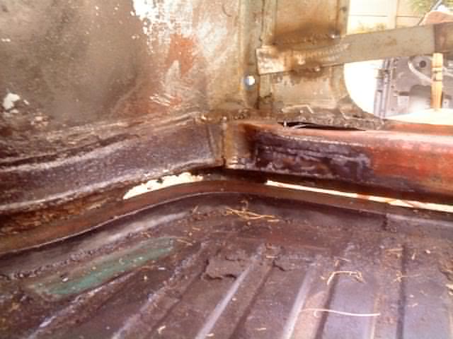

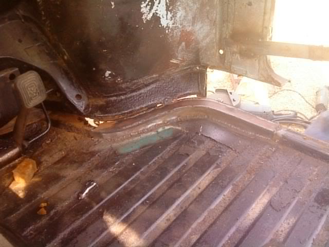

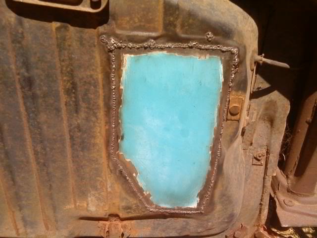

The pinhole rust repair in progress:

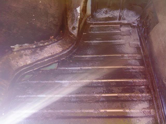

To celebrate the repair of the pan, a bottle of the good stuff was opened, no not Moét, NS1
Let's just say it was applied like violence in a Tarantino movie:
Notice the improvement in the left floorpan especially, but also the entire pan:
This should not rust again in my lifetime, unless I park it in a lake!

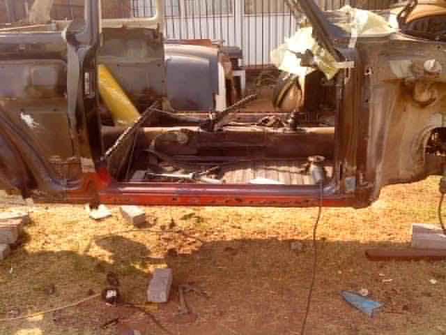

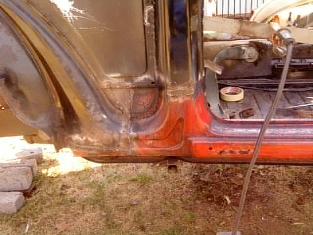

I woke up, made a cup of coffee and checked my email. Saw that I had a pic from Ferdi,
SOMEONE HAD STOLEN.... THE DRIVERS SIDE HEATER CHANNEL !!
Ferdi says he didn't hear anything, but I don't know if I should believe him
I rushed over there, and after a bit of searching, we found some footprints, which led us to the evidence:
The perp must have been disturbed in the act, and just left the stuff and ran. Sheesh, JHB is not for sissies

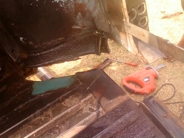

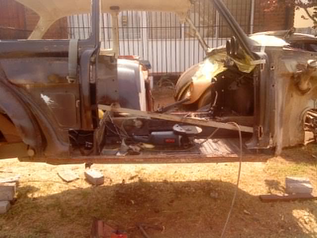

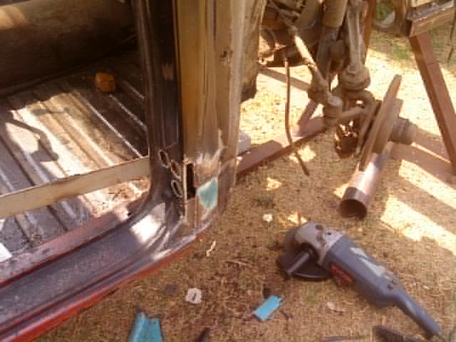

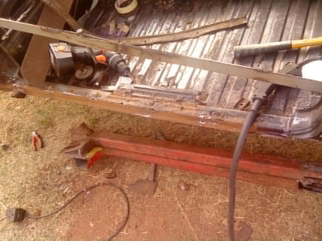

Fortunately, ferdi happened to have some spare heater channels cut from an unfortunate fasty .
So the hard work continued:
Cut that @#$@# out !!

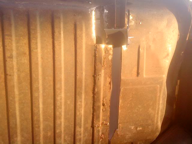

Now lets replace the missing pieces - talk about a tough puzzle..

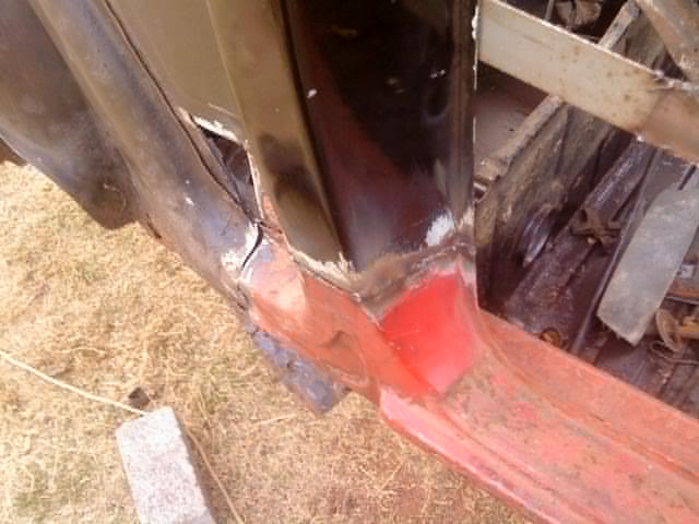

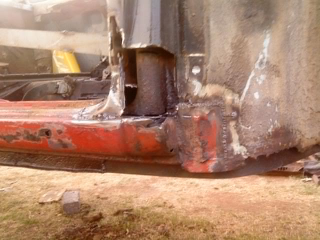

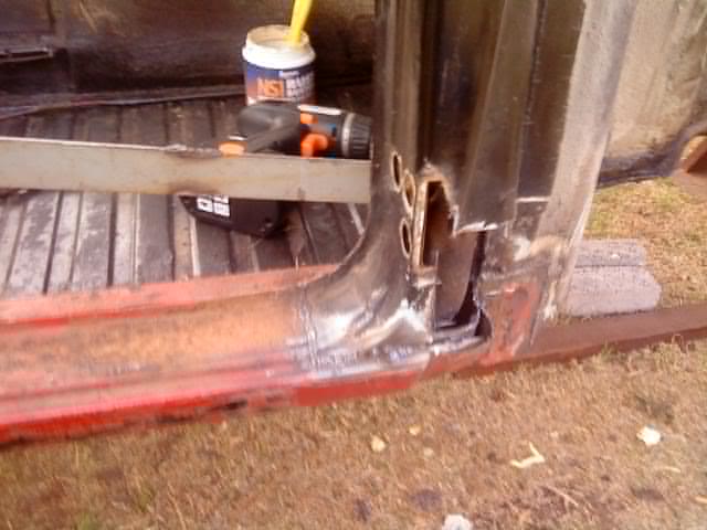

First, the frame around the pan -
and now, the moment of truth, mating the fasty channel to the notch -
and suddenly : drumroll......... TADAAAH -

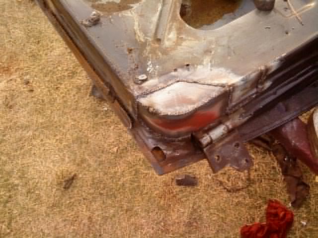

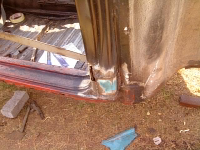

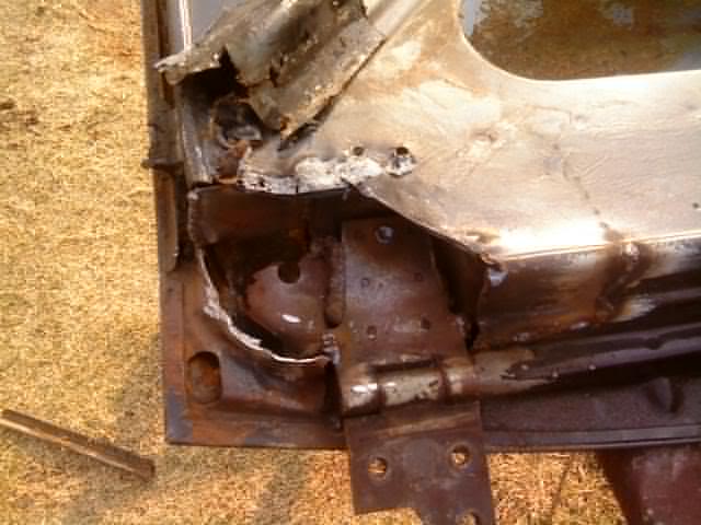

Next up was the door that come off this rusted side.
I was pretty sure that a replacement door might have to be sourced.
EINA!!
But I was feeling lucky
Now, for the other side
