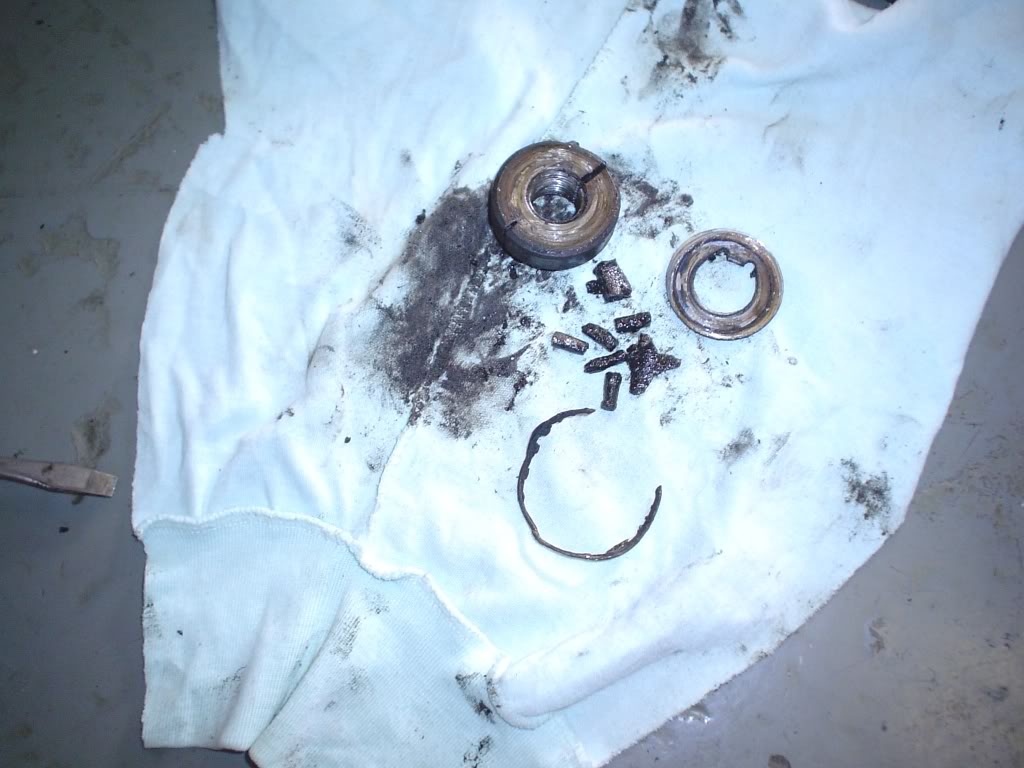

We limped to a nearby garage forecourt. I took off the offending wheel and found the grease cap loose in the hub, with the outer bearing totally destroyed.

This is what remained of the bearing.

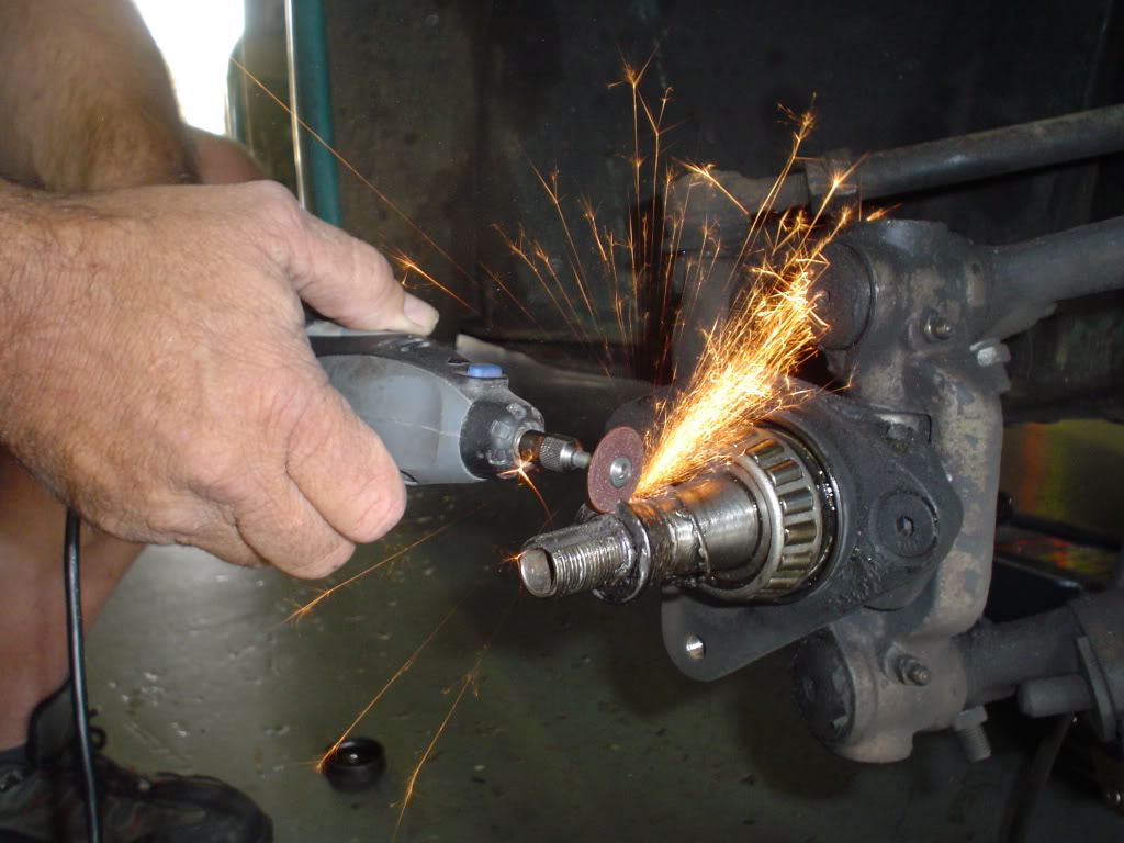

When the puller could not get the inner race off the stub axle, the Dremel had to come to the resque,

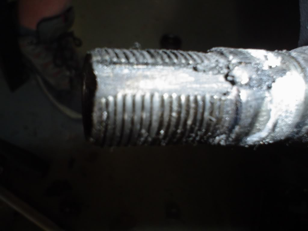

The bearing had seized solid and had spun on the axle.
I had to get a new stub axle (Thanks Volkspares), and as a precaution, I replaced the left wheel's bearings as well.
