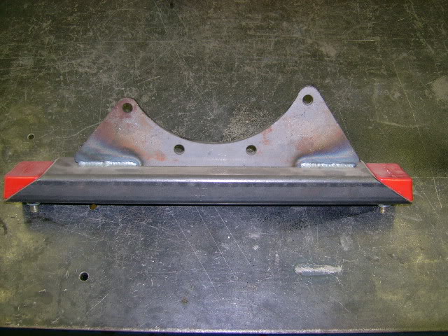

that is the one I have...
very very similar to this one
