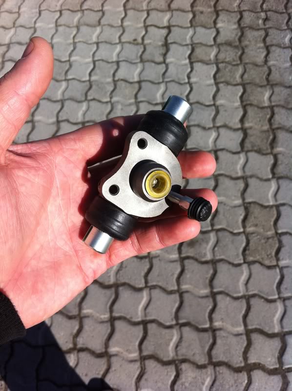

Just collected my rear wheel cylinders. Both of them, only one in the picture, but damn they are pretty things.
Can't wait till they actually stop the car to justify the HUGE cost!! Expensive little bastards they were!

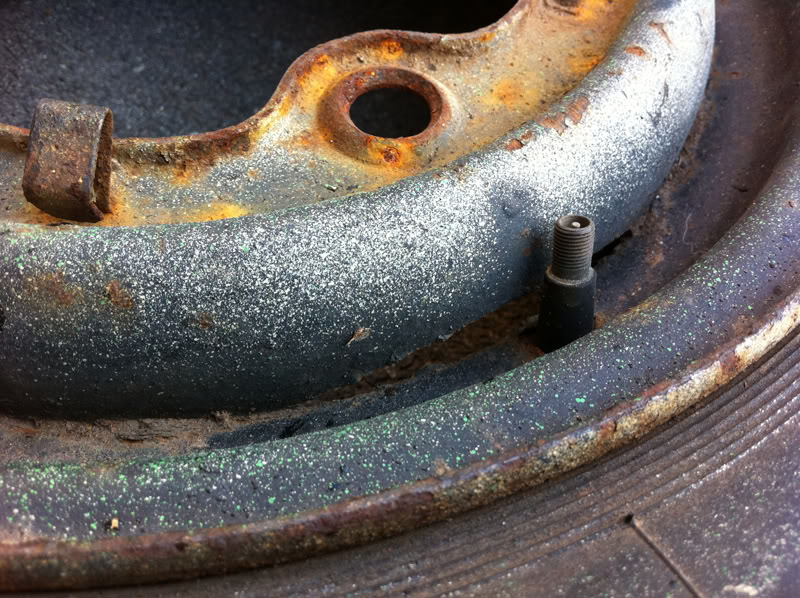

I also saw that I have 3 standard 15" steel wheels in various stages of rust and one 14" wide-5 steel rim! O_o Anyone have more information on this? Are they rare? Pictures below:

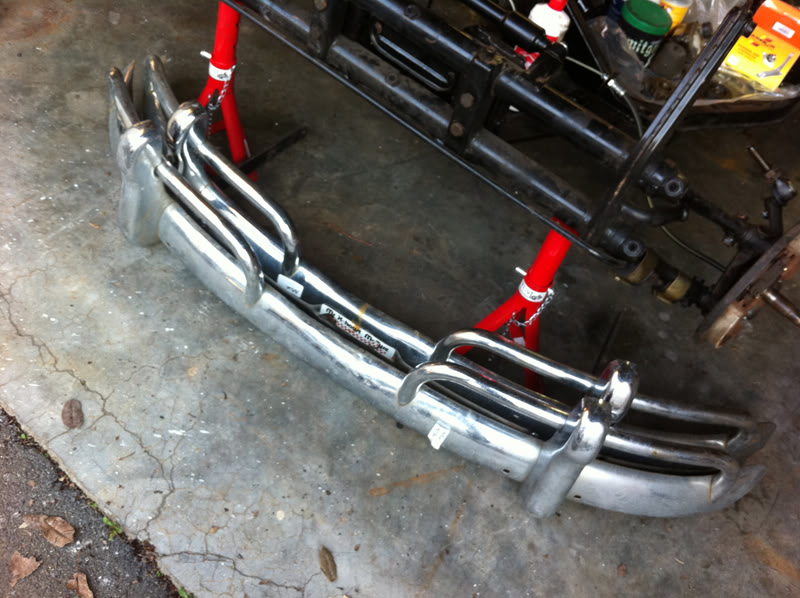

I have 2 bumbers which both are for one end of the car, cant tell for which side though.

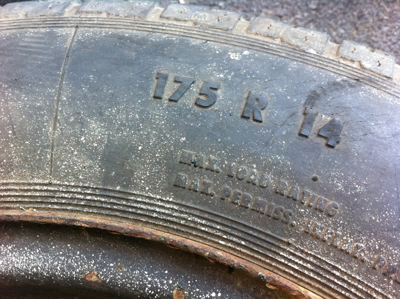

Just had a cool thought, I just thought of restoring that 14" rim, and painting it "spare wheel orange" and keeping it as a spare!
That could be quite cool

That is a good idea....
Had a problem getting a tyre and rim to fit in my spare slot, for the 1959 Beetle........
165 15 was to thick.....
Had to hunt for an old 150 x 15 for it to fit in.
So... maybe you should test it first.............
