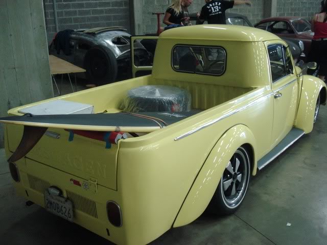

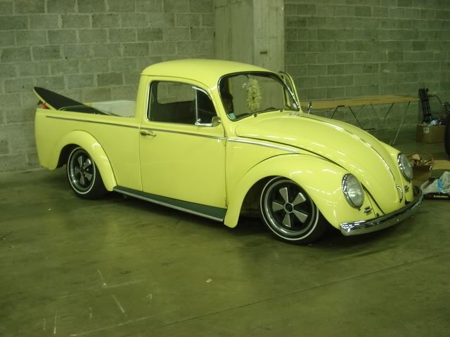

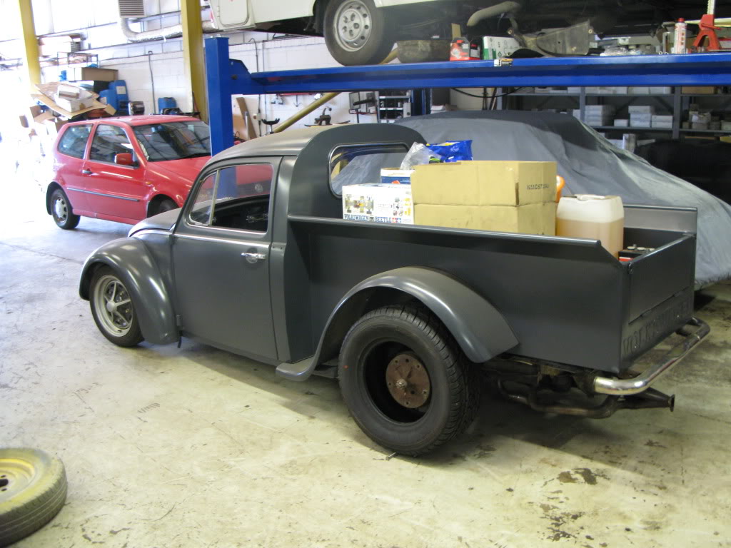

check out this thread dude!
Some great ideas of turning into a panel van. There are also a few pick of bakkie conversions, especially the first pic you see of one!
http://www.aircooledvwsa.co.za/viewtopi ... =5&t=21334

Both these pick up's look good.....
Sure both have type 4 engines, with side ducts that suck air from wheel well.
I THINK......
I THINK......

The second one looks fantastic

if you do one, definitely go for this version, they did it back in the day, and looks the best

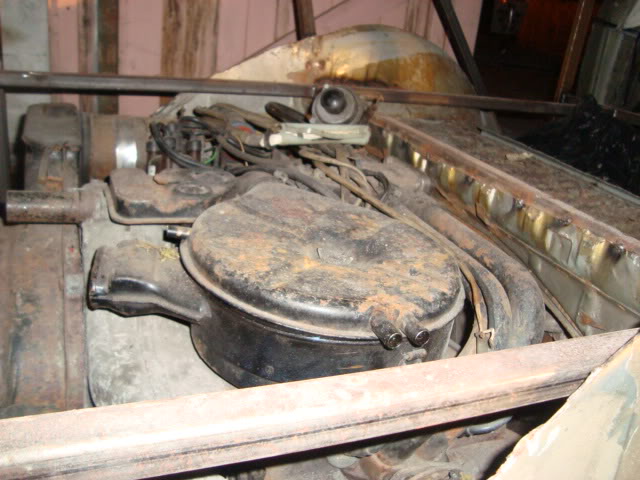

The sort of thing I had in mind.

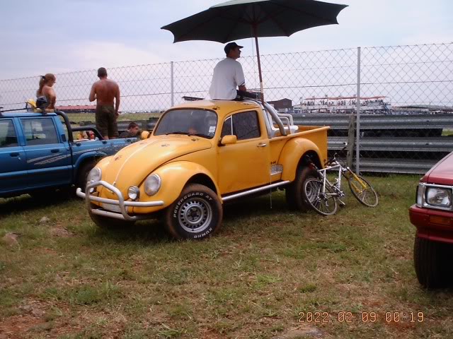

Re: Beetle Pickup Conversion
Hey, what's happening with the rear hubs on this 'dub?MINCE wrote:
