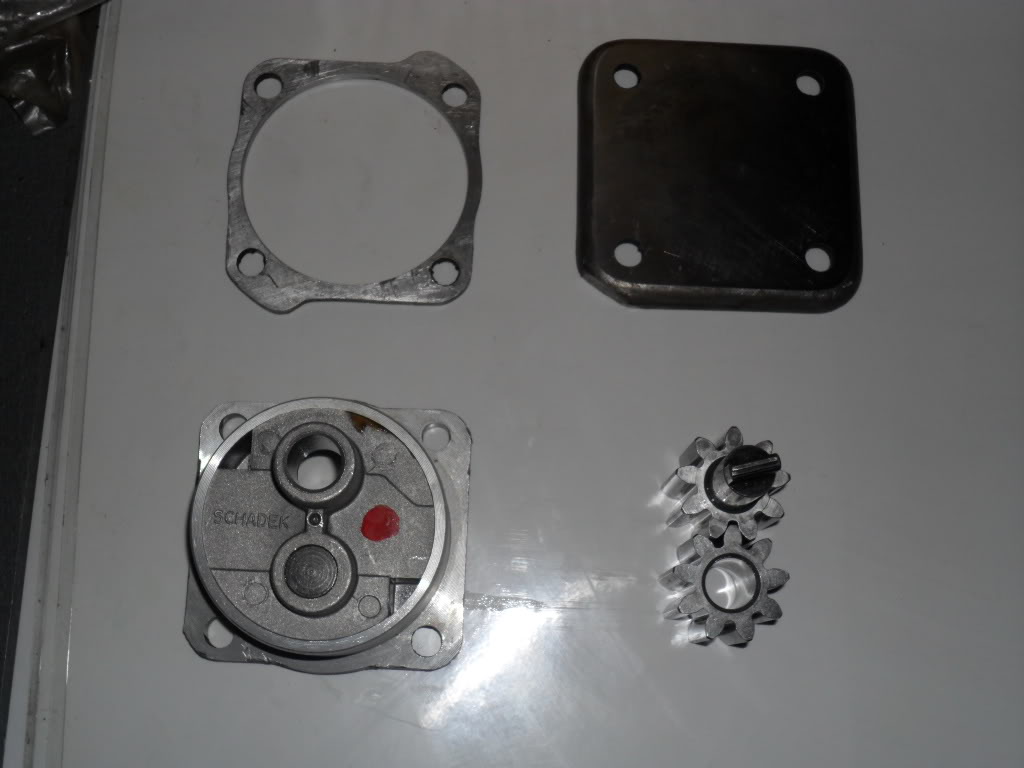

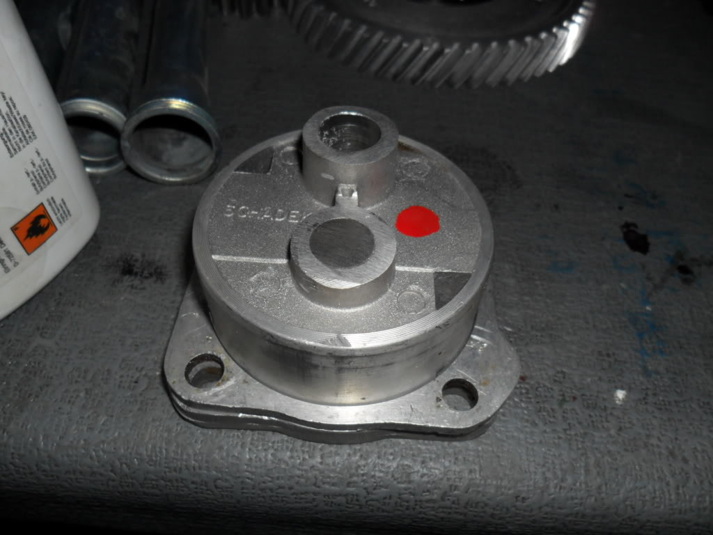

hd oil pump

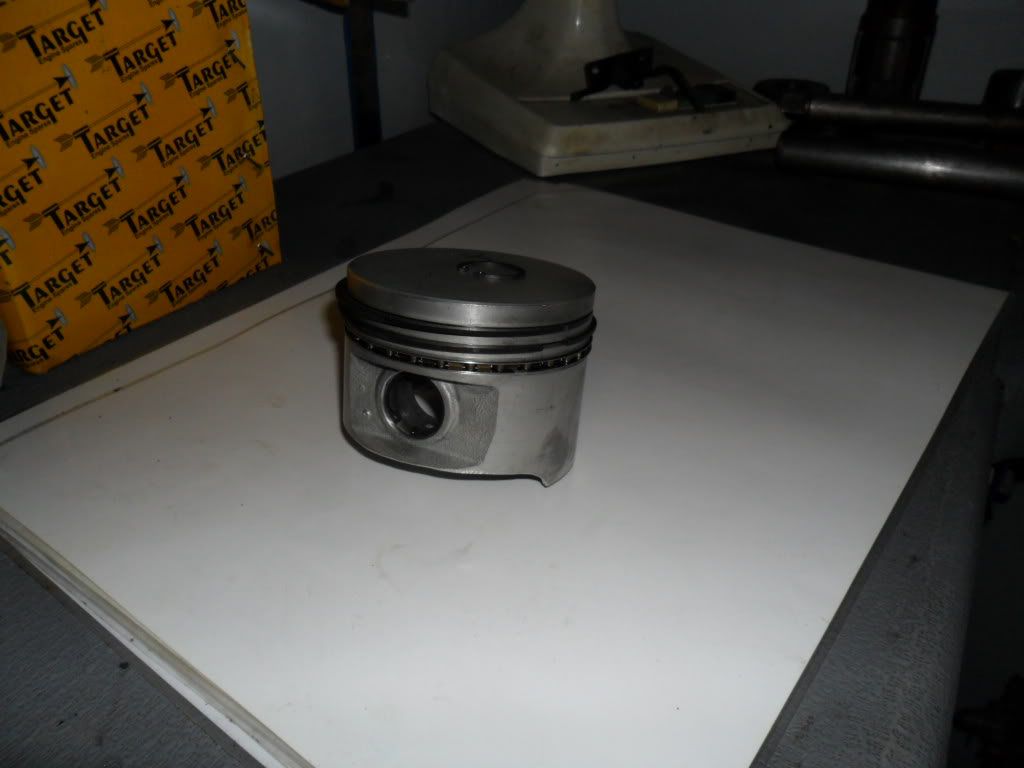

Pistons are non vw flat tops for slightly higher cr

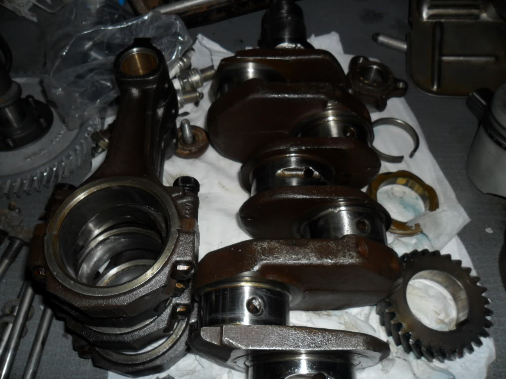

crank and rods rebuilt 1st oversize

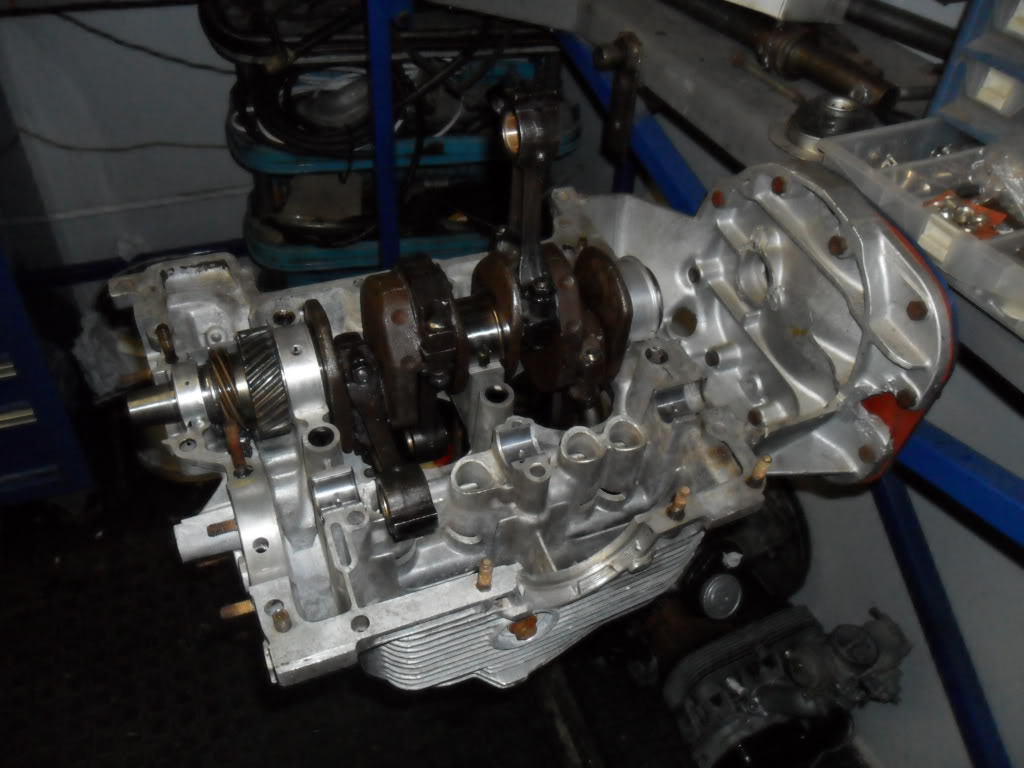

crank being installed just look at that huge casing

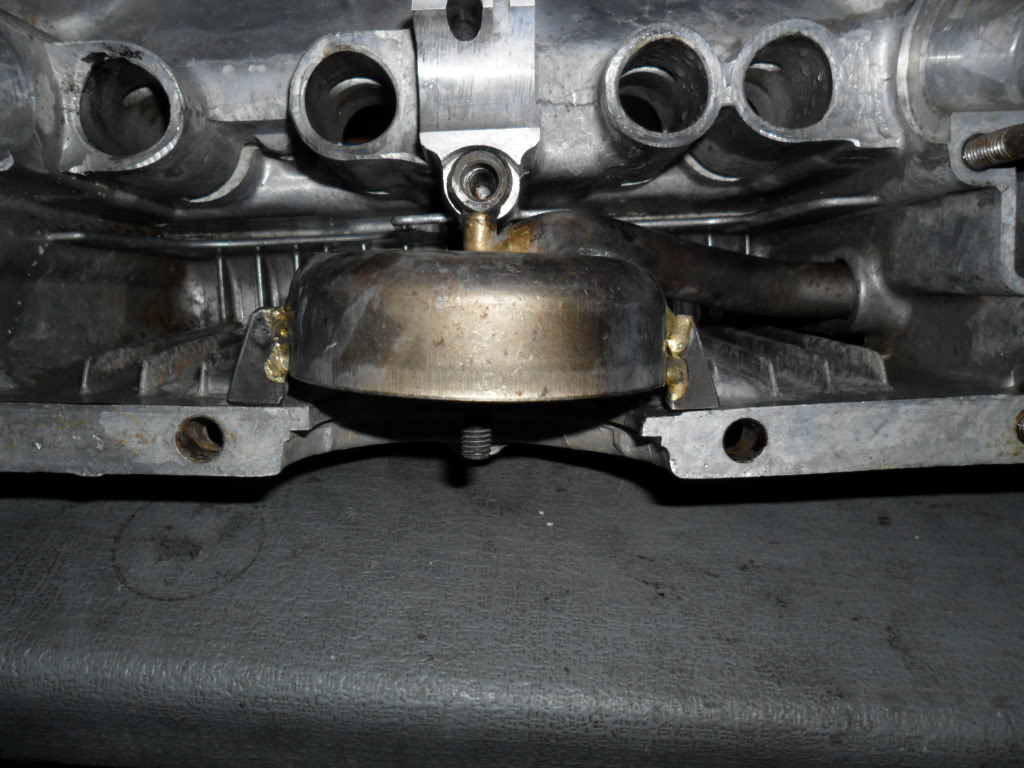

oil pump pick up modified for strength in a known weak spot

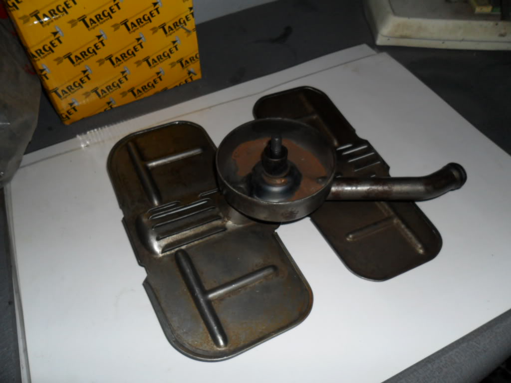

Windage trays came std on FI engines

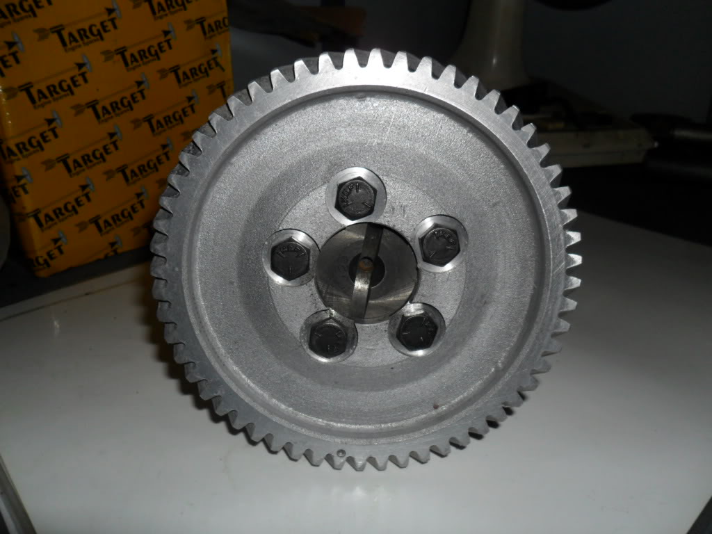

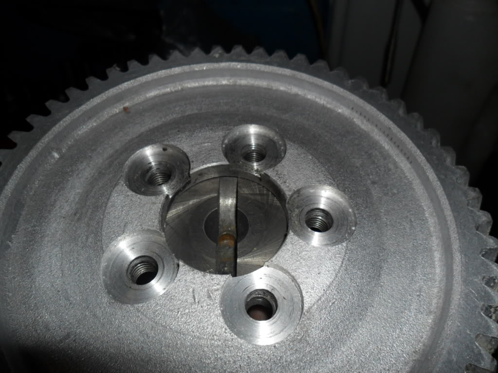

Scat cams come without gears so some mods are in order

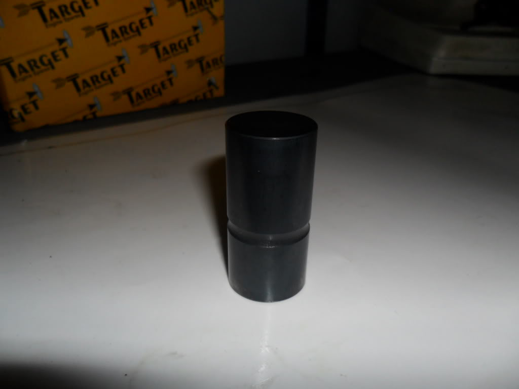

Lifters are reground and parkerised
in order to fit the Hd pump a spacer and some clearancing required

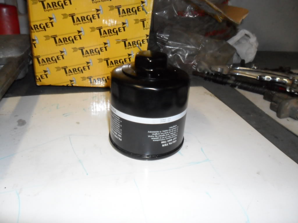

oil filter from a Polo works great

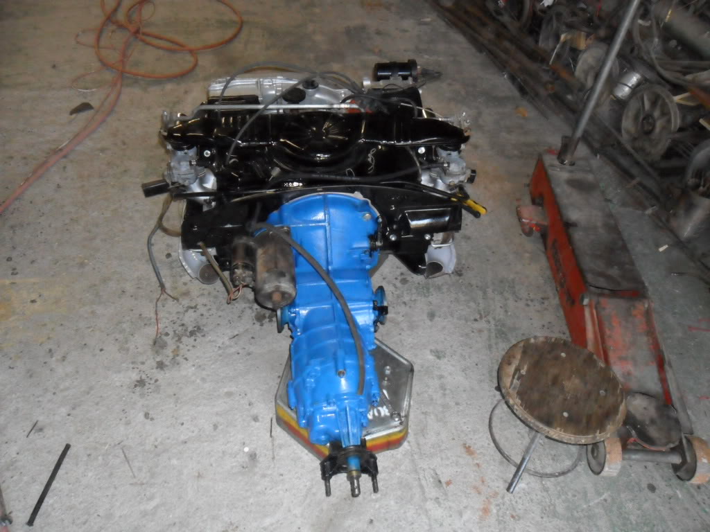

as this is a late IRS type three the stock fuel pump can stil work and engine and gearbox is fitted as one piece

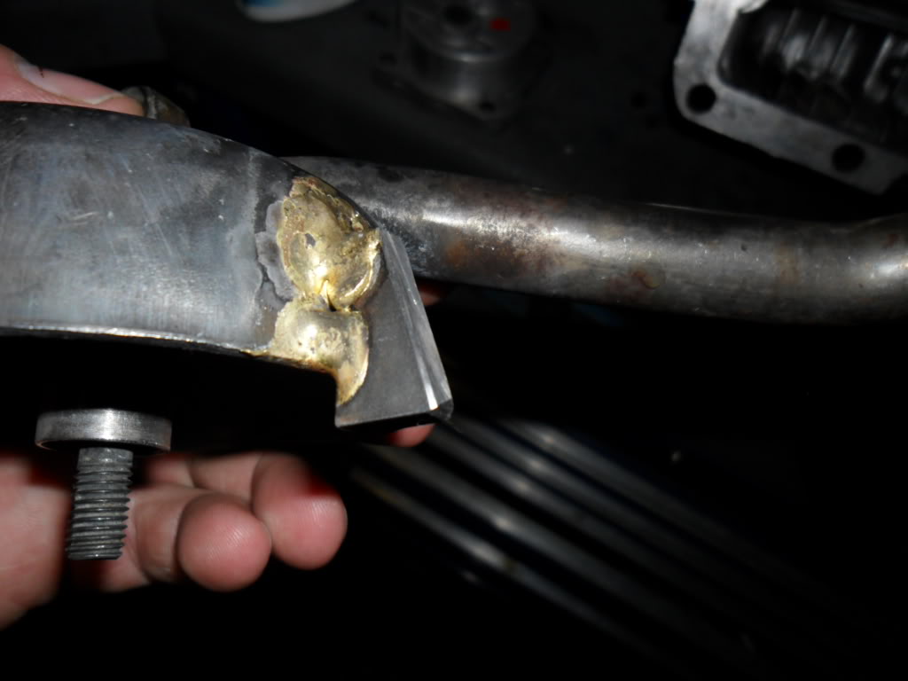

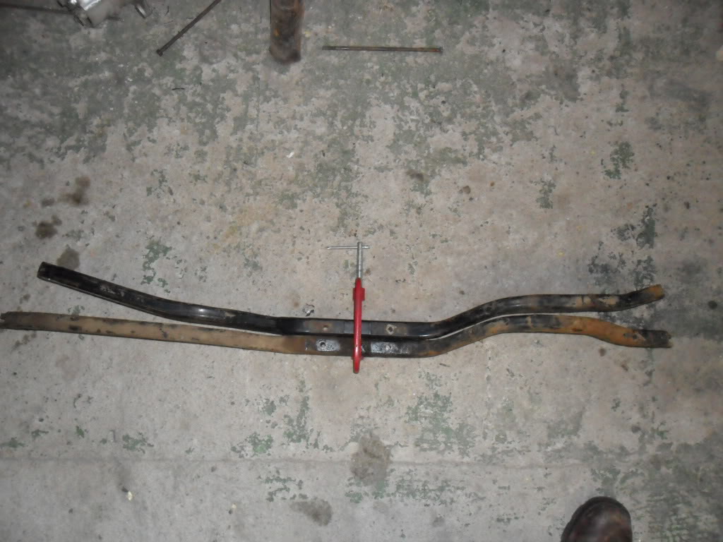

The bus cross member was also modified to mate with the type three body mounts as the engine is about 3cm longer

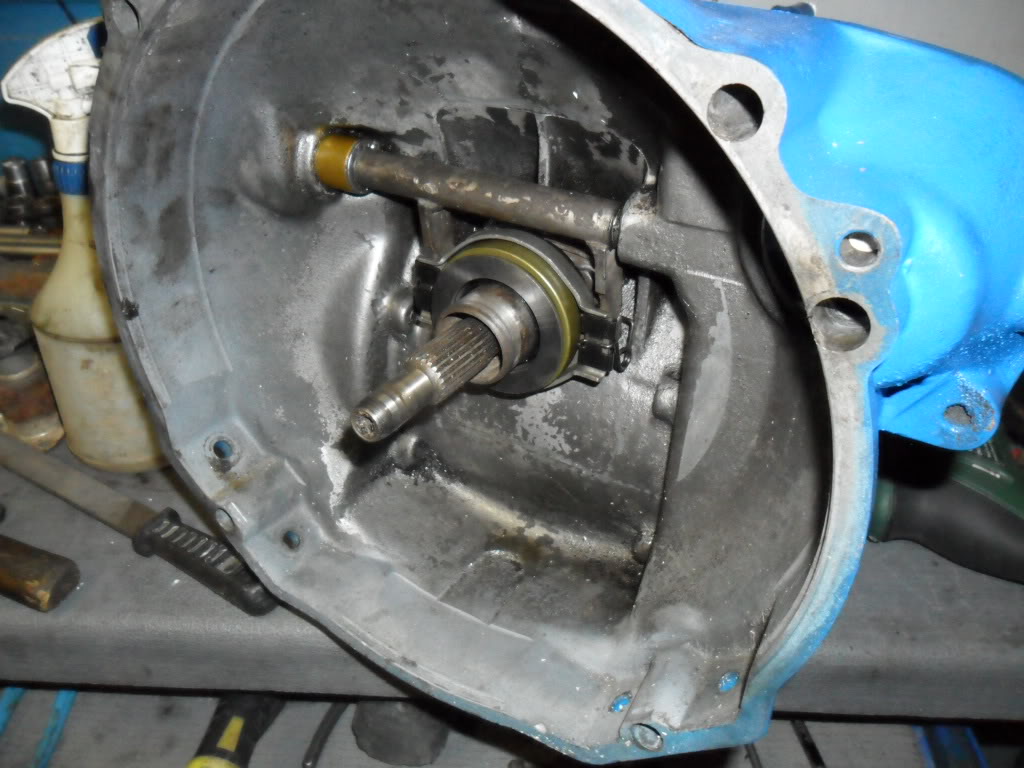

the gearbox recieved a guiide tube and later release bearing.

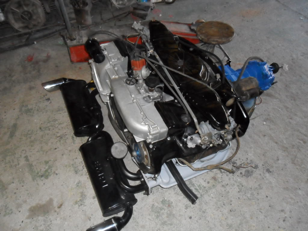

The engine is in and I am tidieng wiring etc cant wait to test though

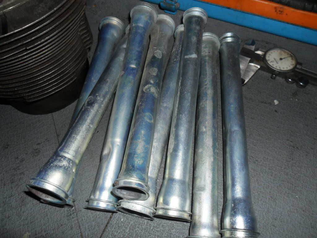

I also re galvanize the pushrod tubes
